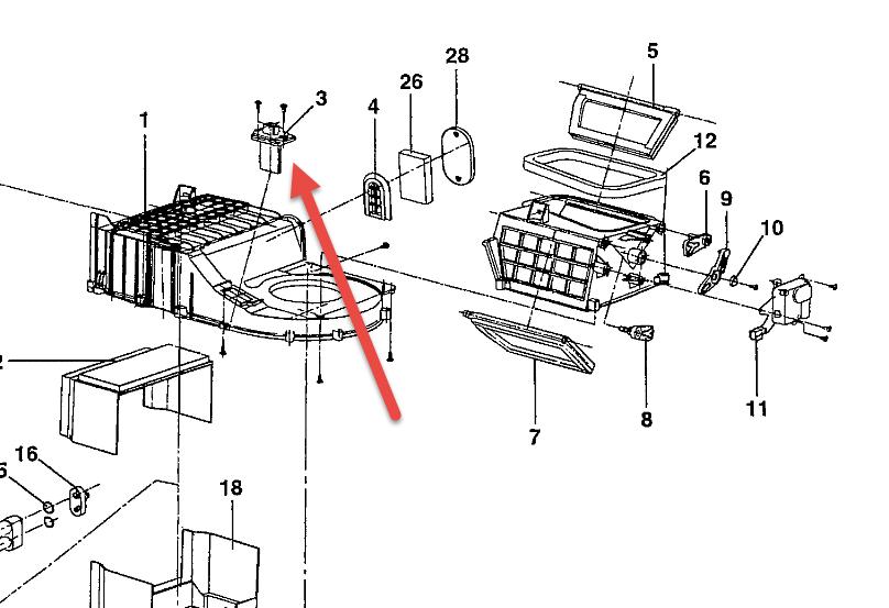

heater a/c fan only works on high speed
2005 HYUNDAI XG350
6 CYL • FWD • AUTOMATIC
FANSPEED
Fan only words on high not on low or medium speed
Jul 22, 2014 at 12:10 AM
HMAC300
  • 48,601 POSTS
check tosee if resistor is getting power if it is it's probably the resistor.
