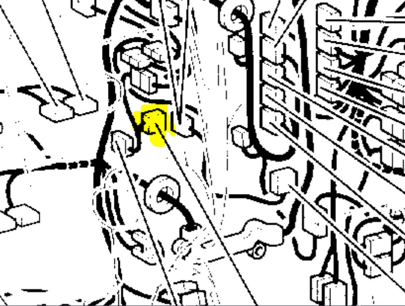

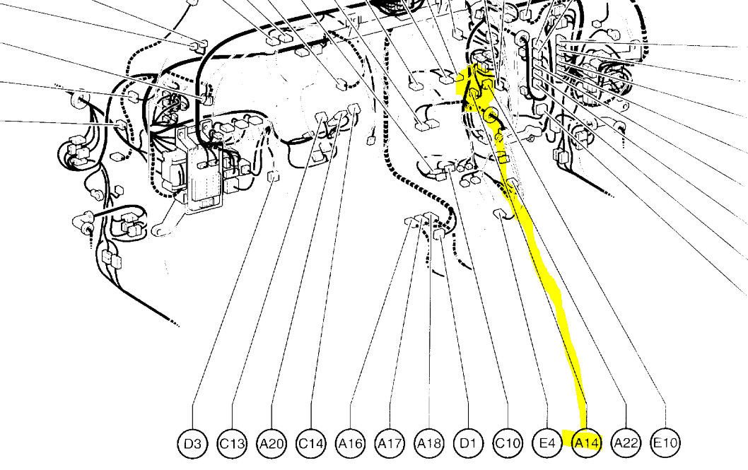

Blowing heat on driver's side but cold on passenger side.Thinks it's the air blender but do not know where it is located.
Jan 11, 2020 at 4:32 AM
  • 110,244 POSTS
I agree. It sounds like the blend air door actuator. First, here is a link that shows in general how one is replaced:
I attached a pic below to help locate the air temp servo (actuator).
Let me know if this helps.

Still little lost from the diagram. Found the recirculation servo and the one that changes what vent. Both are working. Is there a way to manually open the blend door?
Jan 11, 2020 at 8:06 PM
  • 110,244 POSTS
The only thing you could try is to remove the actuator and move the door. I enlarged the location hoping to make it easier to identify, but I think I made it worse. It is very close to center of the dash.
