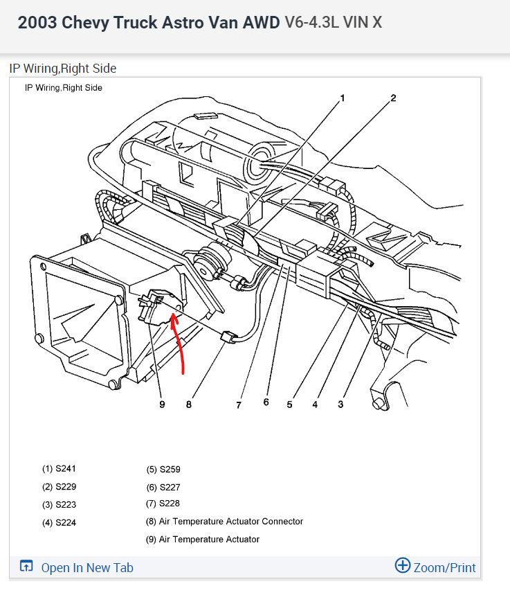

heater puts out warm air no hot air, with heater on warm air cold air 2 defroster vents do switch I I can switch climate control switch a little bit of change in warm air not very much. Heater hoses get hot in out heater core hoses get hot?
Aug 24, 2024 at 12:42 AM
  • 55,293 POSTS

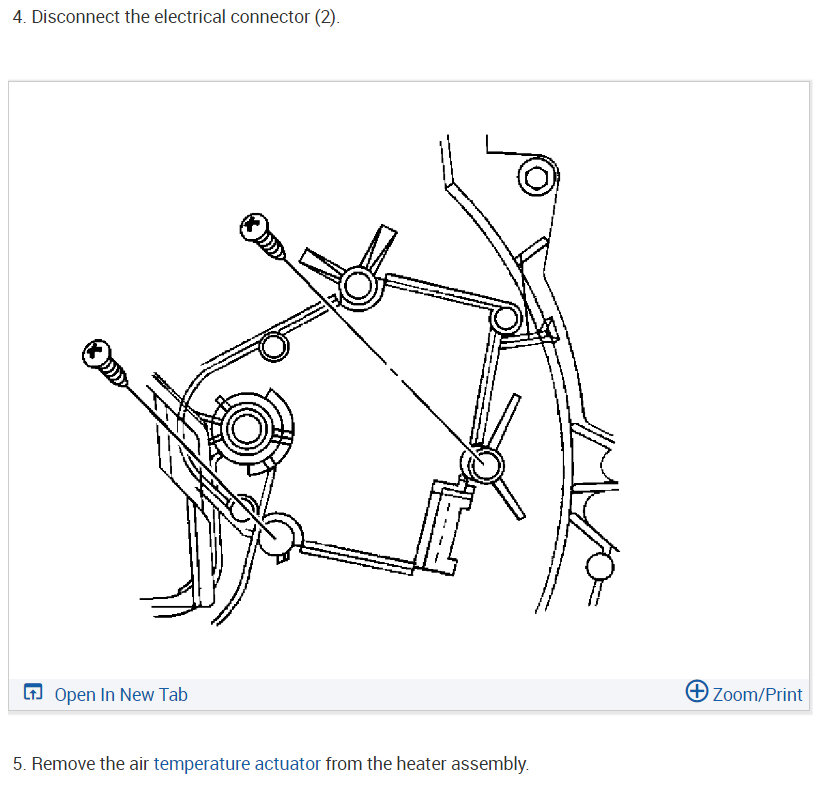

This can be one of two things either the heater core is partially clogged, which you can flush out using a garden hose, or the temperature blend door actuator is not closing all the way. Please go over this guide to help as well:
Here is the location of the temperature blend door actuator so you can remove it and work the blend door pivot by hand to see if it makes a difference, (HVAC system on) van engine warm.

took motor cover off actuator works turns c-wise and cc-wise flushed heater core little debris came out flushed until clear water, refilled core with anti-freeze got a lot more heat? can a little debris make that much difference?
Aug 28, 2024 at 9:43 PM
  • 55,293 POSTS
Oh yes, you would not think it would, but a clogged heater core is a common problem. I would flush the core in both directions for optimal performance.
