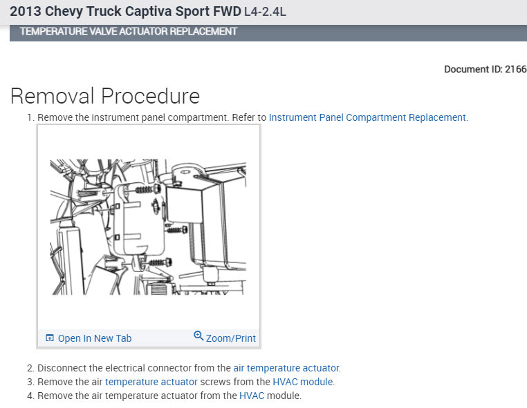

I started hearing a clicking noise coming from the dashboard and then my heater stopped working.
Feb 1, 2022 at 1:56 PM
SQM
  • 6,383 POSTS
The clicking noise could be from the blend door actuator.
The blend door actuator is what controls the hot and cool air flow/mix.
The actuator can get stuck on the hot or the cool side and create no heat or no A/C.
Clicking noise is when it is trying to work but unable to switch over.

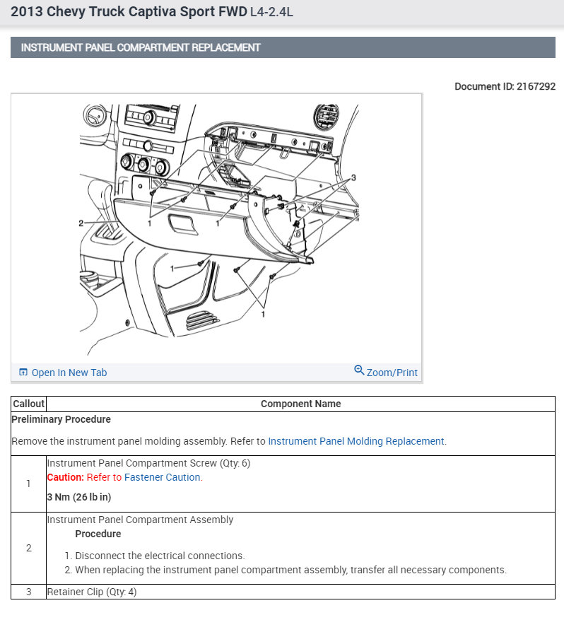

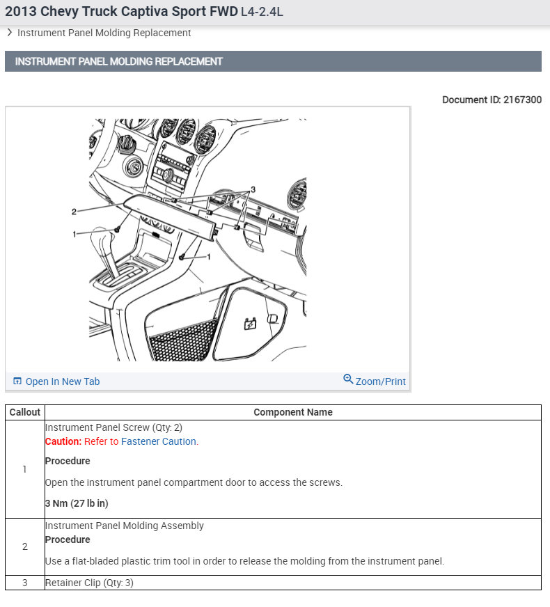

The blend door actuator is located behind the passenger side instrument panel.

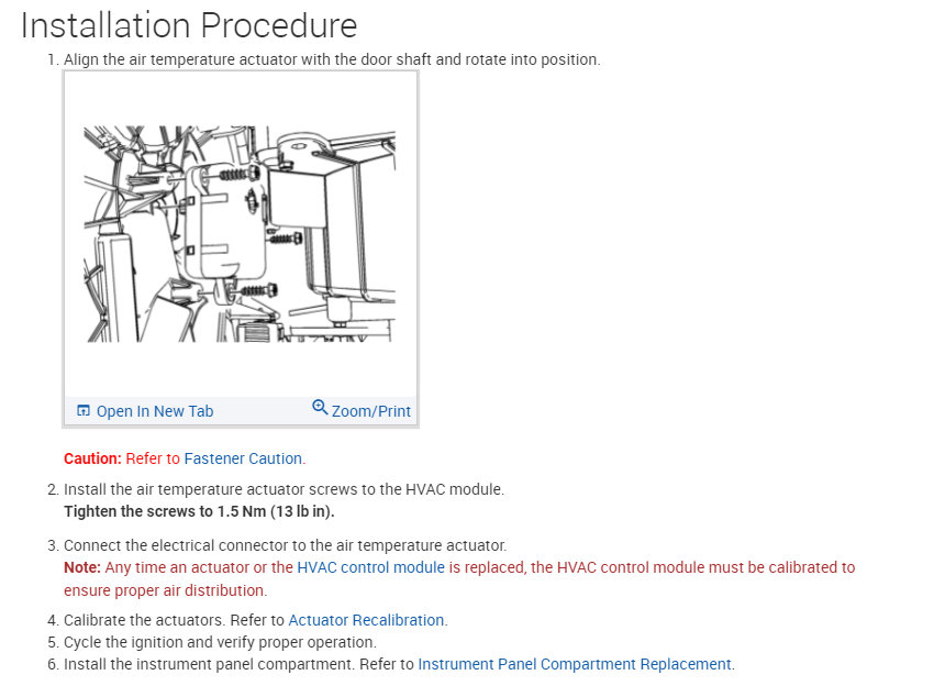

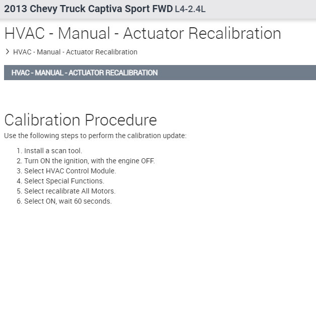

Keep in mind that if the actuator gets replaced, the new one will need to be programmed to the vehicle. Which will need a scan tool.

I keep having trouble with my blend door actuator going out for whatever reason this is the second one that has been put in. thank you for getting back to me that's what I was thinking it was.
Feb 1, 2022 at 3:20 PM
SQM
  • 6,383 POSTS
It is somewhat of a common issue with these vehicles. Could be the design of the actuator along with amount of force it is required for it to move the blend door.
