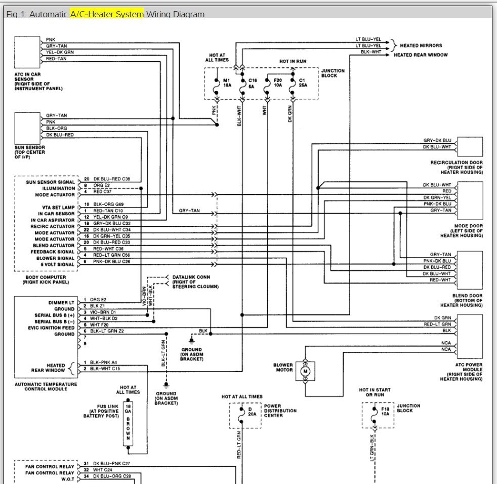

Automatic temperature control does not work. fuse and relay is good, put in new thermostat.

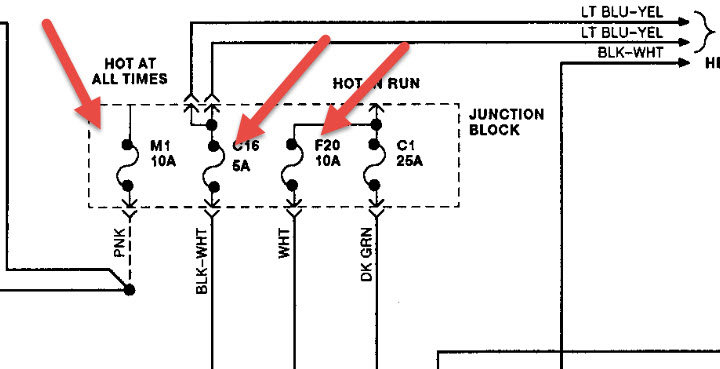

this will need to be scanned for codes to see what Is wrong with it. check fuses in picture.
Jan 2, 2017 at 4:03 AM
  • 55,433 POSTS
FROM BOB B
I looked at the fuses they all look good if it is the control head how
would i check it ?
Jan 4, 2017 at 1:28 AM

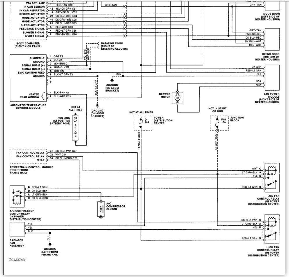

Hey Bob,
You must check the power and ground input and outputs of the system, here is a complete wiring diagram that will show you how to test the controller and the wiring.
Here is a guide and diagram.
Please run some tests and get back to us so we can continue helping you.
Best, Ken

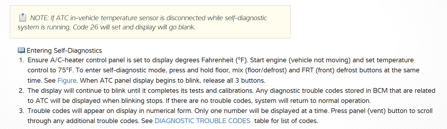

I put a new automatic temperature control head in now it lights up ran a diagnostic test and no codes came up but still no heat

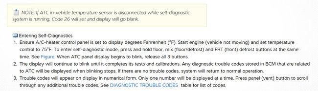

check to see if blend door is getting power but it may be a sensor that is screwing up that is why you need to get it scanned for codes.

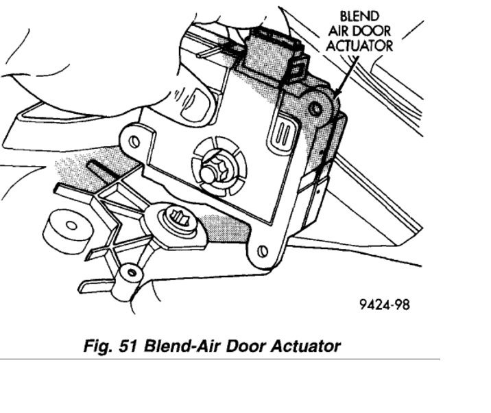

How do i change the blend door unit
Jan 9, 2017 at 2:34 AM
HMAC300
  • 48,601 POSTS

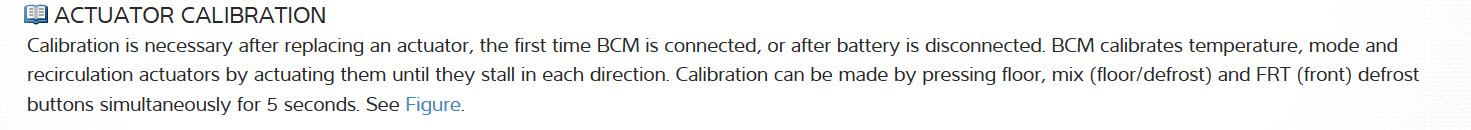

sorry I gave you the wrong instructions for resetting actuator see pic also covers getting codes if not the actuators
Jan 9, 2017 at 4:04 AM
HMAC300
  • 48,601 POSTS
for somereason I can't add images to say what to do
Jan 9, 2017 at 4:06 AM
HMAC300
  • 48,601 POSTS
ok now have pics

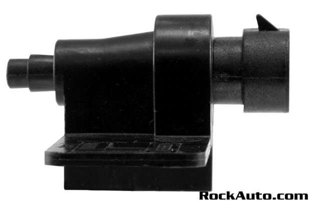

can you show me what a in car ambient temperature sensor looks like please which is behind the right bezel thank you.
Jan 9, 2017 at 6:53 AM
HMAC300
  • 48,601 POSTS
see pic it's a two wire connector

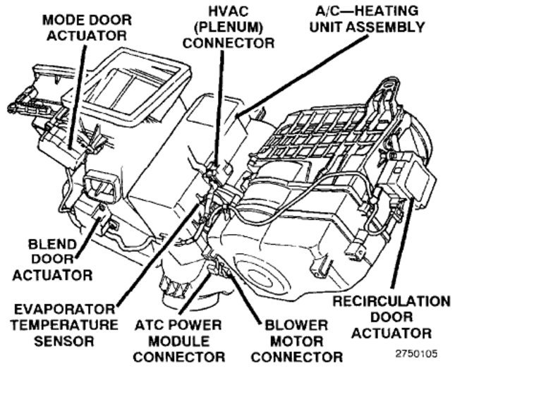

  • 55,433 POSTS
Hey Bob,
I found these images for you to show you where the blend door actuators are.
Please let us know happens so it will help others.
Best, Ken
Jan 9, 2017 at 7:53 AM

do you know where i can find a in-car temp sensor
Jan 14, 2017 at 7:03 AM
  • 55,433 POSTS
IN-VEHICLE TEMPERATURE SENSOR
Removal & Installation
Remove right side instrument panel trim end cap and trim bezel from instrument panel. Remove sensor screws, pull out sensor, and disconnect wiring. To install, reverse removal procedure.
Jan 14, 2017 at 1:38 PM
