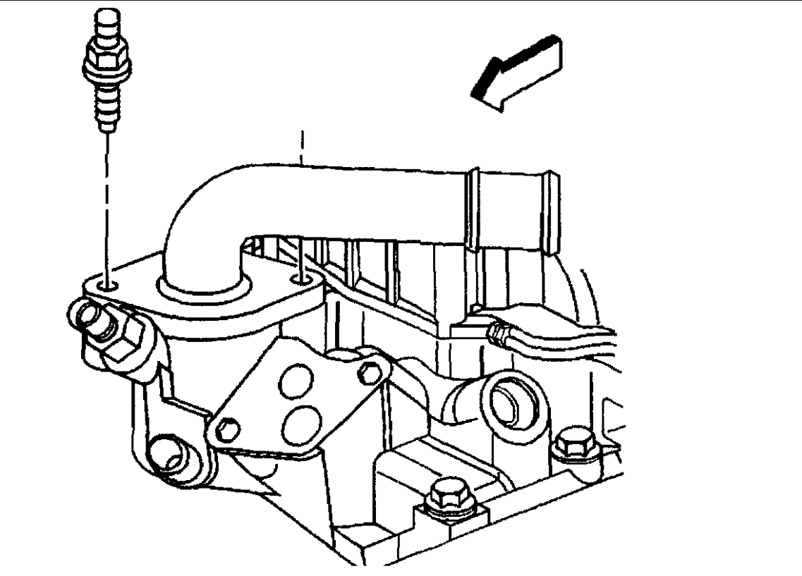

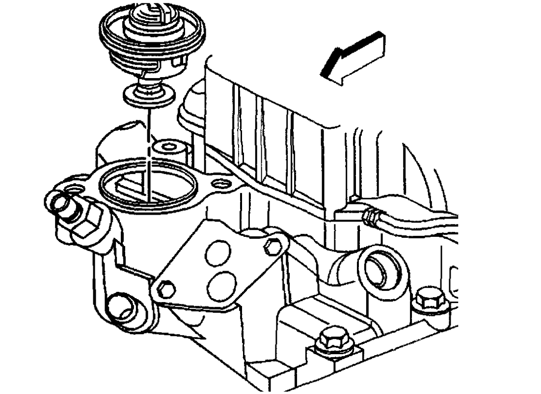

If the thermostat is stuck open, it will not give you heat.

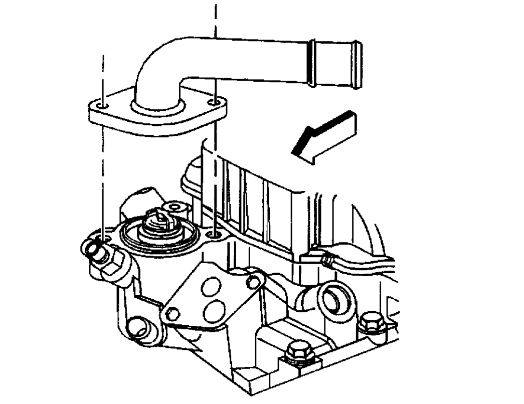

Thermostat Replacement
Removal Procedure
1. Partially drain the cooling system.
2. Remove the air cleaner outlet duct.

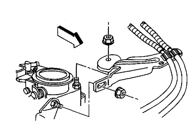

3. Remove the throttle body bracket nuts and reposition the bracket.
4. Remove the water outlet housing mounting bolts.
5. Remove the water outlet housing from the lower intake manifold and set aside.
6. Remove the gasket or O-ring.
7. Remove the thermostat.
8. Clean all the sealing surfaces of the water outlet housing.
9. Clean the sealing surface on the lower intake manifold.

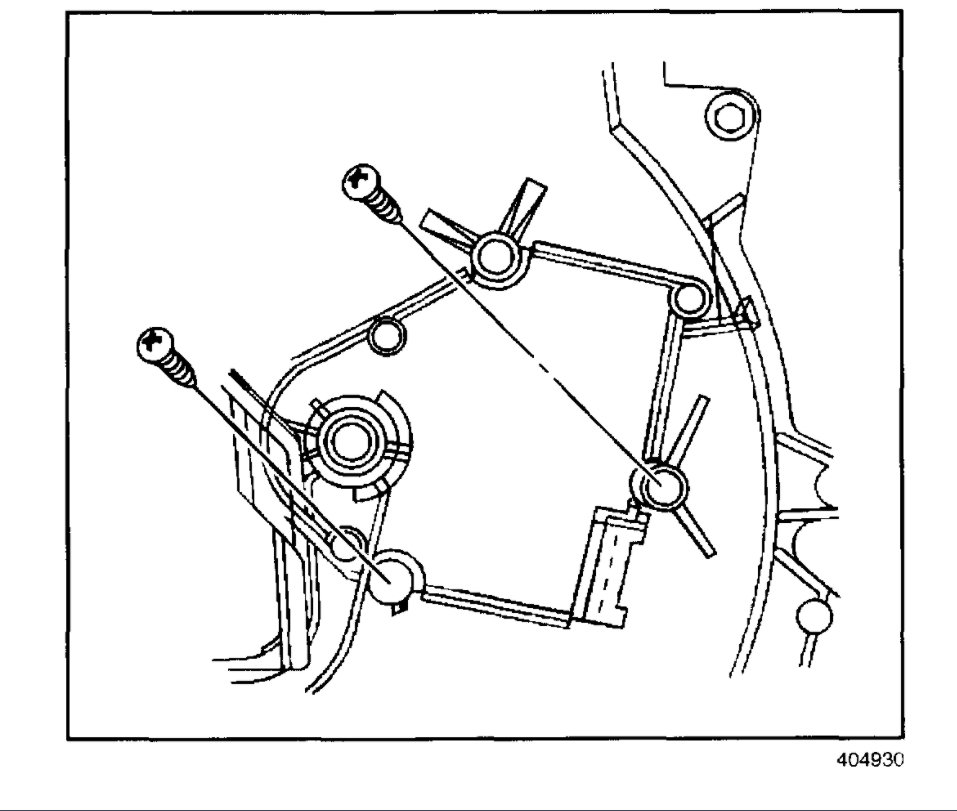

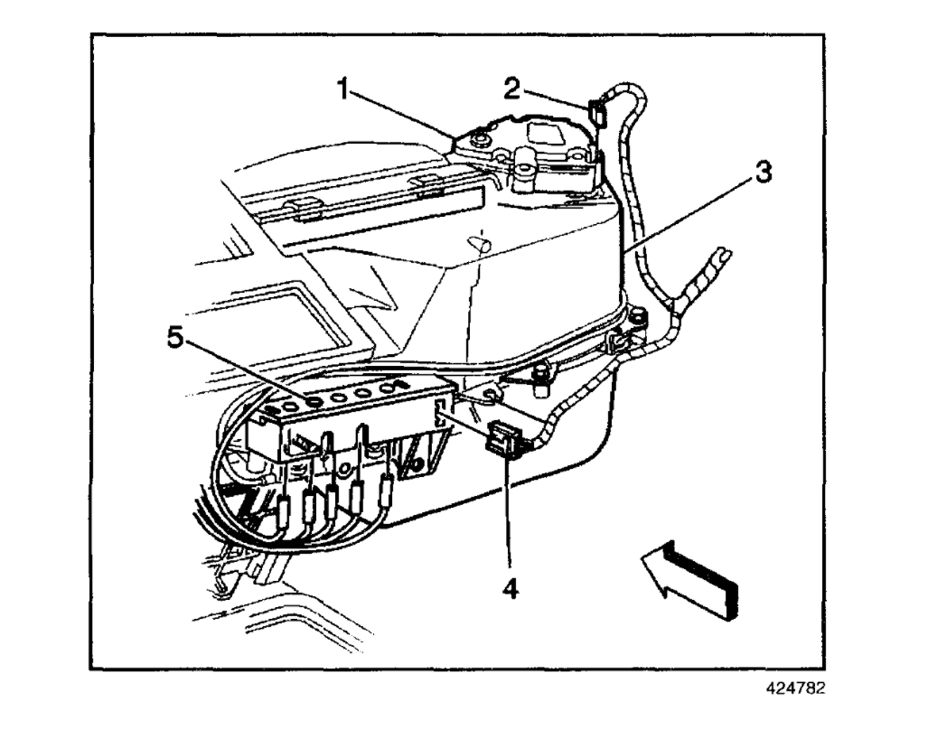

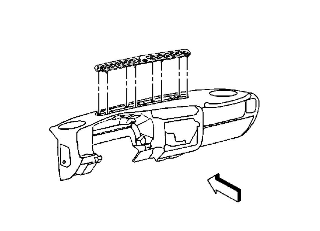

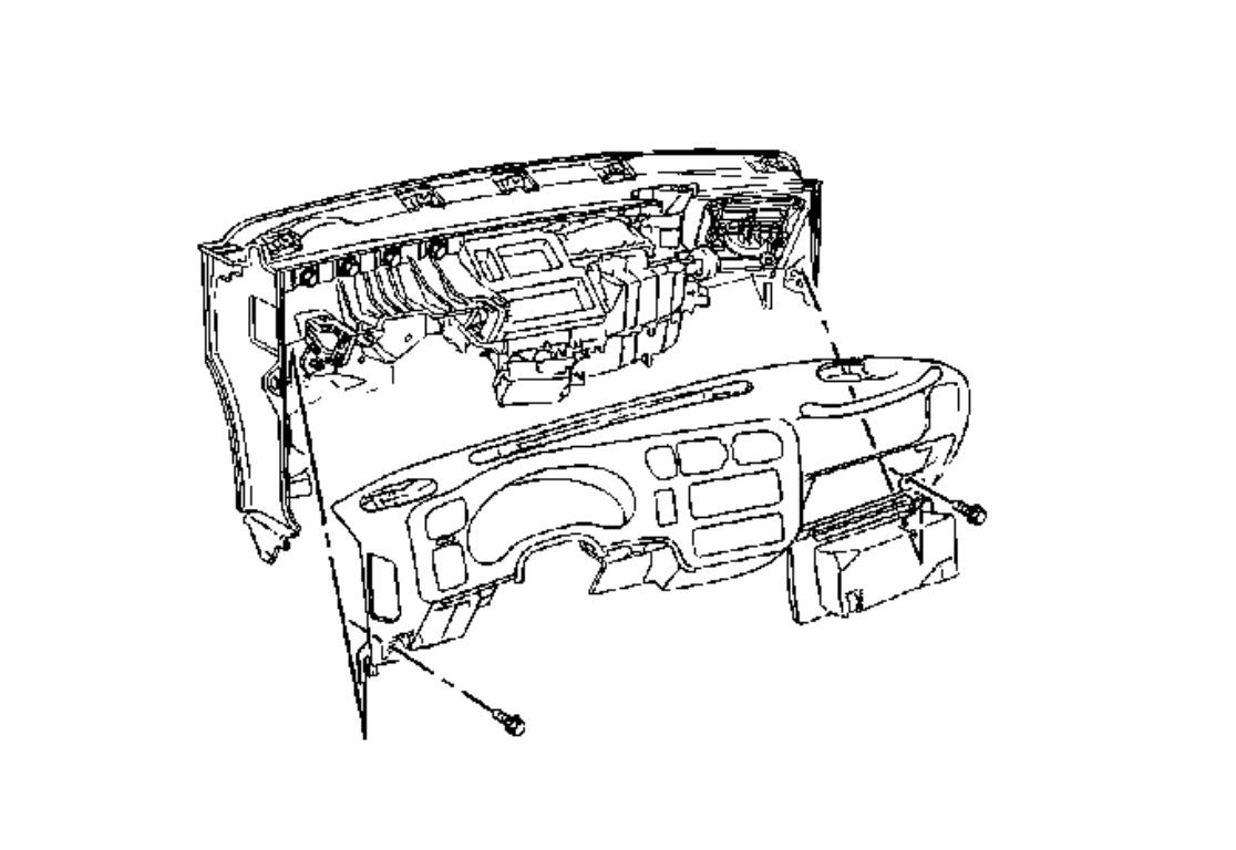

The air temperature actuator is located on the top right hand side of the HVAC module.
1. Remove the instrument panel carrier.
2. Disconnect the electrical connector (2).
3. Remove the air temperature actuator retaining screws.
4. Remove the air temperature actuator from the HVAC module.
IP Carrier Replacement
Removal Procedure

13. Use a flat-bladed tool to remove the windshield defroster grille. Retain the windshield defroster grille for use on the replacement IP carrier.
14. If the vehicle is equipped with a sunload sensor, twist the sunload sensor 1/4 turn counterclockwise in order to detach it from the windshield defroster grille. Retain the sunload sensor for use on the replacement IP carrier.

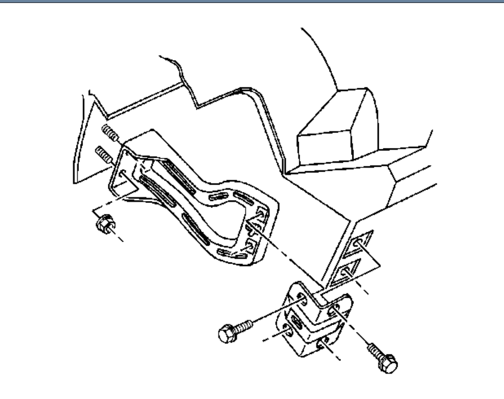

21. Remove the left and right instrument panel driver knee bolster brackets.

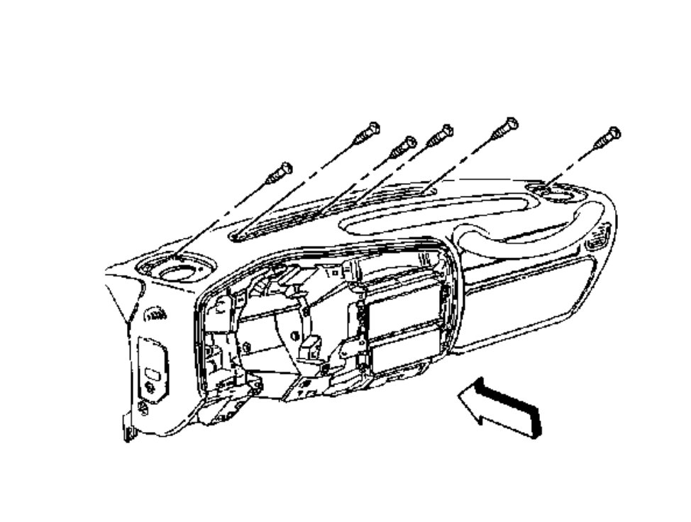

23. Remove the top instrument panel screws.
24. Roll the instrument panel down.
25. Disconnect the electrical connections, as needed.
26. Remove the fastener that retains the radio antenna cable to the instrument panel.
27. Remove the instrument panel from the vehicle.
