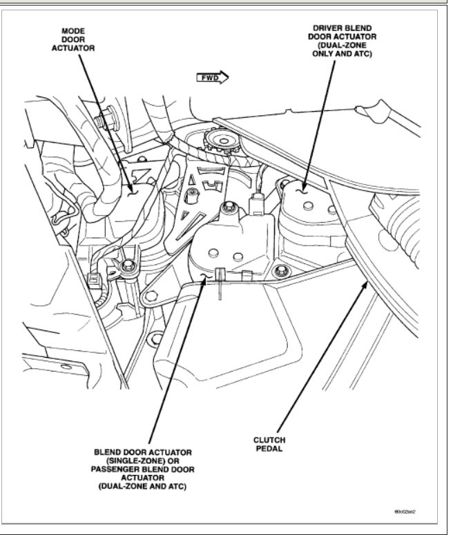

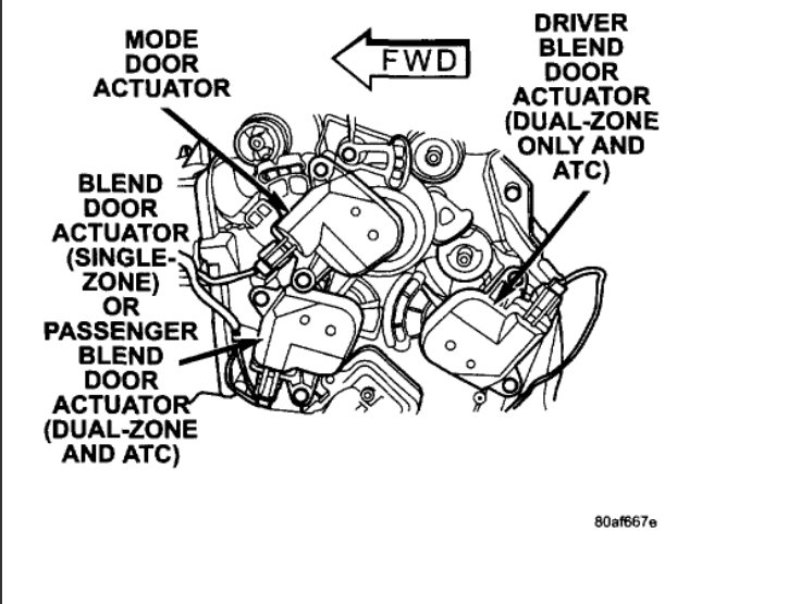

Hello, the heater temperature control does not work. The A/C temperature control does work. and is dual zone. Both lines coming into heater core are nice and warm. Does this sound like an actuator problem or something else? Rear heater and A/C temperature controls work okay.
Dec 7, 2017 at 9:15 PM
  • 55,427 POSTS
This does sound like the temperature blend door actuator need to be replaced.
Here is a guide that will give you an idea of what you are in for when doing the job:
This guide may help as well.

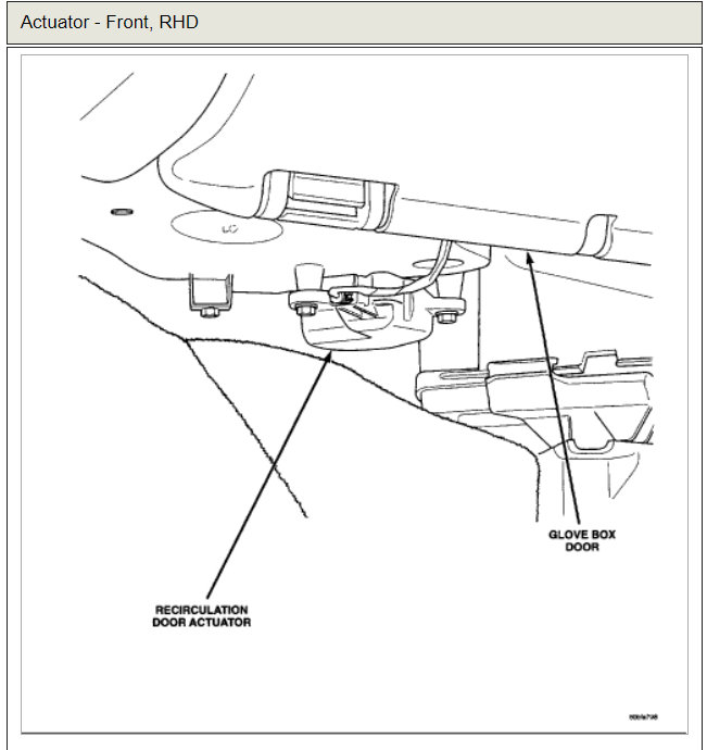

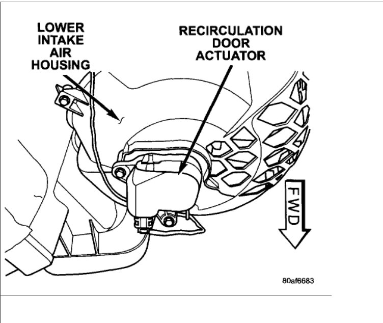

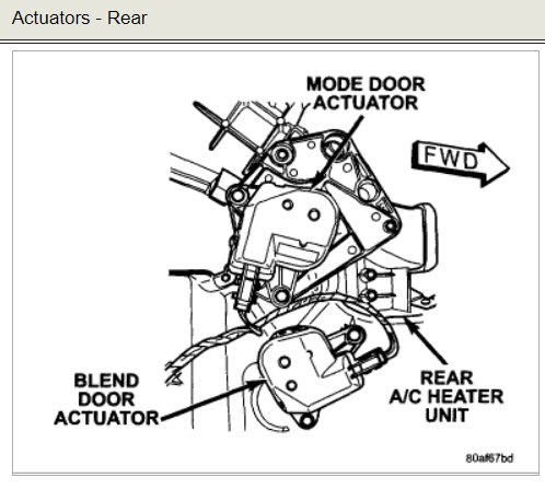

Below is the location for your car. Check out the diagrams.
