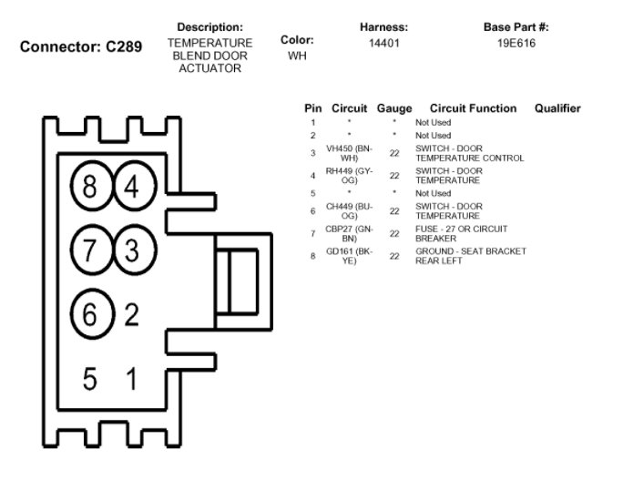

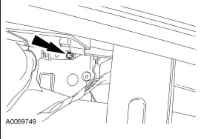

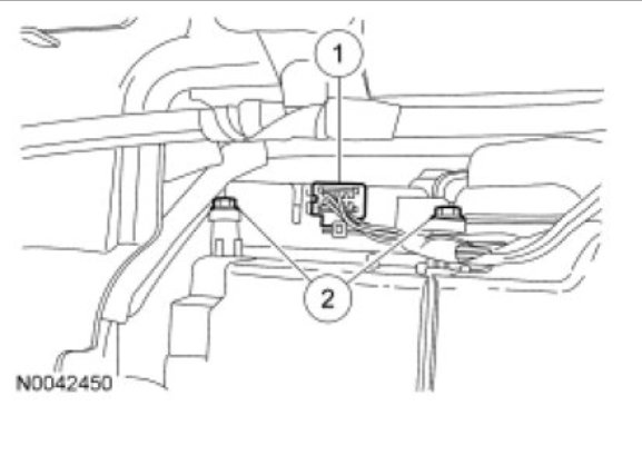

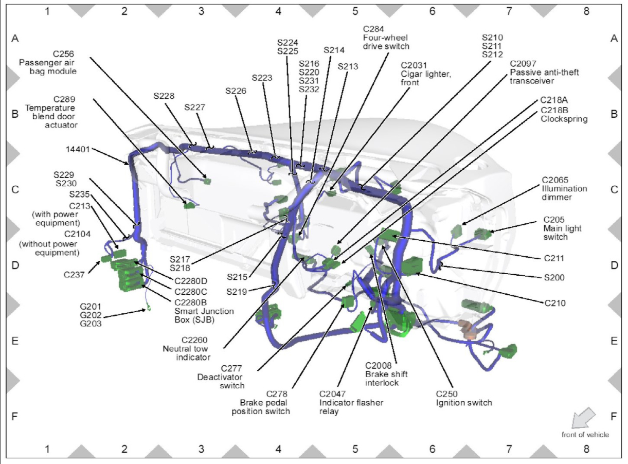

It sounds like you have a blend door actuator that has gone bad for the temperature. Here is a guide that gives you an idea of what you are in for when doing the job.
and
Here are diagrams of what it like on your car. (below)

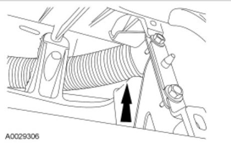

Is the next logical step to flush the heater core? I noticed that one of the hoses from the heater core is very hot, but the other one is not nearly as hot. Is that a sure sign the heater core is clogged?

Additional info:
i can see all the components behind the glovebox working; specifically, when i turn the temperature control knob, i can see the blend door hinge moving. so i don't think it's that.
Dec 28, 2020 at 4:43 AM (Merged)

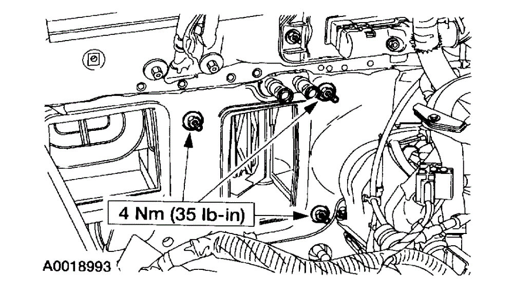

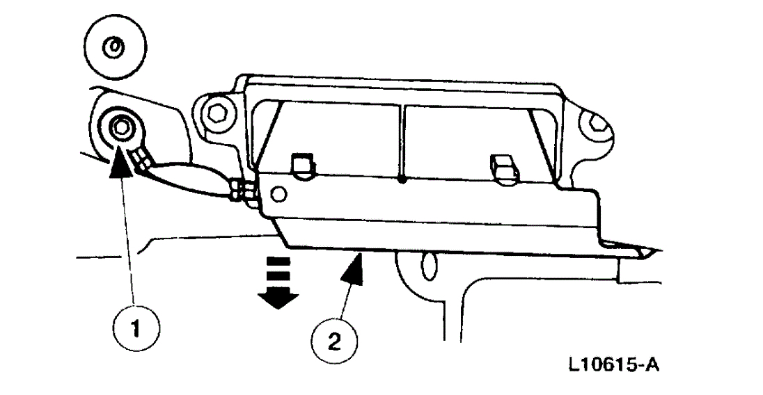

Good afternoon,

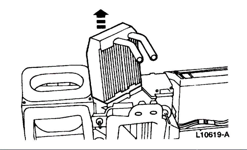

Yes, I would flush the heater core.
Remove both hoses and use a garden hose to flush the core. Run it back and forth through the core until you get a good clean even flow. Then hook the hoses back up and see if you have heat.
If not, then the core will have to be replaced.

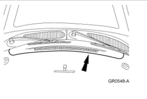

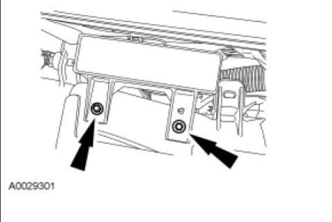

REMOVAL
1. Remove the evaporator core housing.
NOTE: If a heater core leak is suspected, the heater core must be leak tested before it is removed from the vehicle.
2. Remove the instrument panel. Refer to: Body and Frame, Interior Trim, Dashboard/Instrument Panel, Service and Repair, See: Dashboard / Instrument Panel > Procedures > Removal and Installation
3. Remove the Powertrain Control Module (PCM).
4. Remove the PCM heat sink.
1 Remove the ground strap screw.
2 Remove the heat sink.
5. Remove the four nuts from the engine side of the dash panel. Position the plenum chamber on the vehicle floor.
6. Remove the heater core cover.
1 Remove the screws.
2 Remove the heater core cover.
7. Remove the heater core.
INSTALLATION
1. To install, reverse the removal procedure.
During installation, be sure to install a new oval foam seal around the heater core inlet and outlet tubes.

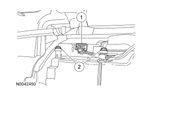

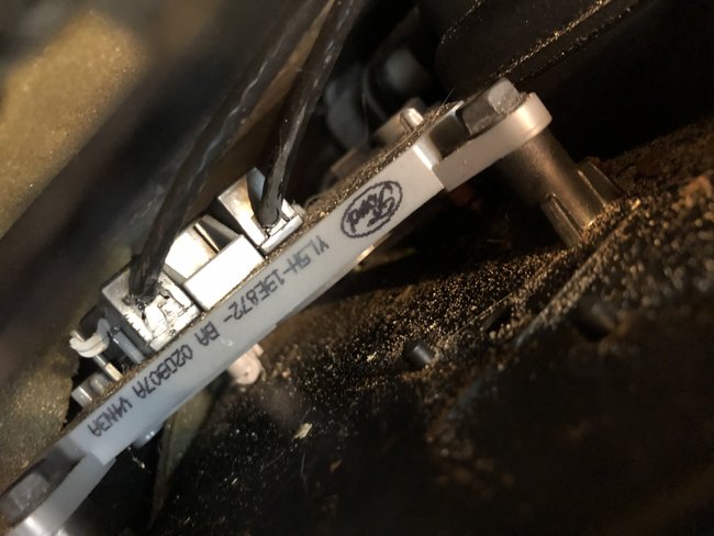

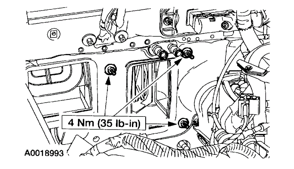

CSOSA123456
  • 31 POSTS
Hi Roy,
I flushed the coolant from the heater core, switched the lines on the core, and i’m still not getting any heat in the cab.
Two questions:

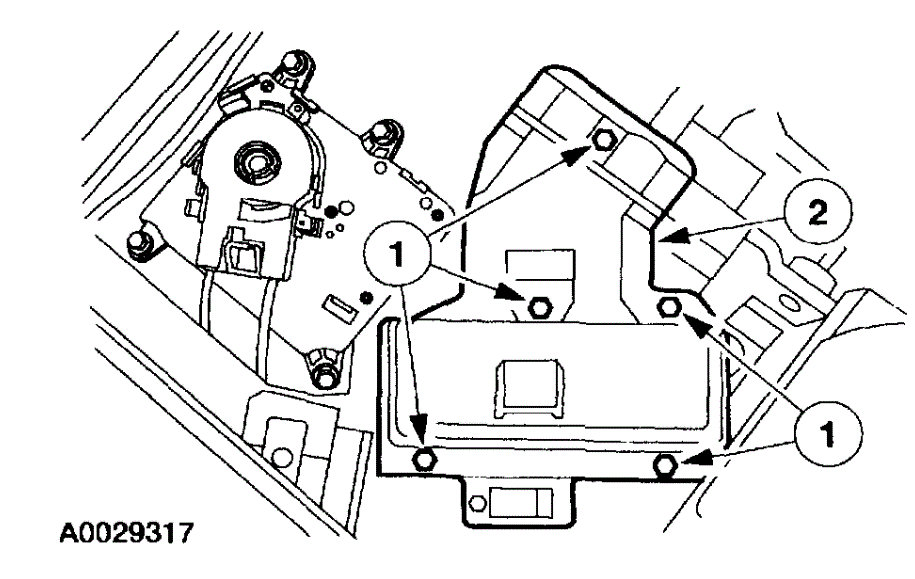

1) Does the blend door actuator look correct to you? it looks quite different than the ones i see online.

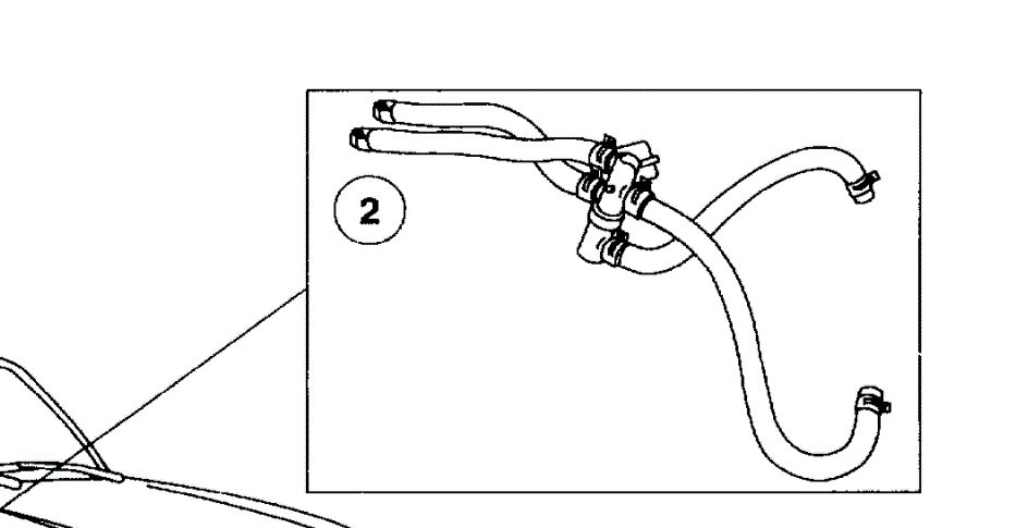

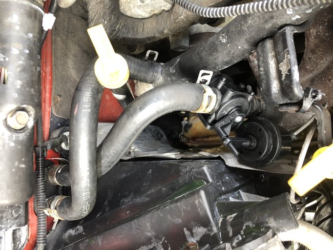

2) Is there a bypass valve or something similar in the heater core? i can see the coolant system working fine, so it likely is that the heater core is not working.
The second picture shows a control valve. Try moving the arm manually and see if the hose gets hot and you get heat.
The blend door look right and also new.
CSOSA123456
  • 31 POSTS
Hi Roy,
i actually installed the heater control valve you see in the photo above; i guess the previous owner bypassed it and installed a t-connector in place of the valve. the valve works fine, it will open and close when max A/C is toggled.
i will muster the courage to replace the heater core, in that case. i live in Florida so heat is not a huge necessity; how severe would you say a non-leaking bad heater core is?
