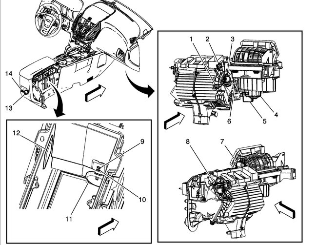

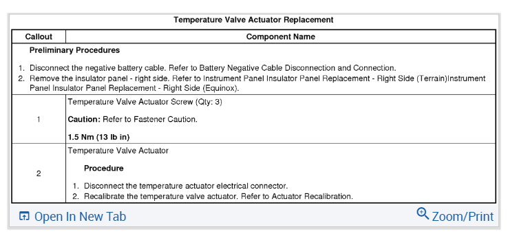

I turn the knob to cold temperatures and turn on my A/C for a few seconds then I turn it back to heat and it blows hot air. This just started this morning it has been great up until today
Dec 1, 2020 at 6:24 AM
  • 110,244 POSTS

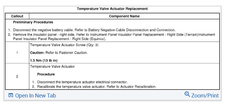

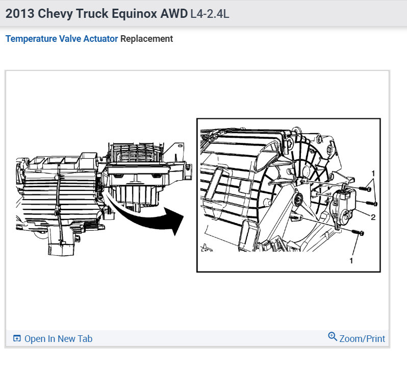

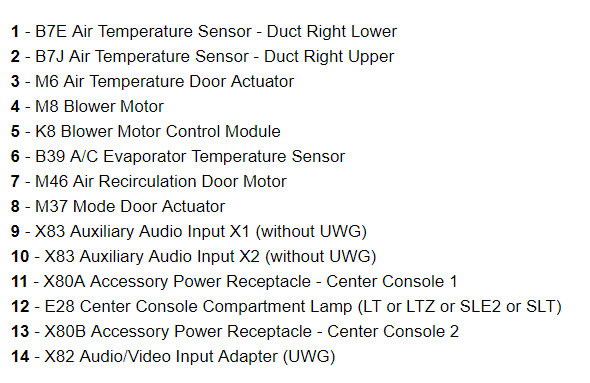

Based on your description, it sounds like the blend air door actuator is going bad. The blend air door is what controls the air temp entering the vehicle. What I would suggest is to remove the actuator and then see if it moves when you change the temperature.

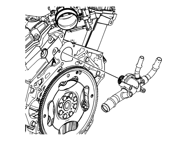

This actuator is located under the hood on the HVAC box. Here is a link that you may find informational. It explains in general how one is replaced. This will give you an idea of what you are looking for.

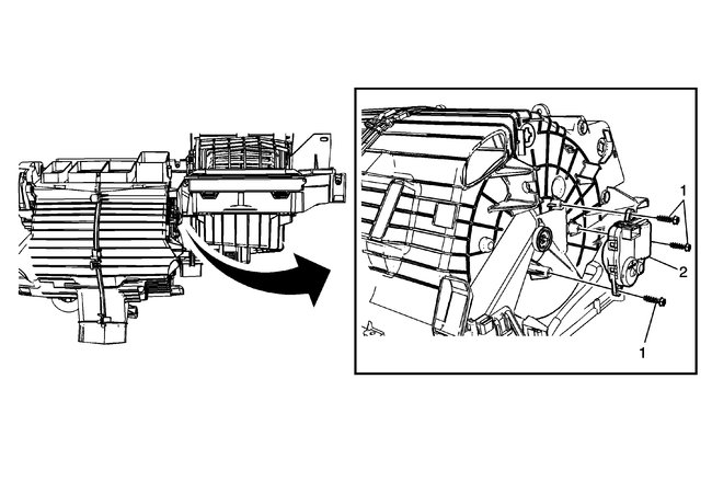

If you determine it is bad, here are the directions specific to your vehicle for replacement. The attached pics correlate with the directions.
___________________________________________
First, pic 1 shows the location on your vehicle.
Here are the directions.
2014 Chevy Truck Equinox FWD L4-2.4L
Temperature Valve Actuator Replacement
Vehicle Heating and Air Conditioning Air Door Actuator / Motor Service and Repair Removal and Replacement HVAC - Manual Temperature Valve Actuator Replacement
TEMPERATURE VALVE ACTUATOR REPLACEMENT

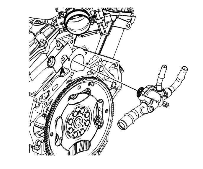

see pic 2

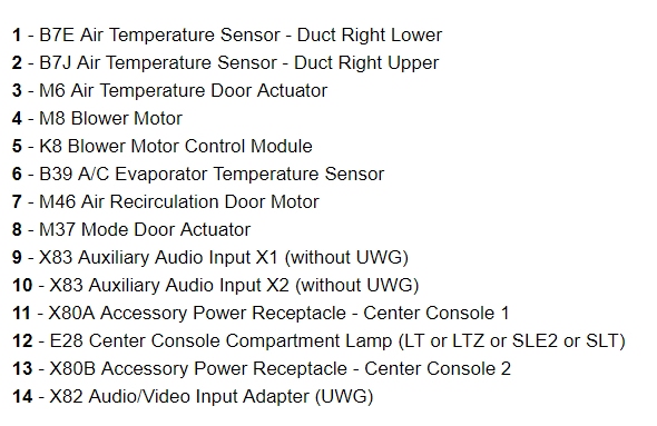

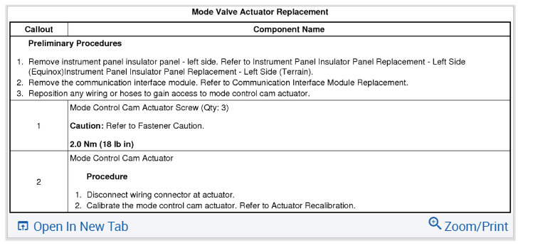

see pic 3
Let me know if this helps.

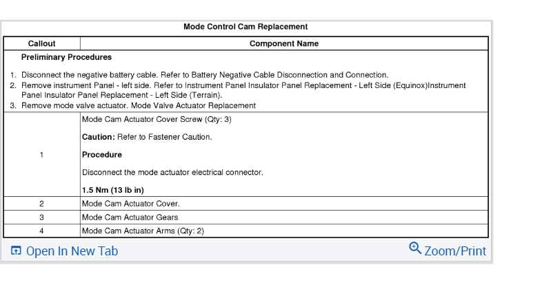

My heat was working fine. After work I noticed it was blowing warm air in the upper vent and cold in lower. The vents that are around my feet and knees was cold. I tried every button and even the air and it did not change this. What the heck??
Thanks
Dec 29, 2020 at 3:22 AM (Merged)
JIS001
  • 3,412 POSTS
For this concern you will need an advance scan tool to try and re-calibrate all the servos. That is the first step. If it does not calibrate then a fault code will set for the faulty servo. What you can try and it may or may not work is disconnecting the battery for 15 minutes. Reconnect the battery and turn the ignition switch on with out cranking the engine over for one minute. It may just do a self calibration on its own. Let us know if that resolves the issue. If it does not then you will need a professional shop to do the calibration with the scan tool.

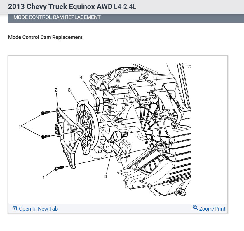

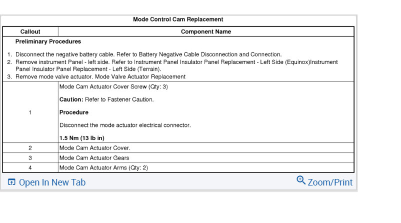

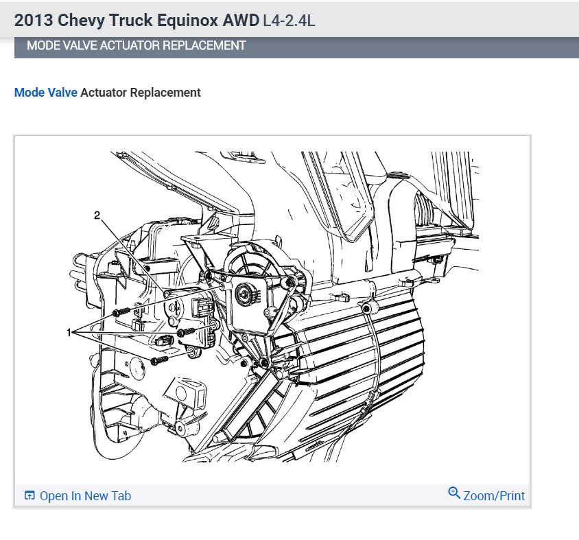

It sounds like the mode actuator is out. here is a guide to help you see what's going on and instructions to change the actuator in the diagrams below for your car:

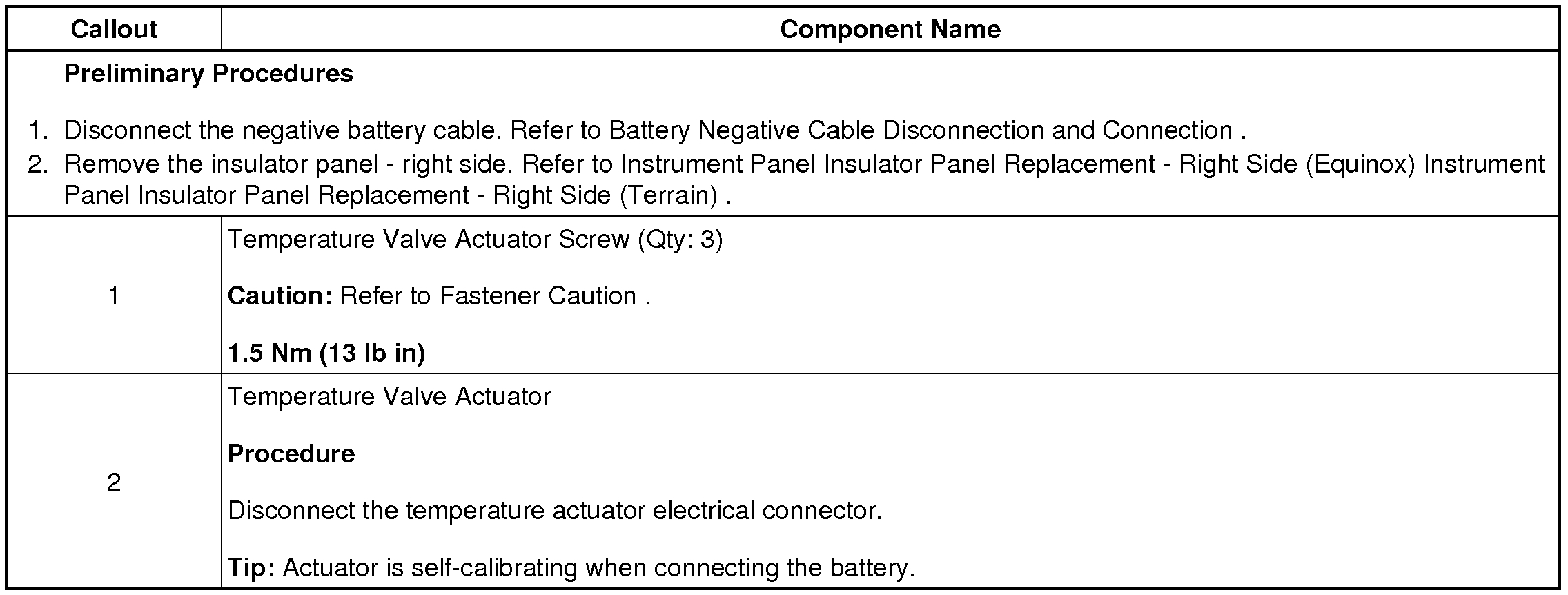

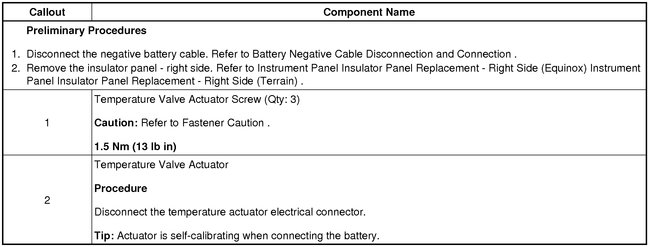

Here are the directions specific to your vehicle. The attached pics correlate with the directions.
___________________________________________________
2010 Chevy Truck Equinox FWD L4-2.4L
see pic 1

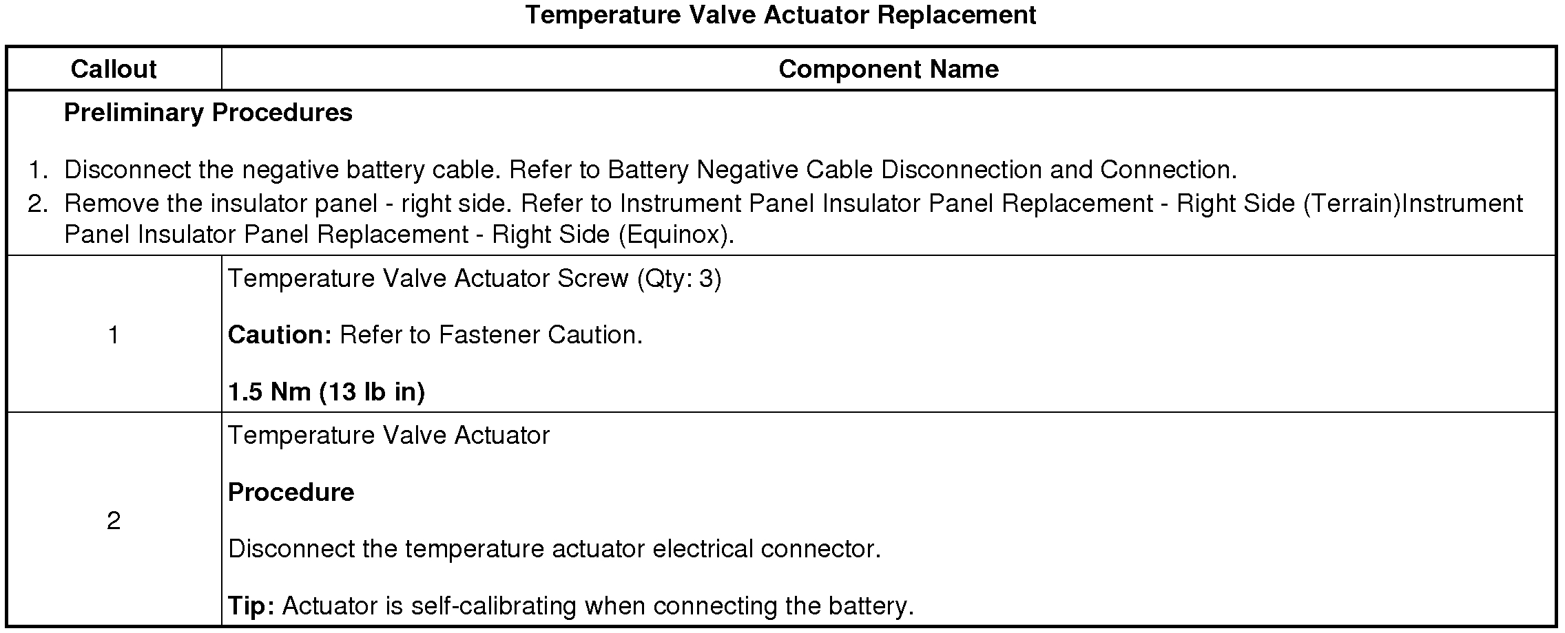

see pic 2

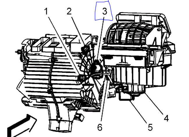

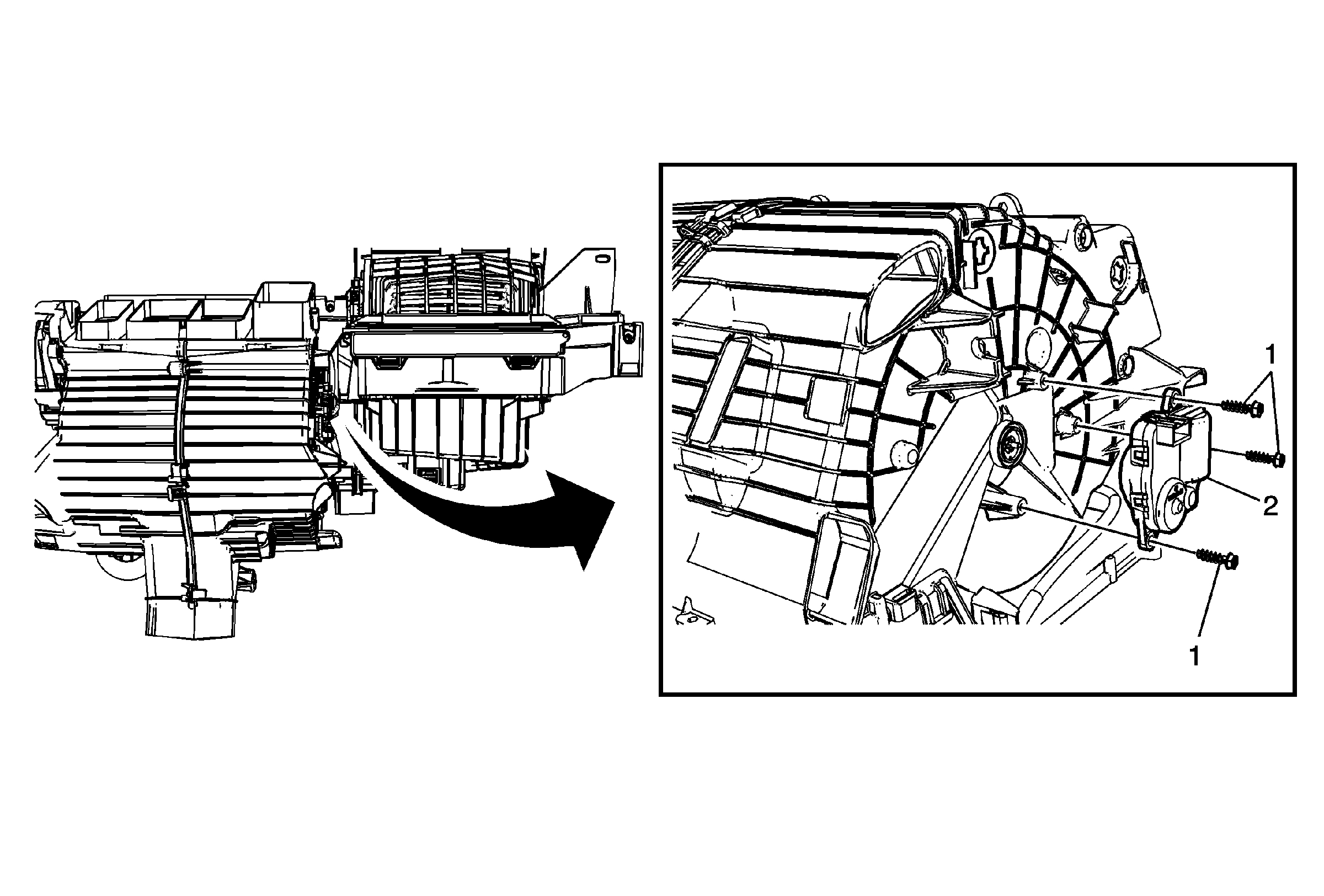

This sounds like you have a temperature blend door actuator what is out and needs t be replaced. This guide will give you an idea of what you are in for when doing the job.
Also check the engine coolant level as well becasue if it is low the heater is the first thing to stop working.
Here is how it will be on your car (below) which show the blend door actuators locations.

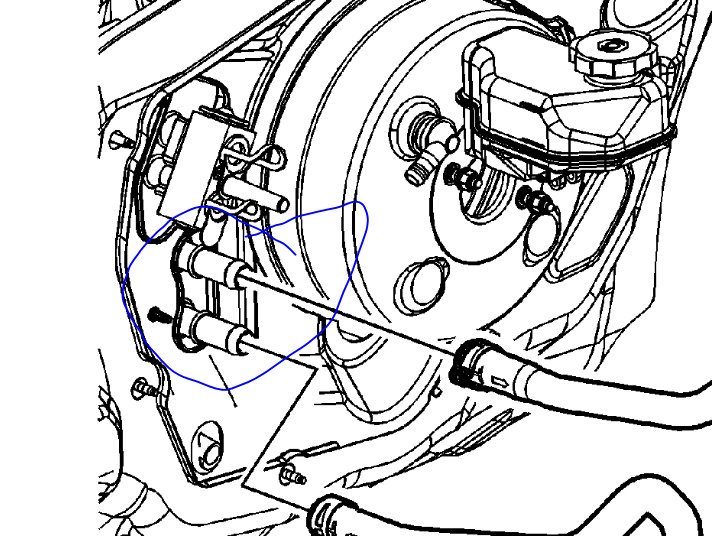

I have it warming up, there is so much plastic covering the motor it's hard to see anything, where are the hoses located? Not noticeable, the top hose is warmer but not too hot

KEN DALY
I did some more checking you were correct with the "Air Temperature Door Actuator" which I replaced now the heater works great again! ya! it was a little tough but I hung in there and got the job done. Thanks 2Carpros :)
