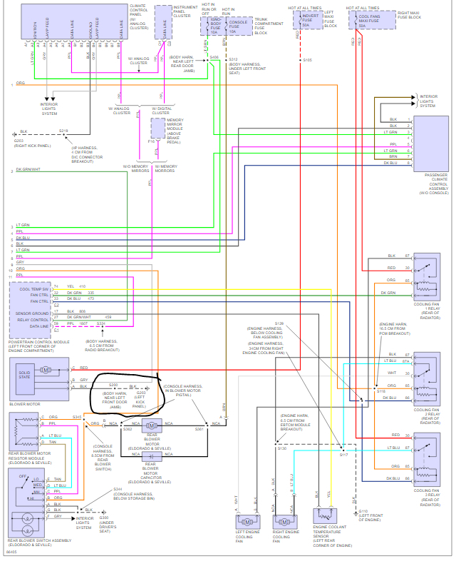

What cause my heater to run awhile cut off awhile and back on? ( on and off)

Hi Reardrive, my name is Alex and I will be helping you today. This sound like a loose connection to me. You might want to check the ground connection where I circled on this wiring diagram. I also am sending a couple of links on how to test the ground as well. Thank you and I hope this helps.
