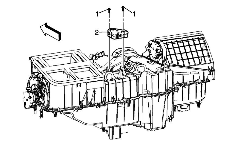

My heater will be warm until I turn on the fan, then the temperature starts to cool off. The rear heat works. I have checked the coolant level it is good. I have located the actuator beside the gas pedal, the one over the transmission hump and one on top behind the radio. How to know which one is the bad one?

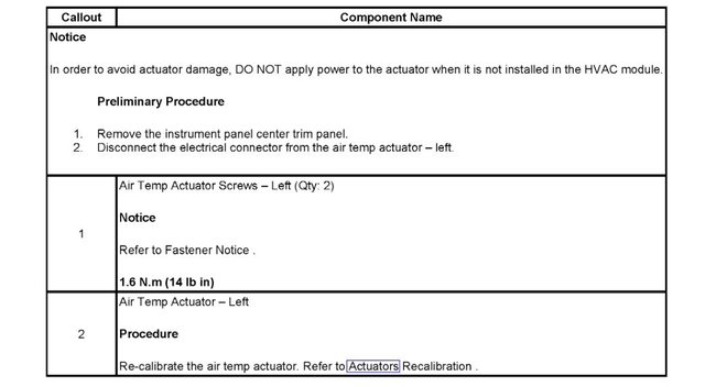

I attached the location of the blend door actuator for the passenger side along with the procedure.
I still think you have a clogged heater core. You should remove both hoses and flush the core with your garden hose. Flush back and forth several times until you get an even flow from both sides.

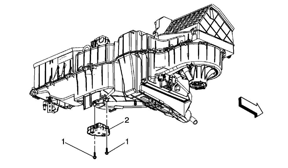

I will flush the heater core, but if it is that blend door actuator how in the world do you get it out of there? I took loose the glove compartment door and I can see it and feel it, but I do not know if I can remove it from this position.

Did you read the procedure I sent you?
You remove the top cover and it is right there.

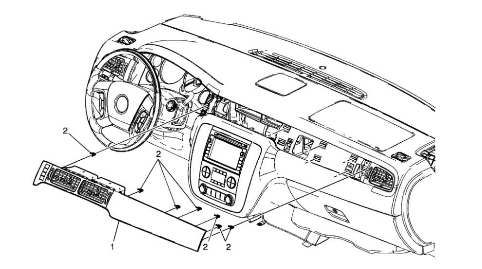

Not on a 2007 Yukon. Can remove the trim around the radio and temperature controls and remove radio and temperature controls and it is not accessible from there.
Oct 29, 2018 at 5:59 AM
This is what it shows on my Alldata.
