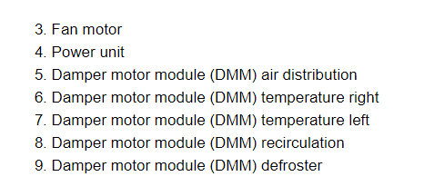

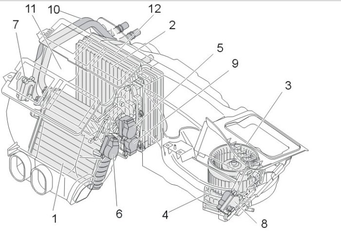

The heater blows hot and cold. new water pump correct coolant. set temperature at high they blow hot then blow cold for twenty seconds then back hot.
Jan 18, 2018 at 7:54 PM
  • 55,423 POSTS

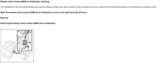

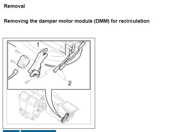

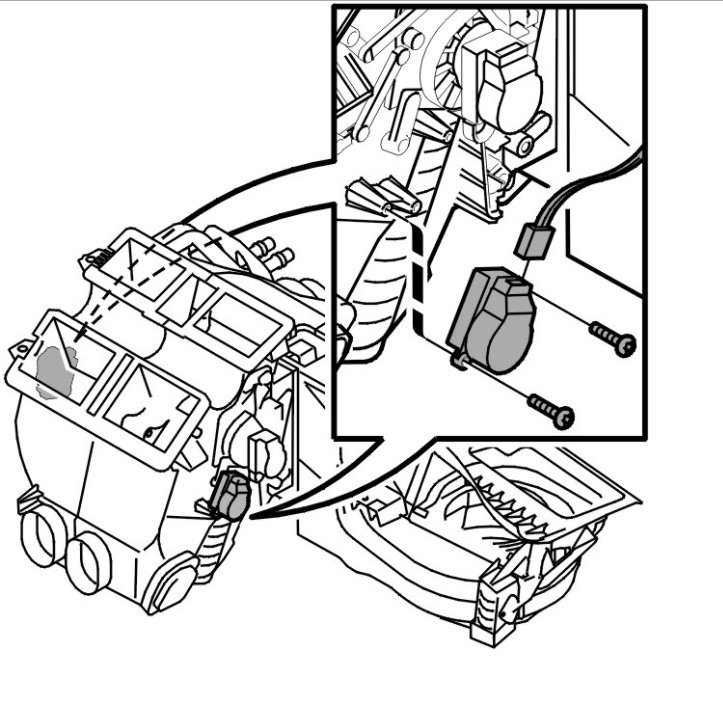

It sounds like you have a temperature blend door actuator that needs replacing. Here is a guide to show you what you are in for when doing the job:

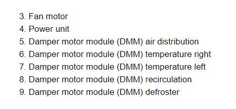

Below are all of the blend door actuators just in case you want to see how the system works.
