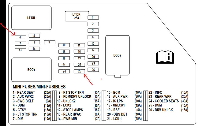

Where is the heated seat fuse located?
2011 GMC YUKON
190,000 MILES
CHRISTINE RHOADS HAHN
Looking at my manual, I cannot find where the fuse is for the heated seats. I found the fuse location for the cooled seats element. Would this run on the same fuse as the heated seats?

There are two fuses and one circuit breaker that run the heated seats which are located in the fuse panel at the left side of the dash. Here are the fuse locations and a guide to help you test the fuses. Fuse ID: DSM, DDM both are 15 amp and the Driver Seat 2 circuit breaker.
If the fuses are good, you may have a switch or the driver's memory seat module that is going out. Here are the fuse locations. Check out the images (below). Please let us know what happens.
