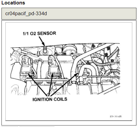

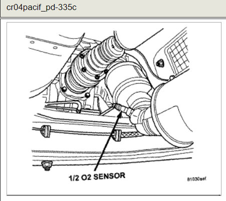

PLEASE!!!!!!!!! tell me where this part is specifically located on my car so we can replace
Feb 9, 2015 at 5:28 AM
JDL
  • 16,098 POSTS
Note the picture. Our info shows that for location.

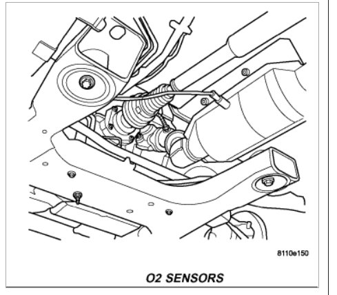

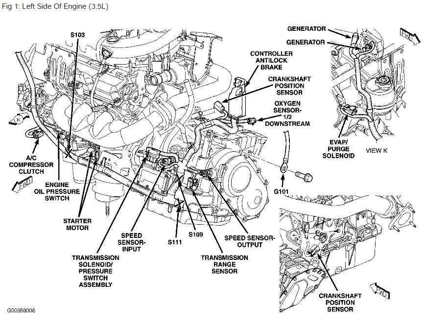

Here is a guide to help you change the sensor out with the location of the sensors below.
https://www.2carpros.com/articles/how-to-replace-an-oxygen-sensor
There is not a fuse or relay for the oxygen sensors. Check out the diagrams (Below) Please let us know if you need anything else to get the problem fixed.
