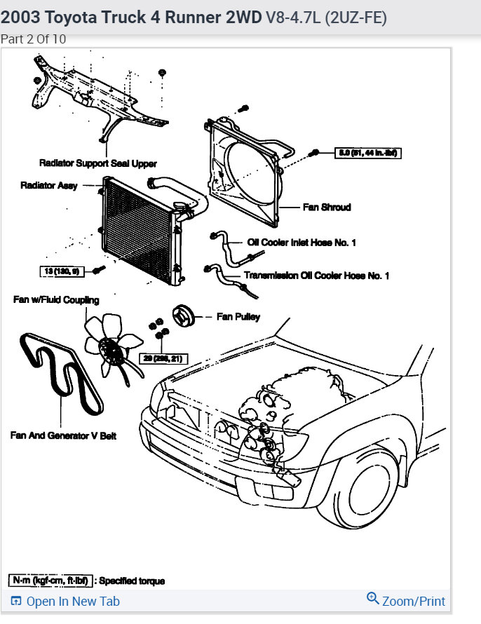

My cars engine gets really hot in a short period of time, but it does not overheat. I've changed the oil, spark plugs, thermostat, manifold exhaust gaskets and did a radiator flush. Still no luck. Can a 02 sensor cause this much damage?

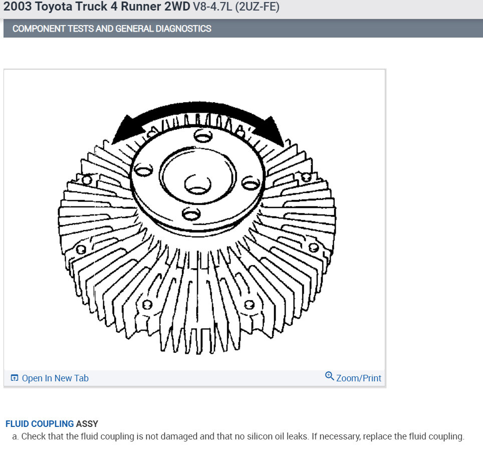

The oxygen sensor cannot cause this kind of problem, do you hear the clutch fan kick in when the engine is hot? If not, I would replace the fan clutch.
Here are two guides to help you with instructions below to help you with your truck:
https://www.2carpros.com/articles/fan-clutch-removal
and
https://www.2carpros.com/articles/fan-clutch-symptoms
