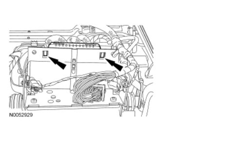

Heated and cooled seats not working. Both Passenger and driver are not working. Rear heated seat works. For the front when you press the power button for either heat or cooling the indicator lights come on, stay on for a second or two and then go off.

Yep, 9 times out of 10 it will be the dual climate control seat module located under the passengers seat. You might wat to try to get a used unit from ebay. You might wat to do a CAN scan to help confirm the failure.
CAN SCAN - https://youtu.be/u-4syLc-ifQ
Here is an image of the location which I will send through email as well. Check out the images (below). Please let us know what happens.

Yes, the module is under the passengers seat. That should fix the problem.
