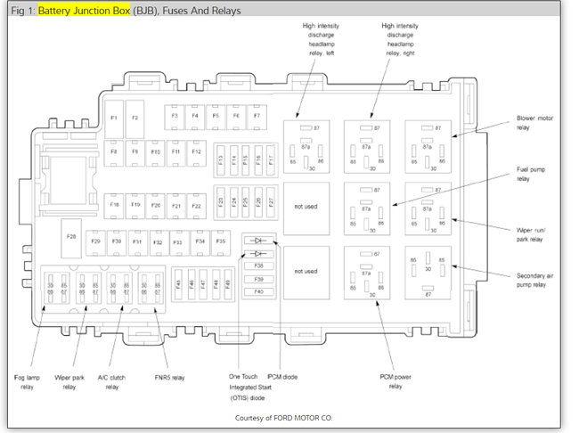

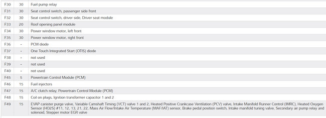

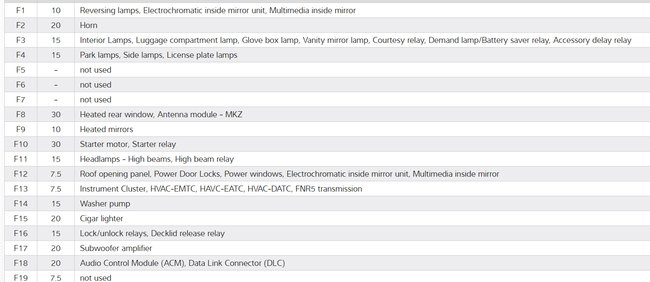

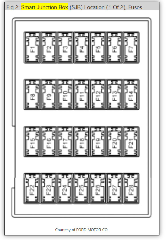

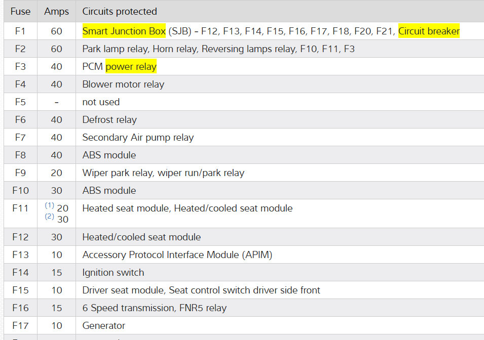

There is a fuse that runs the system #12 - 30 amp in the fuse panel under the hood here is a guide to help you test it and the fuse location in the diagrams below.
Check out the diagrams (Below). Please let us know what you find. We are interested to see what it is.

Thank you for this post I had this problem and had to replace the fuse cost me $4.00 all fixed I love this site.
