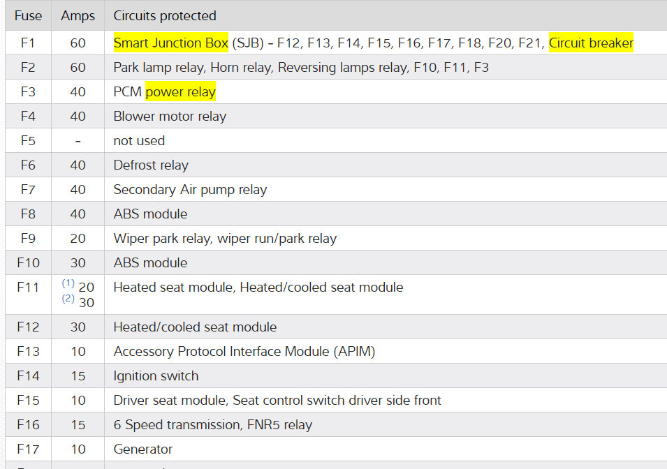

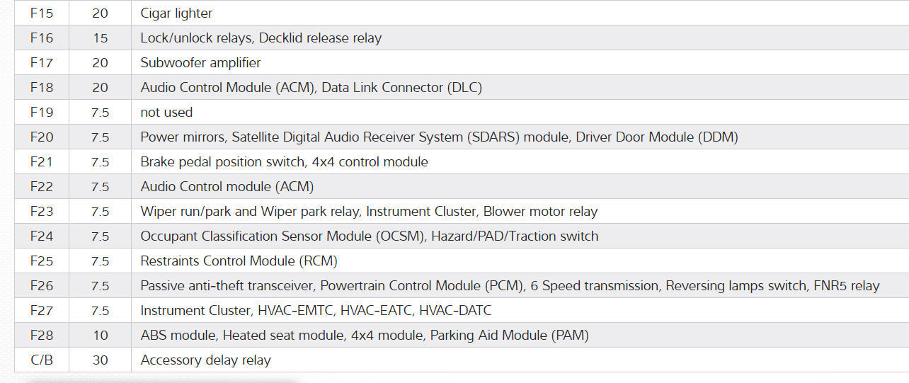

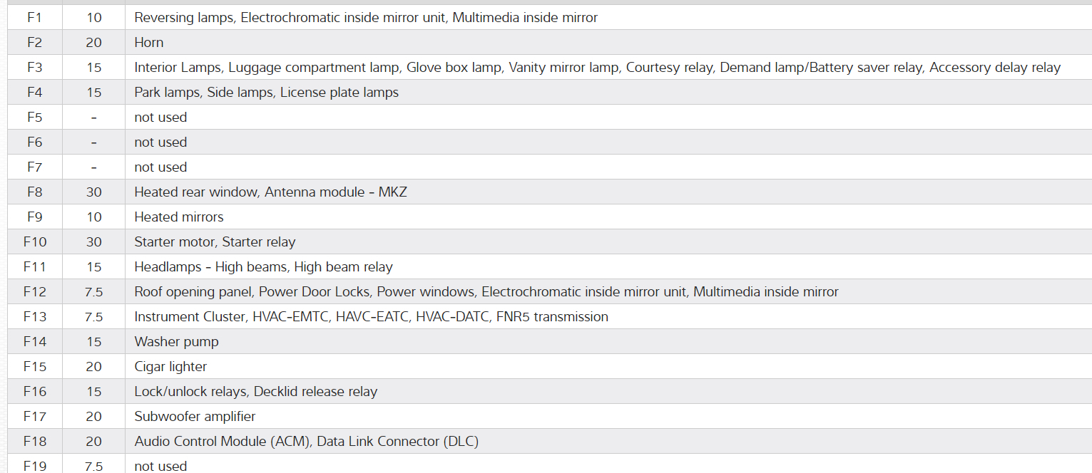

2010 Lincoln MKZ heated cooled seats not working! When I got in my car this morning I tried to turn on my cooled seat, it didn't come on. I tried the heated seat, and it too wouldn't come on. I pushed the button and the light came on for about 2 seconds then went off. The same thing goes for the passenger side. Can you tell me what the possible causes may be?
Aug 11, 2014 at 11:35 AM
MLDANIELS2000
  • 227 POSTS

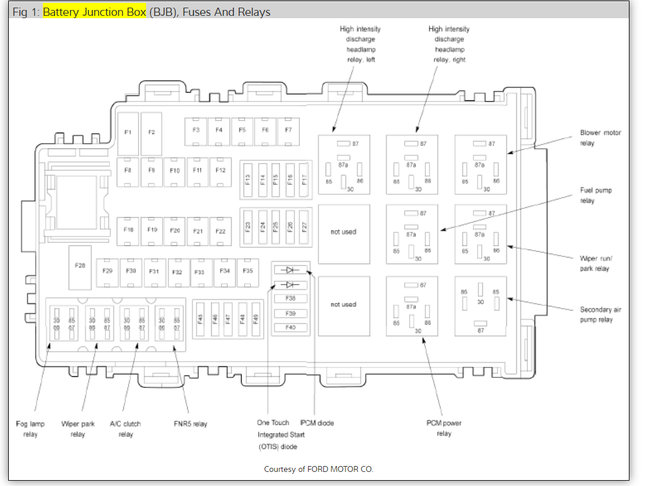

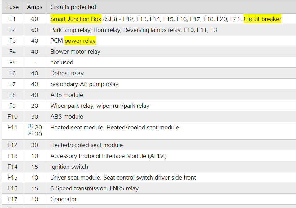

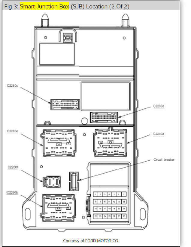

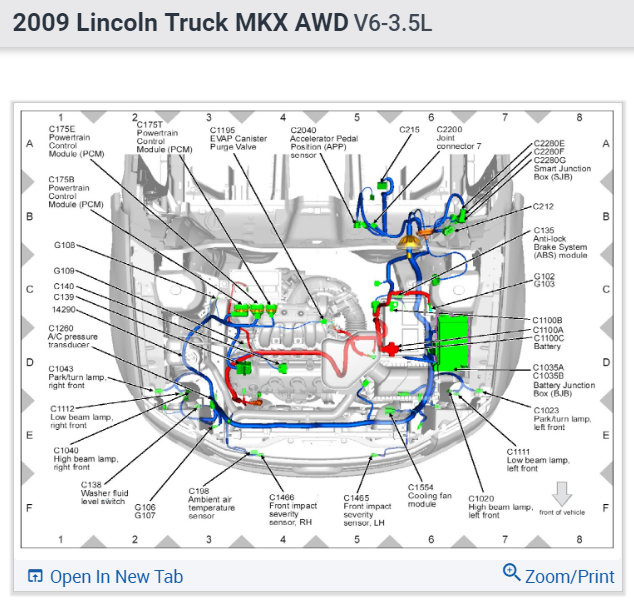

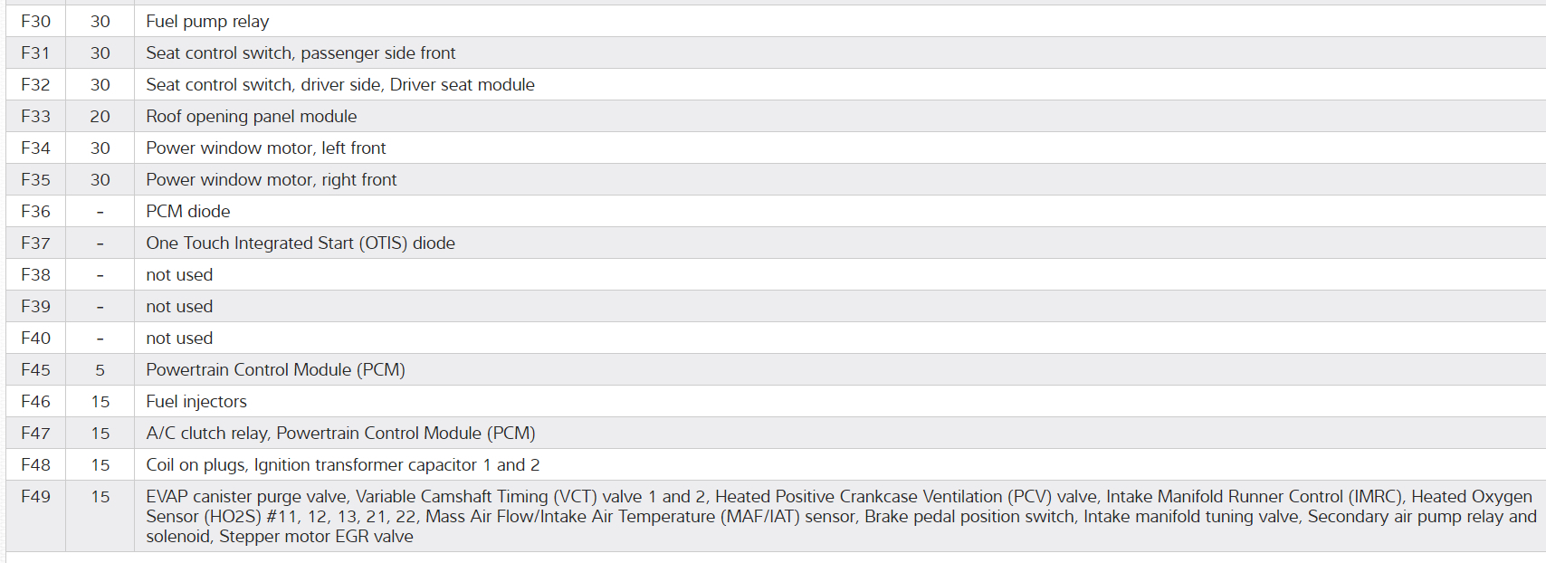

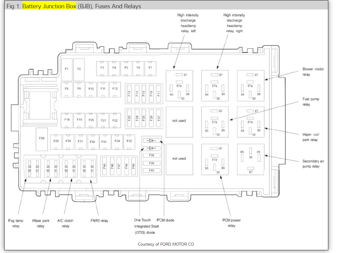

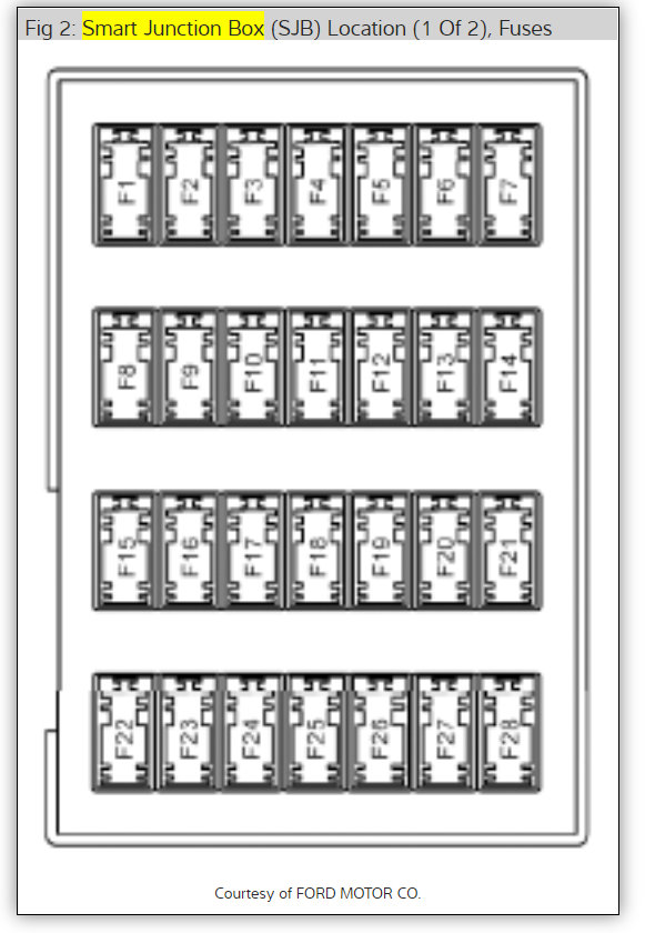

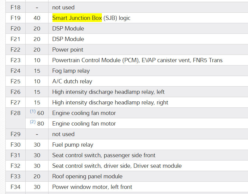

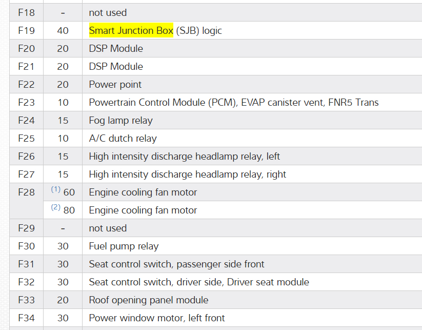

There is a fuse that runs the system #12 - 30 amp in the fuse panel under the hood here is a guide to help you test it and the fuse location in the diagrams below.
Check out the diagrams (Below). Please let us know what you find. We are interested to see what it is.
Aug 11, 2014 at 4:55 PM
JUNIORALTI
Thank you for this post I had this problem and had to replace the fuse cost me $4.00 all fixed I love this site.
