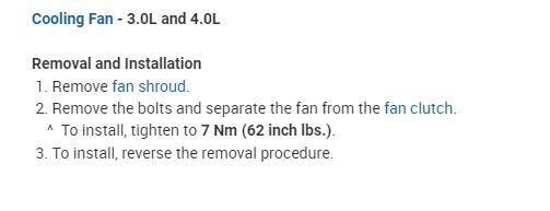

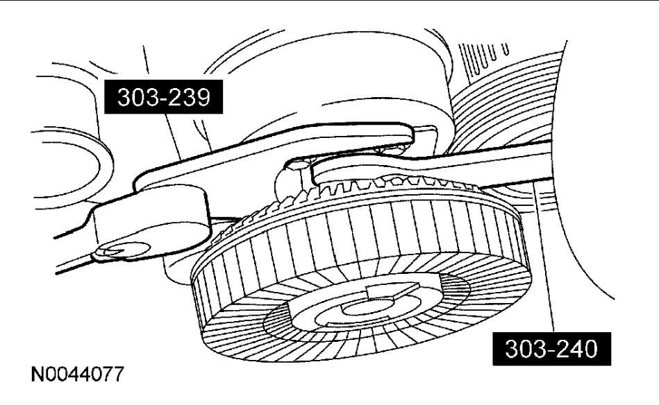

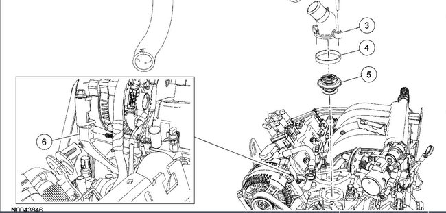

Good afternoon,
I would start by checking the cooling fan to be sure it is working. Heating up at idle is usually an air flow issue from the fan itself.
https://www.2carpros.com/articles/engine-overheating-or-running-hot
I would also change the thermostat.

The fan seems to run all the time it's belt driven and I've never seen it not run. Also you think it could be the thermostat going out? I would think it would overheat while driving but I could be wrong. When driving it stays right in the middle like it should it only happens when I have it parked and it's just idling for like 5-10 minutes.
Mar 19, 2020 at 4:48 AM
JUSTIN STUDDARD
  • 49 POSTS
I'm off tomorrow so I'll go ahead and throw a new thermostat in since that's pretty cheap anyways and it probably wouldn't hurt to change it. Would that cause the gurgling noise I keep hearing?
Mar 19, 2020 at 4:51 AM
Yes, it could.
I would also clean out the fins in the radiator of all dirt and debris as that dirt could also be causing this issue.
I still think the clutch fan could be the issue.
