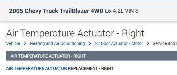

My heat had stopped working a few weeks ago And I wasn’t exactly positive what the problem was so I started with the blower motor and it was fine then I checked the climate control knob’s which ended up not being the problem but when I was putting it back together and back in its spot…I broke the knob/lever that moves up and down to control the temperature on the passenger side so now the passenger side is stuck on cold. So, now I’m trying to find where the door/flap is located so that I can manually pull it up so that it will constantly blow heat just until I can afford to buy a new climate control and put in. Or is it possible to pull a certain wire that would completely stop any and all air from even blowing out from the passenger side? I know that’s not the correct way of handling this problem but it’s freezing outside right now, and a climate control module is going to cost close to $300. Any and all help is greatly appreciated!!

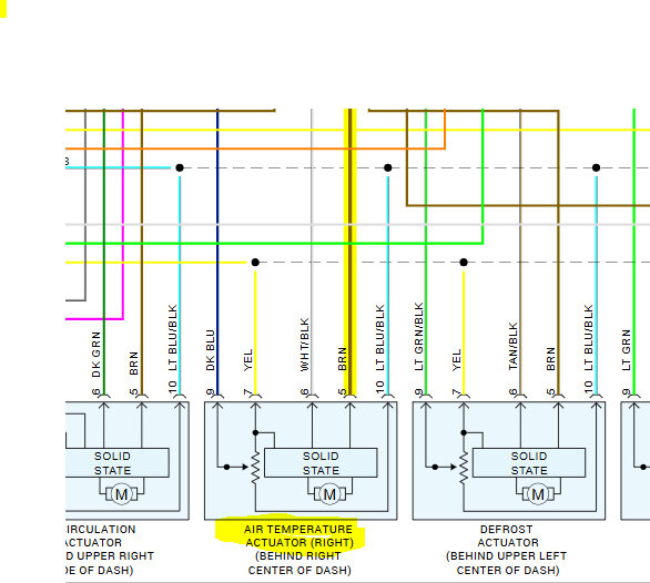

If you look below, I attached a schematic that indicates the power supply to the air temp actuator on the right is brown. You would need to disconnect that wire.

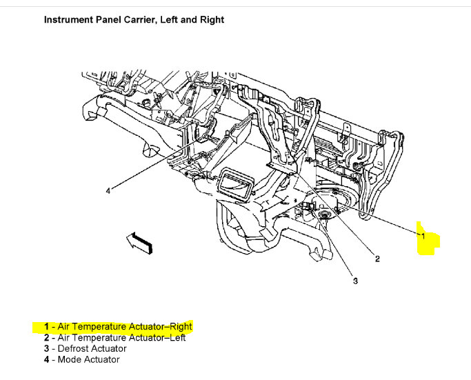

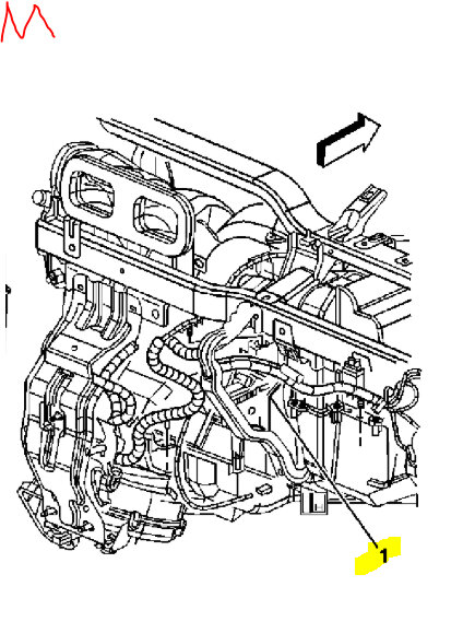

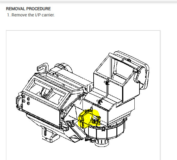

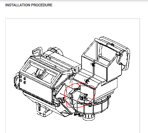

The second pic shows the actuator location on a manual climate control system. Pic 3 shows the actuator with automatic climate control. I'm not sure which you have.

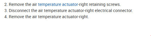

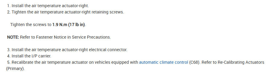

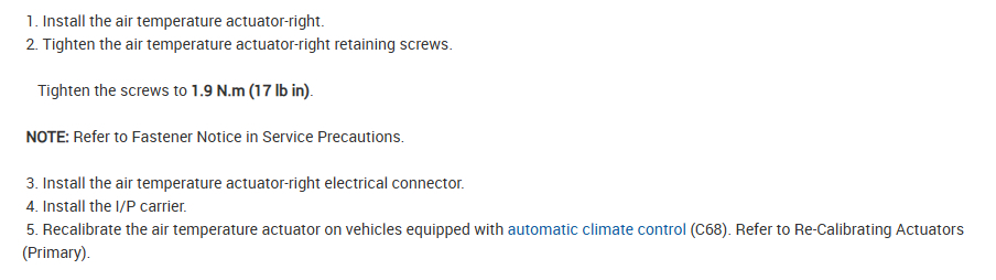

Starting with pic 4 are the directions for replacing the actuator.

Okay, so once I unhook the brown wire, then that will stop the air flow from coming out of the passenger side, right?! So, therefore instead of it blowing cold air out, it won’t blow any air out on that side. And mine is a manual climate control.
Jan 24, 2025 at 11:43 AM
  • 110,244 POSTS
No, if you disconnect that wire, it will still blow air, but the actuator won't move the door anymore. So, wherever it is positioned won't change.
If I had to deal with this, I would remove the actuator and then adjust the blend door to heat until it can be repaired.
Let me know if that helps.
Jan 25, 2025 at 12:26 PM
JADEW19
Oksy. So, that actuator that you’re telling me to remove to adjust the blend door looks like it is back behind the blower motor, is that correct?
Jan 25, 2025 at 1:16 PM
  • 110,244 POSTS
Yes, that sounds correct. Once you remove it, you can manually move the door. You will need to do something to prevent it from moving once you get it in the position you want.
