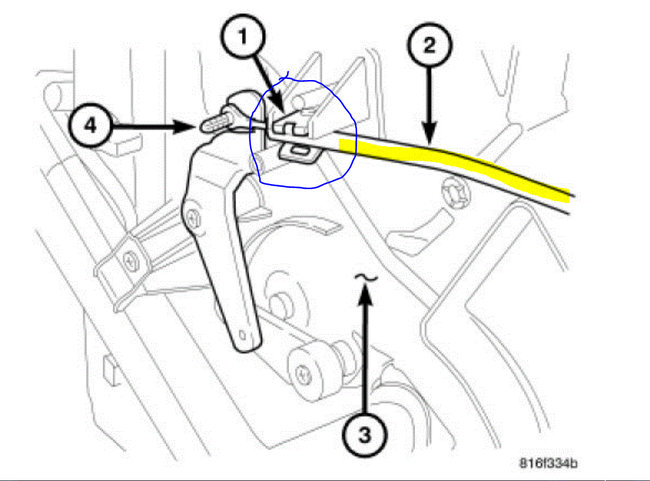

I have the vehicle listed above (Sahara) that has an issue with the heater. The heat is blowing hot on the passenger side and cold on the driver side. I have flushed/clr’d the lines, the blend door is working fine. Someone suggested it may be the heat module. would like to know what your thoughts are.
Dec 14, 2020 at 1:02 AM
  • 110,251 POSTS
The manual is only showing the blend air door on this vehicle as a mechanical, cable operated door. I attached a pic below. Is that what you are seeing? Also, are the cables moving the doors and properly adjusted?
I circled the cable mount location. Check to see if the cable insulator has moved in the mount.
