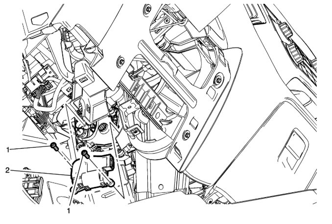

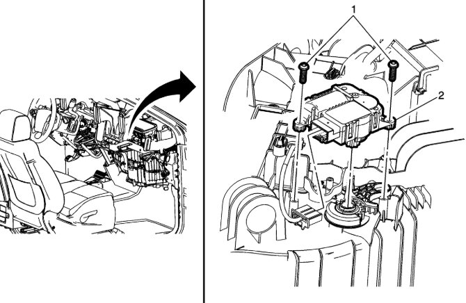

Hmm, it can be both he mode and driver side side blend door actuator have gone out. You can run a CAN scan which will give you codes or replace both actuators. Here is a video to help.
CAN SCAN - https://youtu.be/u-4syLc-ifQ
Here are the locations of the actuators so you can check it out. Do all of the lights come on for the HVAC unit? I would try the mode actuator first, it is easier to get to than the drivers side unit. Here are their locations. Check out the images (below). Let us know how it goes
