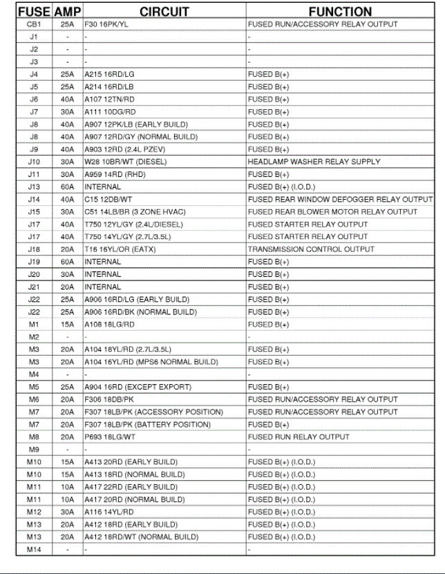

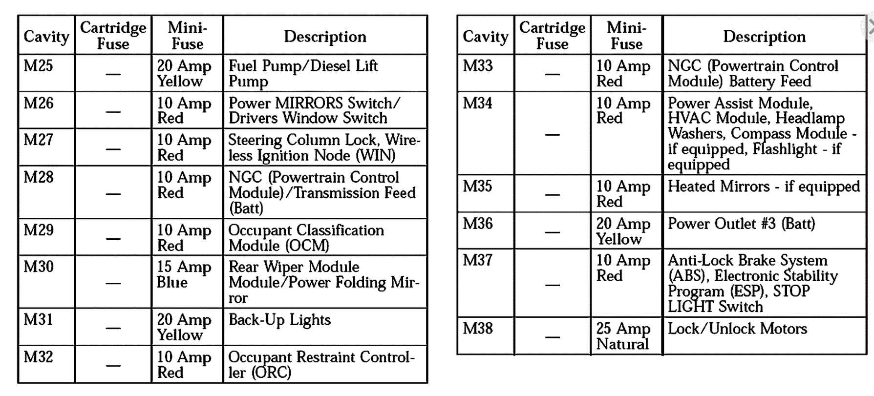

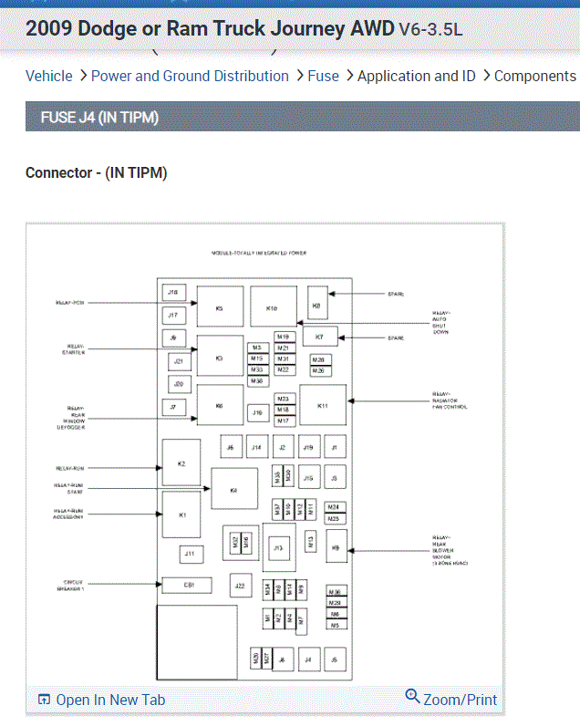

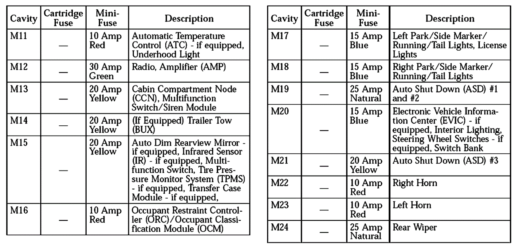

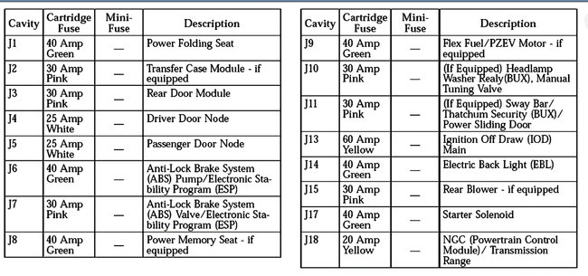

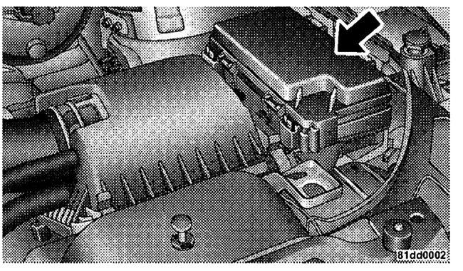

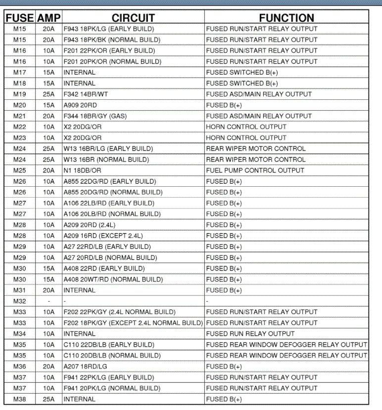

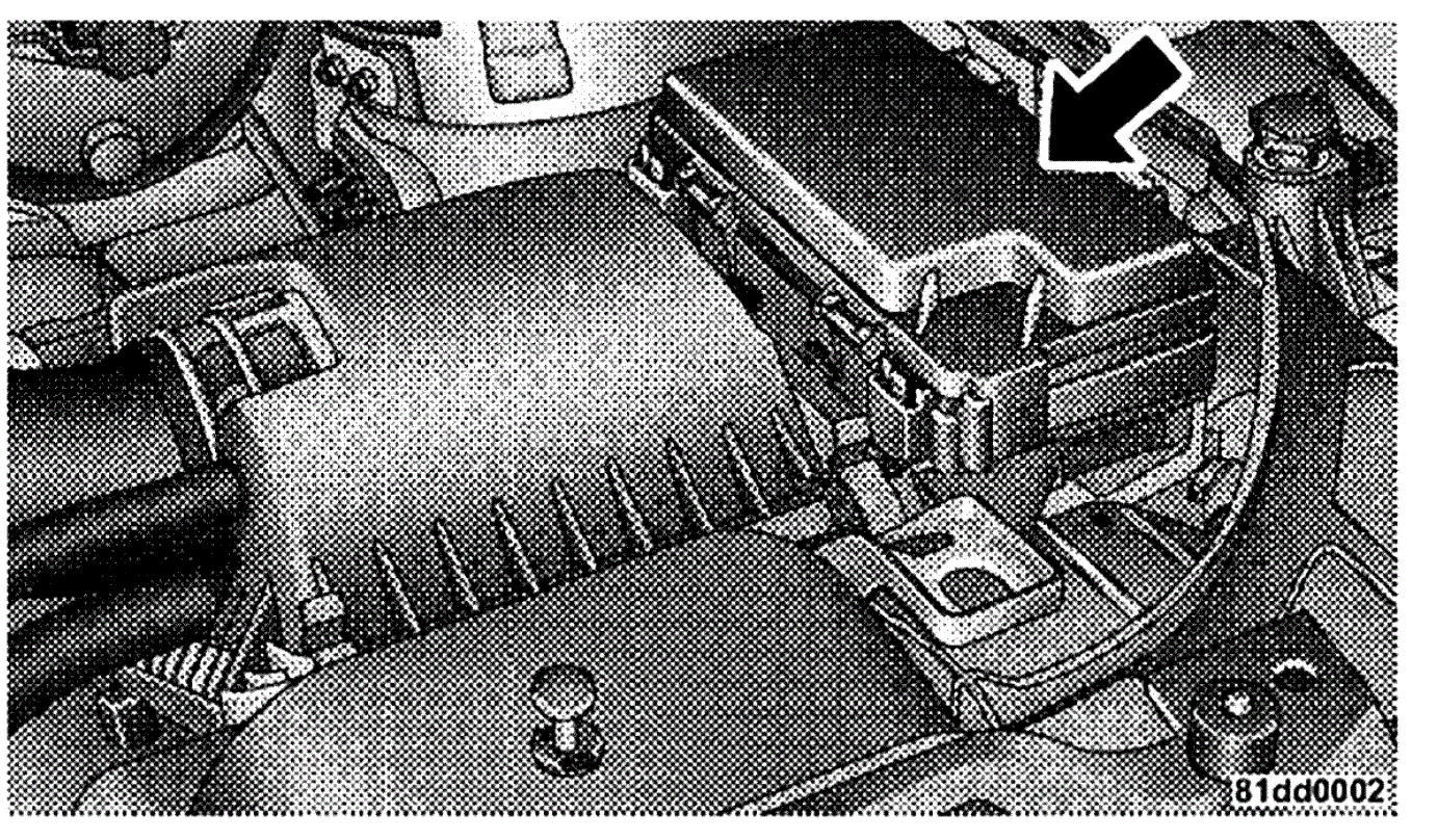

I have heat on driver side but none on passenger side I have changed the actuator door and now I think it is a fuse where are they and how do I check them?
Jan 12, 2016 at 12:57 PM
  • 110,194 POSTS

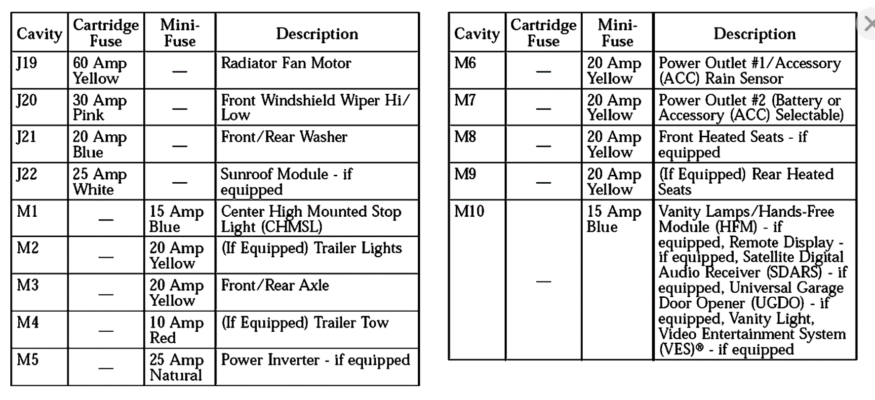

If you look at the attachments below, they provide the fuse box orientations and what each fuse is for.
In addition to just checking a fuse, make sure there is power to it. A fuse may be good and not be receiving power.
