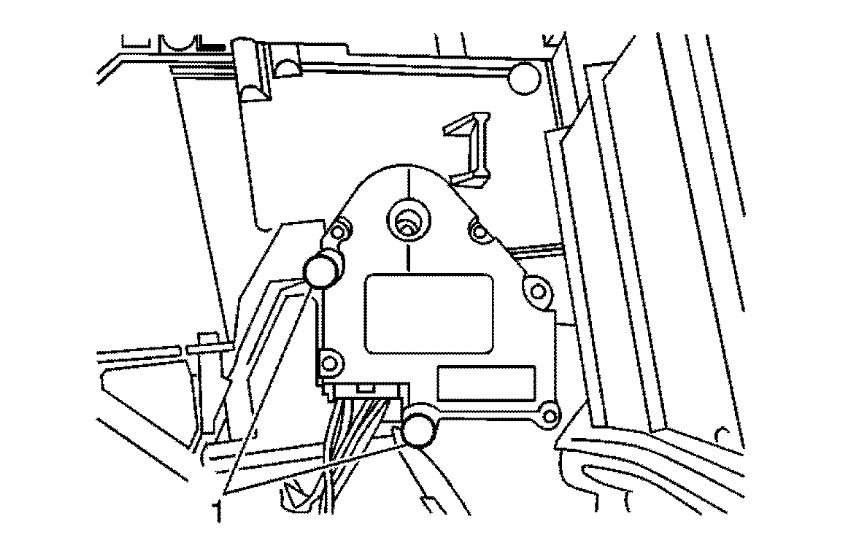

Everything seems to be working changes from floor to mid to defrost. i believe it is an actuator, but what is the exact name of that part? looking to order online but i see different pins and connections. oh and where the heck is it exactly? i need i believe right side actuator. a part number for that actual part would be great. Thanks, Don

Good evening,
It is called a blend door actuator.
it is under the dash right side of the dash. I attached a picture and the procedure.
https://www.rockauto.com/en/catalog/buick,1998,park+avenue,3.8l+v6,1303300,heat+&+air+conditioning,heater+blend+door+actuator,10721
Air Mix Actuator Replacement - Passenger
1. Remove the right sound insulator. Refer to Instrument Panel Insulator Panel Replacement See: Dashboard / Instrument Panel > Procedures.
2. Remove the instrument panel (I/P) compartment. Refer to Instrument Panel Compartment Replacement See: Dashboard / Instrument Panel > Procedures.
3. Remove the body control module and the HVAC programmer from the brackets and lay aside.
4. Disconnect the electrical connector from the passenger air mix actuator.
5. Remove the passenger air mix actuator retaining screws (1).

i thought i could remove and replace by just removing the sound insulator and glove box. Could you elaborate on 2. and 3.?

However, i don't see this in the see this in the step by step. Remove the body control module and the HVAC programmer from the brackets.
Jan 9, 2019 at 8:26 PM
You should be able to see it from removing the insulator. It pays half an hour from start to finish. nothing else should have to be removed.

Got it off. i got one bolt from the bottom and one through the glove box. i had to unclip a grey box that was in the way.
