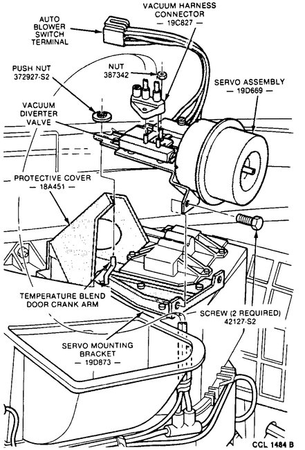

No heat. Engine temperature good. Heater hoses seem to be hot, one maybe more than the other. Temperature can be run on the controls from 60 to 90 with no affect. Cold air only!
Nov 9, 2020 at 8:39 AM
  • 110,240 POSTS
If both heater hoses are getting hot, then the heater core isn't plugged. That leaves the blend air door. The blend air door is what controls the air temp entering the vehicle. What I suggest is to remove it and inspect it to see if it is working. Take a look at this link. It explains in general how one is replaced. Additionally, it explains what goes wrong with them
and
Here are the directions for the removal and replacement of the one specific to your vehicle. The attached pic correlates with the directions.

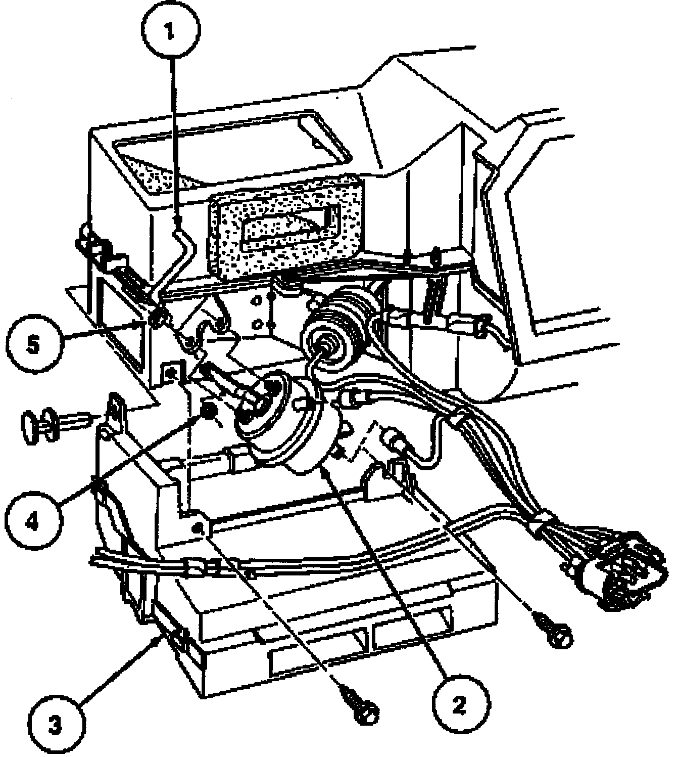

This vehicle does not have a heater control valve. In its place is a blend air door actuator. The heater core in the vehicle always circulates coolant, so it is always hot. What determines if you get heat into the vehicle is the blend air door. In one position, it closes off heat and in the other, it allows heat to enter the cab.
The blend air door is actuated by a vacuum servo. However, if you are not getting heat, confirm that both heater core hoses are getting hot when the engine is at operating temperature and the heater is on high. If they are, the actuator is the problem. If only one of the hoses is hot, suspect a plugged heater core.
Here is a quick link to look through. It discusses common causes of not getting heat.
Here is a link that shows in general how to replace a blend air door actuator:
If you determine the problem is the actuator, here are the directions specific to your vehicle for replacing the actuator which I mentioned. Note that the actuator on your vehicle is vacuum actuated. Make sure it is getting vacuum.

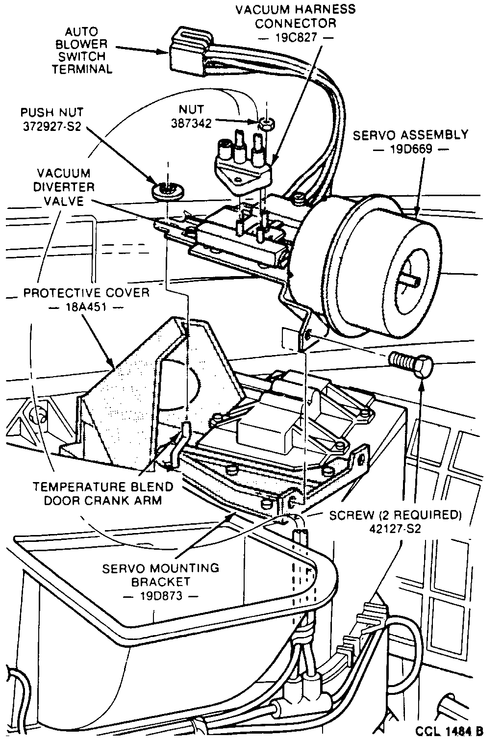

WITH AUTOMATIC TEMPERATURE CONTROL
REMOVAL
1. Disconnect the battery ground cable.
2. Disconnect the glove compartment door stop (one screw) and let the door hang by the hinges.
Servo Motor Assembly See Pic 1
3. Remove the vacuum hose from the servo motor and unplug the electrical harness connectors.
4. Remove the two screws from the servo motor assembly mounting bracket and position the servo for access to the vacuum diverter valve.
5. Remove the retaining pushnut and vacuum connector clip, unplug the multiple vacuum connector from the vacuum diverter valve.
6. Remove the pushnut that retains the servo motor overtravel spring and arm link to the blend door crank arm. Remove the servo assembly from the vehicle.
INSTALLATION
1. Connect the servo motor overtravel spring and arm link to the blend door crank arm. Install a new pushnut.
2. Connect the multiple vacuum connector to the vacuum diverter valve and secure it with a vacuum connector and a new retaining pushnut.
3. Position the servo motor and install the two mounting screws.
4. Connect the vacuum hose to the servo motor and connect the electrical connector to the harness.
5. Replace the glove compartment door stop screw.
6. Connect the battery ground cable.
NOTE: On vehicles equipped with Electronic Engine Control (EEC), when the battery has been disconnected and reconnected, some abnormal drive symptoms may occur while the EEC processor relearns its adaptive strategy. The vehicle may need to be driven 10 miles or more to relearn the strategy.
7. Check the ATC system for proper operation.
__________________________________
I hope something here helps. Let me know if you have other questions.

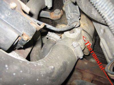

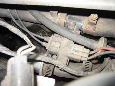

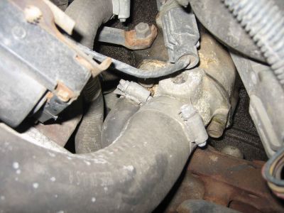

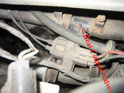

I have an 88 Lincoln Town Car Cartier Edition with some issues. It's got a 5.0 V8 EFI. First Problem - Heat The heat recently quit working (convenient considering it's around 0 degrees out) after a 250 mile trip. I got back in the car to return home and drove for 5 hours with no heat. Here's what I know: The blower still works well Radiator is full and both hoses leaving it get warm when the engine heats up. When I turn the heat on with the temp set to high it gives a burst of hot air for about 1 second then it cuts to cold air. Then if I turn the temp setting to cold with the blower on high I get ice cold air instantly (mind you it's 0-10 degrees F outside) and it stays cold after that. No more slightly cold air, just freezing air. I can get a burst of heat every time I turn the heat on for 1 second, then I turn it off and back on and so on... I don't know much about thermostats or heater cores but it sounds like either might be causing this. The first picture I have is of the location the hose from the top of the radiator runs into the block (I think the water pump). Then another hose runs out of there and into the second picture on the top right corner. It runs across the top of the picture then into the dash. I'd also like to know where the thermostat is in these pictures, I have an idea but I'm not completely sure. I really need to get this fixed soon and I don't have any money to take it to the dealer. I leave school next Thursday and I have to drive 550 miles in frigid winter temps.
https://images.2carpros.com/forum/automotive_pictures/48741_IMG_314401_1.jpg
https://images.2carpros.com/forum/automotive_pictures/48741_IMG_315001_1.jpg

the first picture you show with the upper radiator hose going into that housing with 2 bolts on it, that is the thermostat housing, the thermostat is right under it!
for the heating problem, are both heater core hoses hot, *the hoses that go into the firewall from the engine*
if the uper and lower radiator hose isnt hot then i do not think it is a thermostat problem.
the hose going in and out to the core does one of them feel noticebly hotter or they both the same?

The top pic shows the thermostat, it's at the end of the hose at the block, the small hose with it is the bypass hose. The bottom pic shows the heat control valve, m,ake sure the vacuum work to it, if this lever does not move, hot water will not enter the heater core! COLD air will result!
https://images.2carpros.com/forum/automotive_pictures/62217_48741_IMG_314401_1_1.jpg
https://images.2carpros.com/forum/automotive_pictures/62217_48741_IMG_315001_1_1.jpg
You can as a test remove the heat control valve and install a flush tee, this will eliminate the heat control valve! Buy the Prestone flush kit, the tee is in the kit...

I definitely felt that hose going through the heater control valve in the second picture and it was warm. I didn't look for any other hoses going into the firewall.
So does that mean hot fluid is getting through that valve and into the heater core? Then it could be the heater core (I'm not sure, just guessing).
