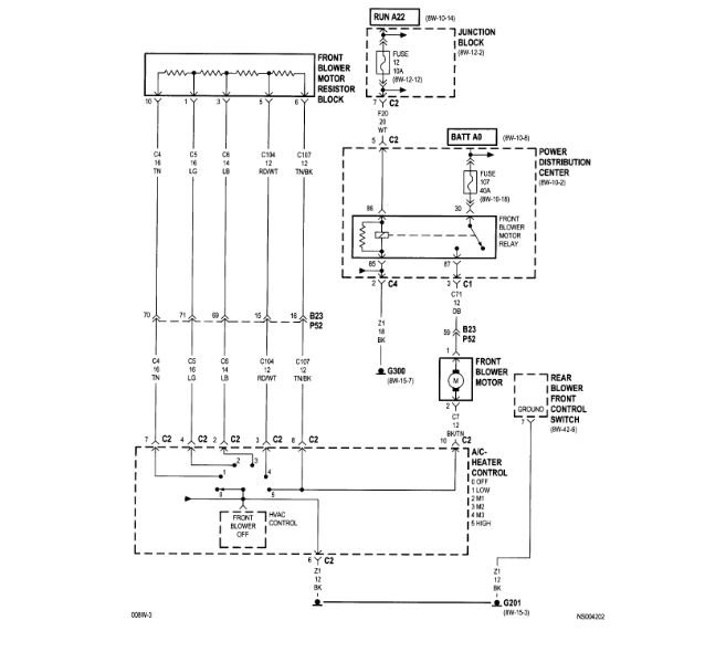

Heater not getting hot and not blowing
2000 CHRYSLER GRAND VOYAGER
195,000 MILES • 3.3L • V6 • 2WD • AUTOMATIC
MDENNISON052378
The heater does get hot just won't blow at all in the front. Replaced the blower motor as well as the resistor tonight still not blowing. I'm out of options as to what it can be. Any help would be appreciated. it's 23° with wind chill it feels like 11° here. I need heat for my kids.

Good evening,
Did you verify power to the resistor and the blower motor?
there is a blower relay. can you remove it and check for power with the key on? there should be two power wires.

We checked the fuse box and fuses all seem to be okay. I wont be able to do anything else to it until this evening after work.
