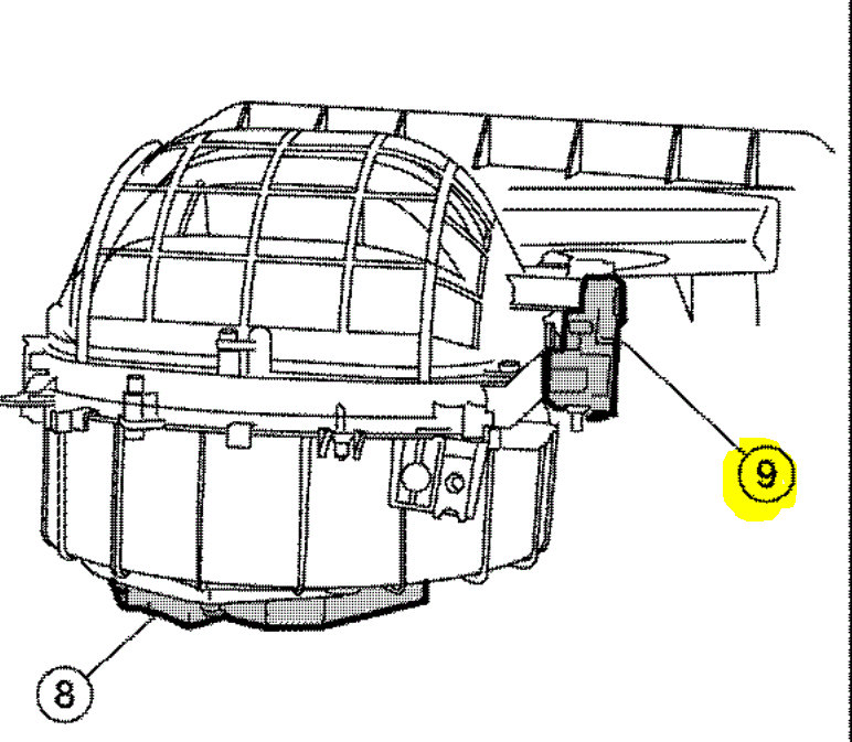

I attached two pics below. The first is the mode door actuator. That determines where air exits the HVAC from, the floor, defroster and so on. The second is the air intake door motor. That is what allows fresh air to make it into the vehicle or recirculate inside air.
Here is what happens. Often times the small plastic gears in the actuators will break. As a result, you will hear a clicking sound. That is what I think you are hearing.
The best thing I can tell you is to either locate the parts I mentioned and see if one of them is making the noise, or remove them one at a time for inspection.
Note, you should be able to access them by removing the glove box.

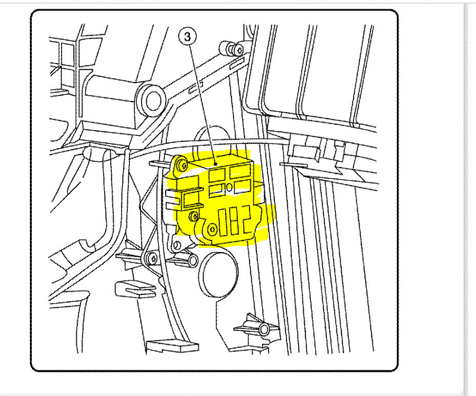

It shouldn't do that and you should have control of the temp. The temperature is controlled by a blend air door (AKA Air mix Door) and there is an actuator for that as well.
Since you hear the noise behind the left side of the dash, it's one of them that is causing the problem. I need to know if the system is automatic climate control or manual. Also, I need to know if you have dual climate control.
Take a look at the pic attached. It shows the blend door (air mix door) for a manual system. This makes more sense to me simply because there is only one that controls both sides.
What I suggest is to either remove it and inspect the gears and see if it operates when you change temperature request. Or, simply replace it. It's on the right side of the HVAC box under the dash and behind the glove box.

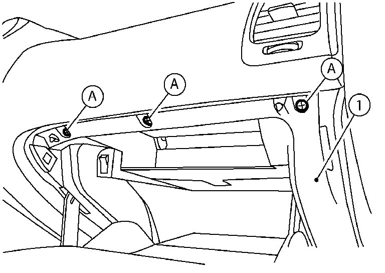

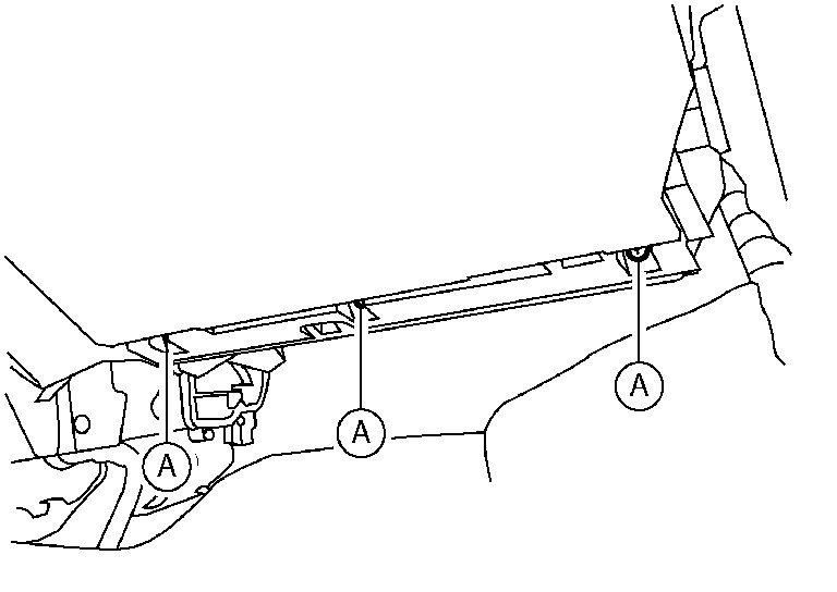

GLOVE BOX ASSEMBLY
Removal and Installation
REMOVAL
1.Remove the instrument side finisher RH using a suitable tool.
pic 2
2.Remove the glove box assembly (1) upper screws (A).
pic 3
3.Remove the glove box assembly lower screws (A).
4.Disconnect the harness connectors from the trunk switch and glove box lamp, then remove the glove box assembly.

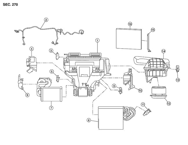

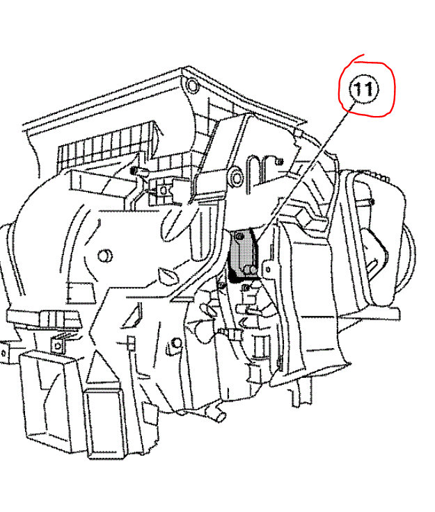

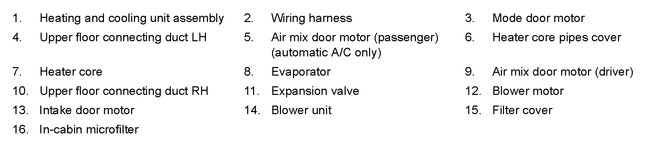

2013 Nissan-Datsun Altima Sedan L4-2.5L (QR25DE)
Exploded View
Vehicle Heating and Air Conditioning Housing Assembly HVAC Service and Repair Removal and Replacement Exploded View
EXPLODED VIEW
HEATING AND COOLING UNIT ASSEMBLY
Exploded View
pic 4
pic 5
