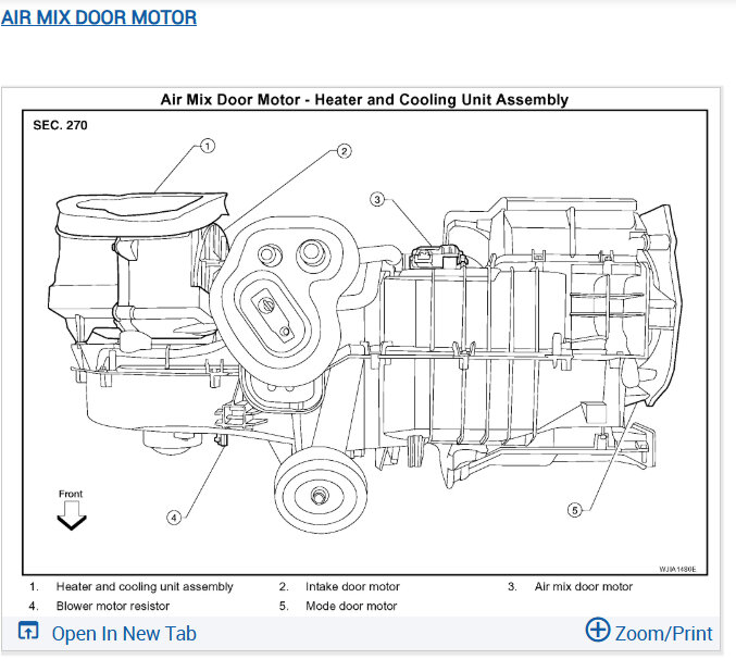

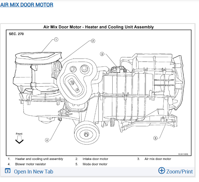

If you check everything and still no heat, I would swap out the air mix door (temperature) blend door actuator. Here is the location so you can check it out. Check out the images (below). Let us know how it goes.

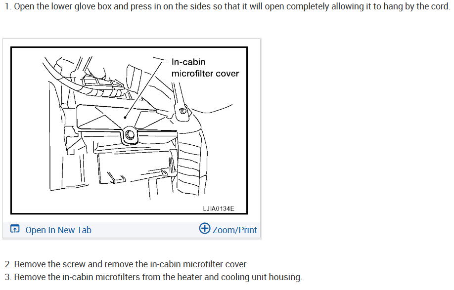

I have heat I am talking about the blowing power, feels like it's on speed 1 of the bower no matter what speed i choose.
Jan 4, 2025 at 3:06 AM
  • 55,399 POSTS

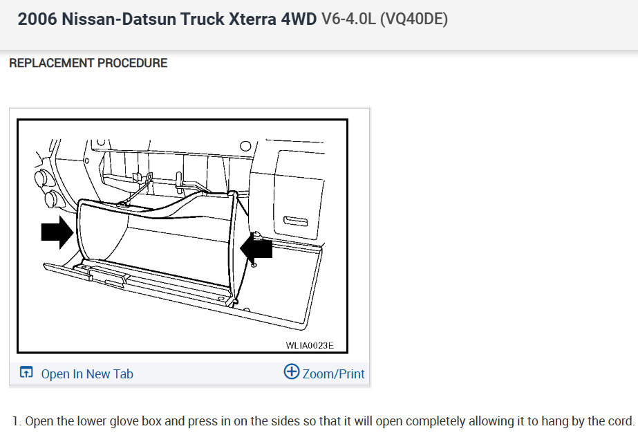

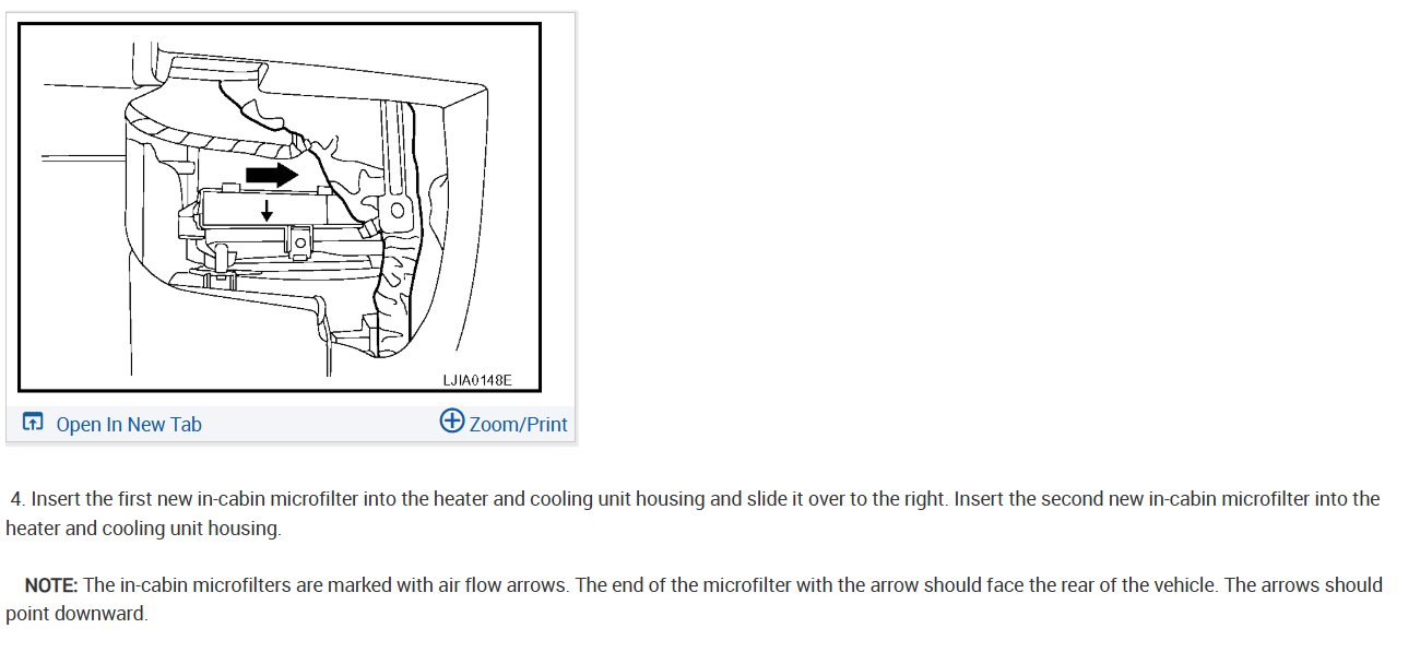

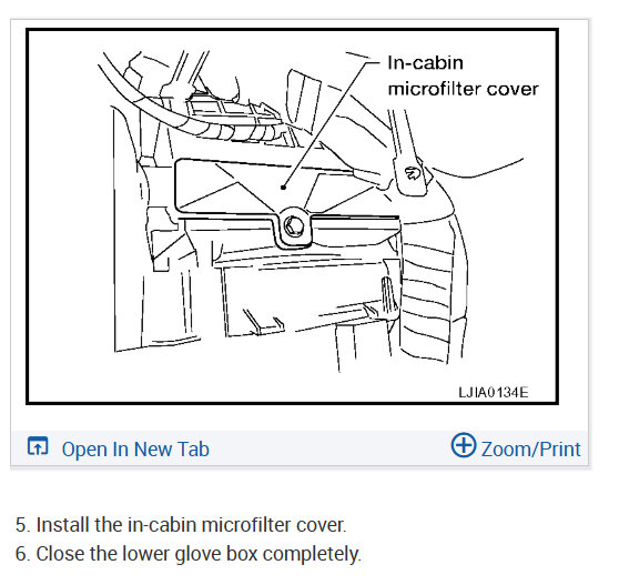

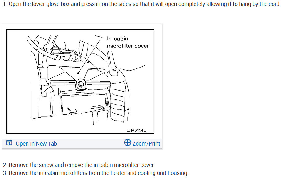

Gotcha, it sounds like the cabin air filter is clogged. here is the location so you can check it out. Check out the images (below). Please let us know what happens.
Jan 4, 2025 at 3:23 AM
BHAMDOC1973
  • 2,007 POSTS
turned out blown was bad, thanks.

Sorry i meant the blower motor.
