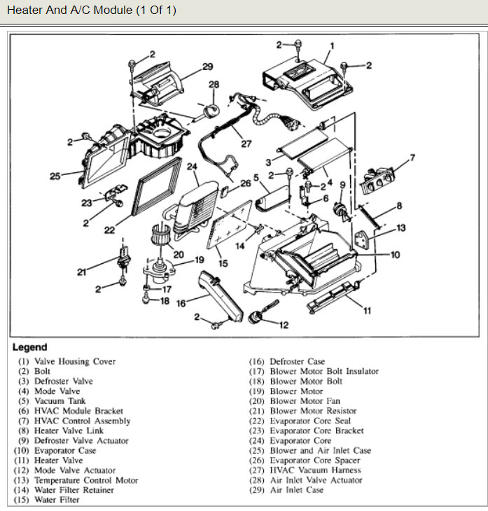

I replaced the blower motor resistor and all speeds worked correctly for a day. Now blower fan fluctuates greatly and seems as if it will stop again.
Dec 28, 2017 at 1:18 PM
  • 55,433 POSTS
What happens is the blower motor pulls to much amperage which burns up the resistor. You need to replace both the fan motor and the resistor.
Here is a guide to help you
https://www.2carpros.com/articles/blower-fan-motor-works-on-high-speed-only
You should use GM parts as well they cost a little more but well worth it.
