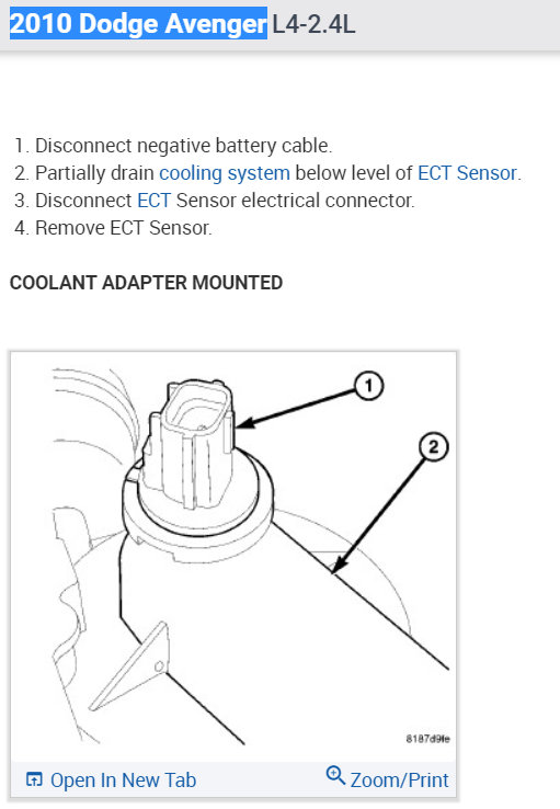

Heat gauge goes up when idle and down when driving normally. Both fans kick on at standard temperature that they should. Changed both thermostats.
Dec 14, 2018 at 4:27 AM
  • 55,423 POSTS

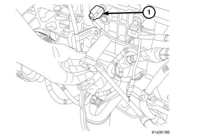

It sounds like you have an engine coolant sensor that needs to be replaced. Here is a guide to help walk you through the repair and the location of the sensor for your car below:
