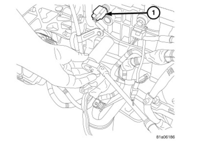

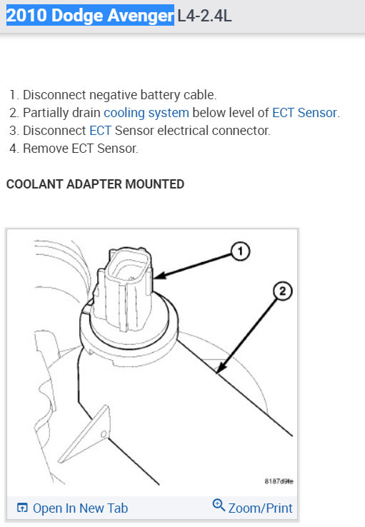

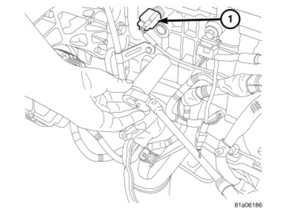

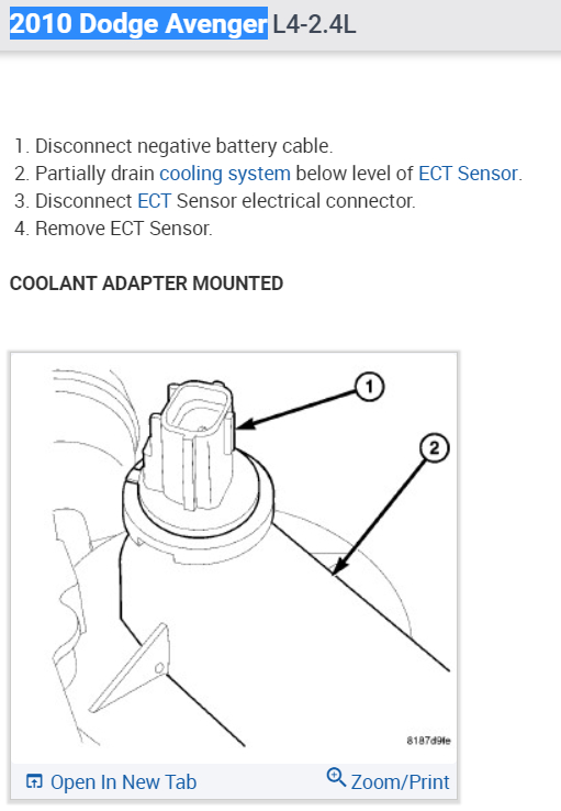

It sounds like you have an engine coolant sensor that needs to be replaced. Here is a guide to help walk you through the repair and the location of the sensor for your car below:
https://www.2carpros.com/articles/coolant-temperature-sensor-cts-replacement
