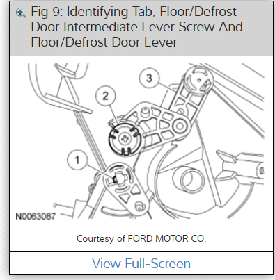

Heat doesn't work at all but AC does.
2014 FORD EDGE
88,000 MILES • V6 • 2WD • AUTOMATIC
MARCIE76
Hi 2Car Pro's!

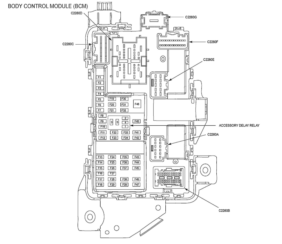

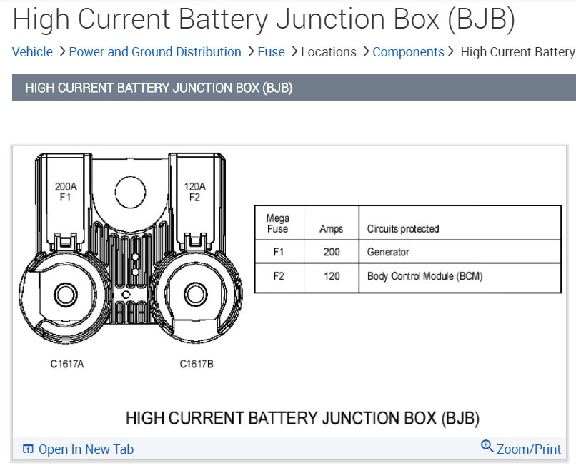

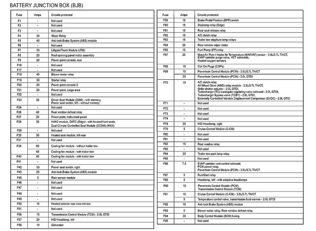

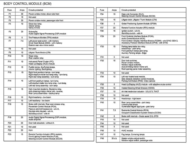

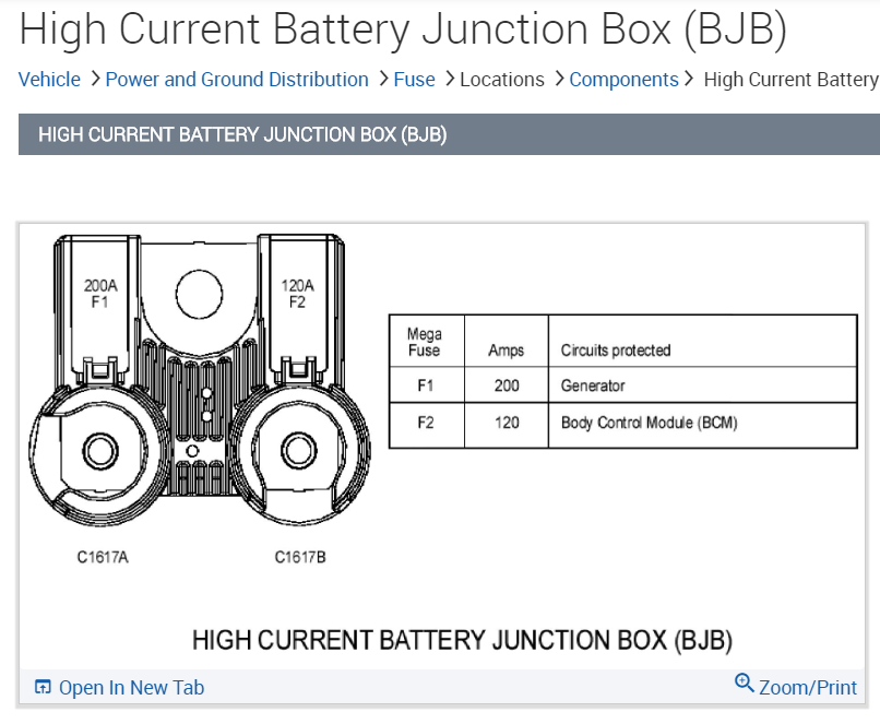

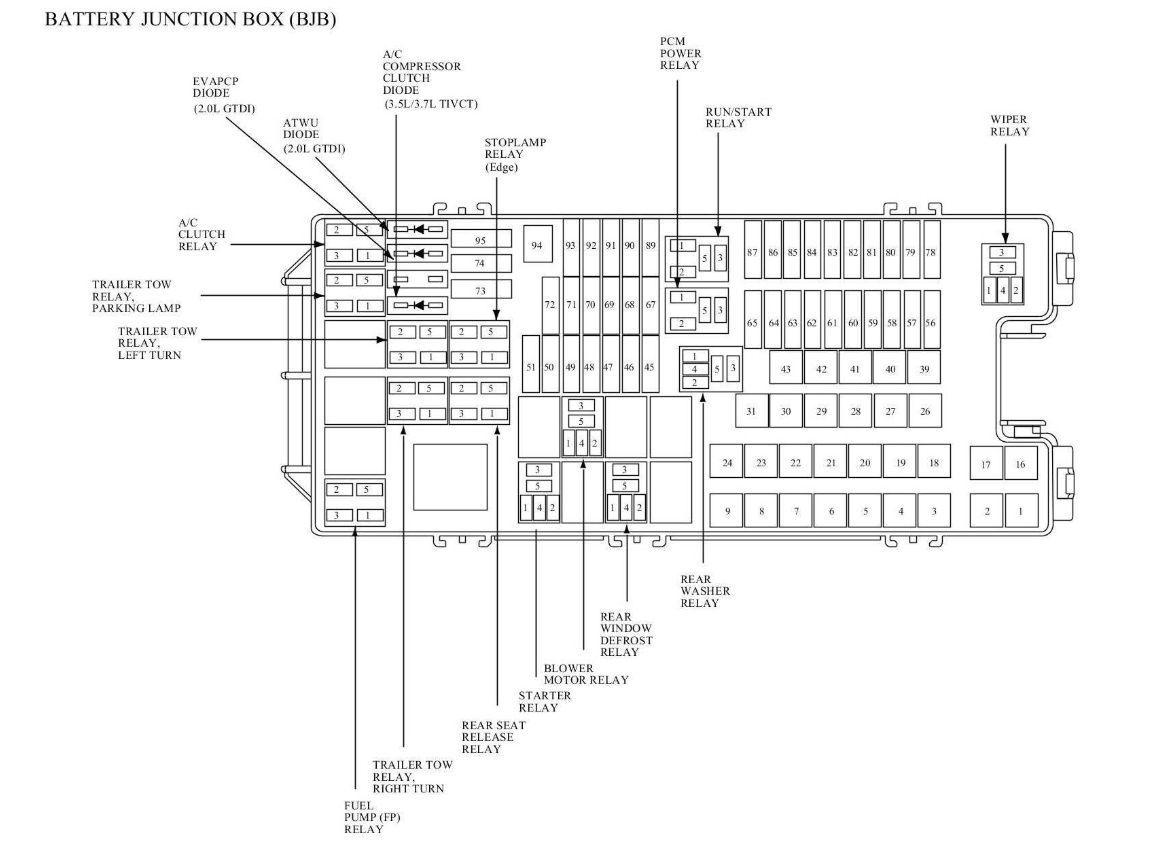

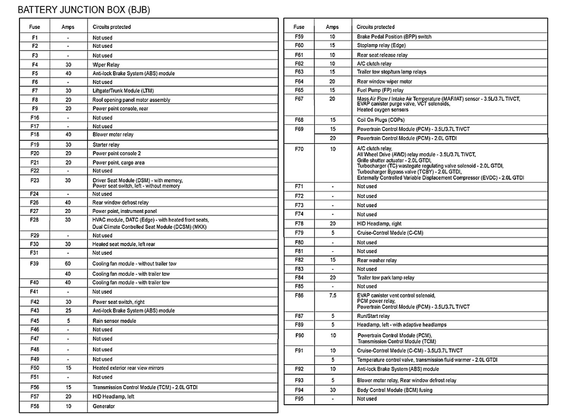

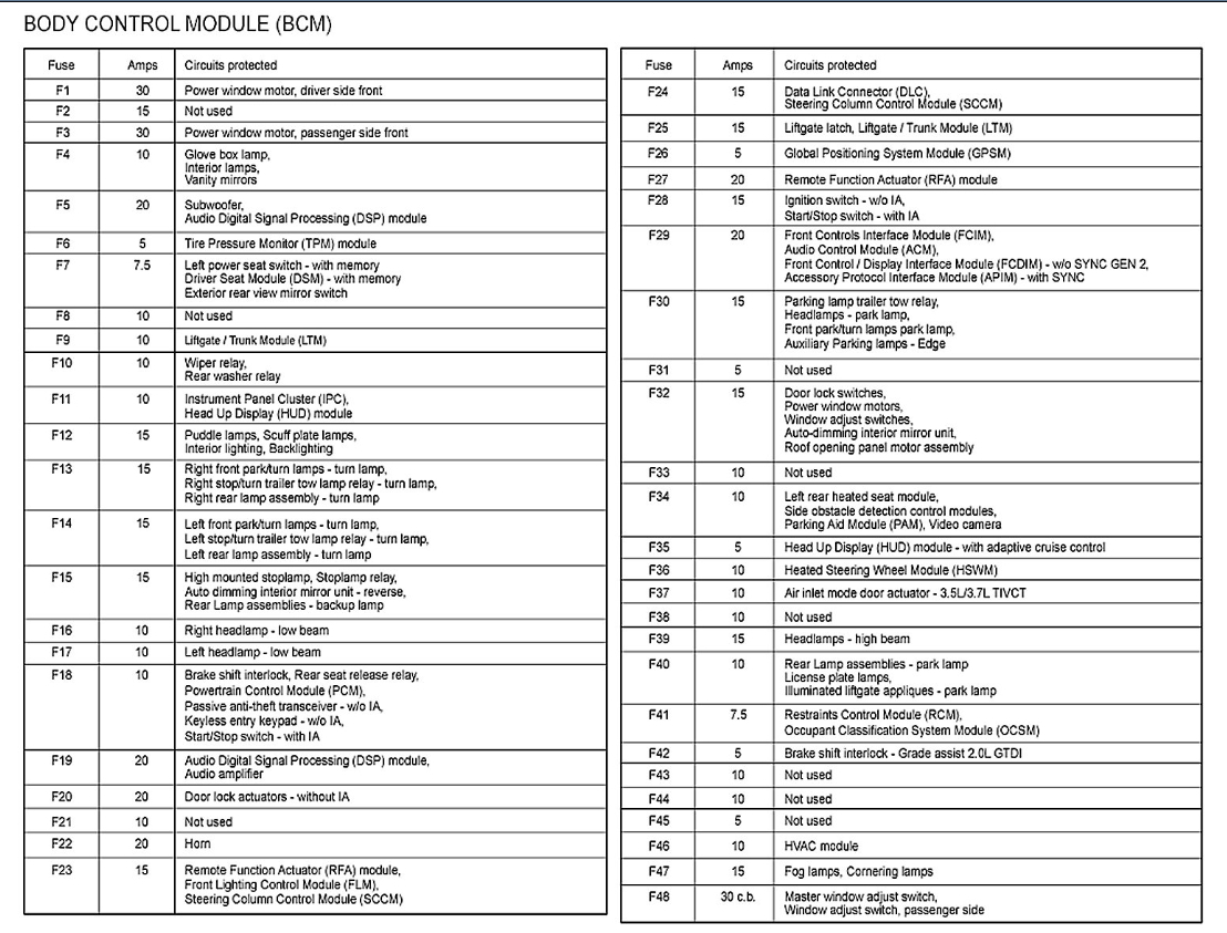

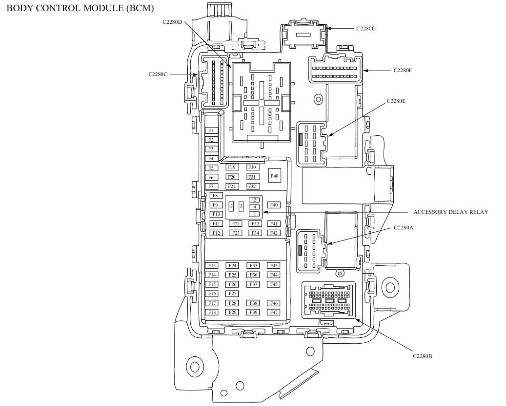

1.) How can I get the blend doors to open; by pulling the fuses? If so what number; # 46 10A?
2.) Where is the fuse panel for this model; Inner or outer to pull fuses?
3.) If I need a actuator, what is the EOM part ID as there are several; right, left and main?
As you can see I have done some research/homework but still need guidance!
Thank you for your time!
Marcie H
Oct 18, 2019 at 1:36 AM
  • 55,423 POSTS

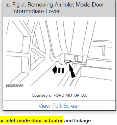

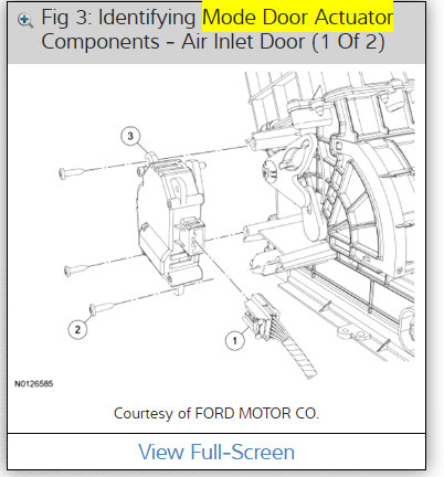

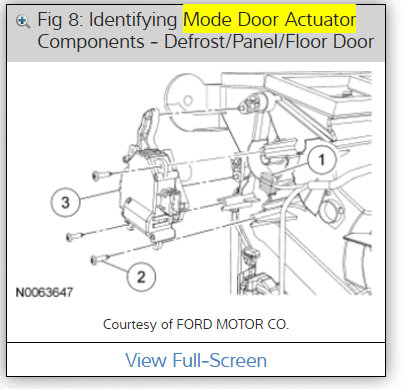

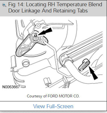

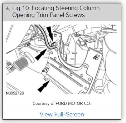

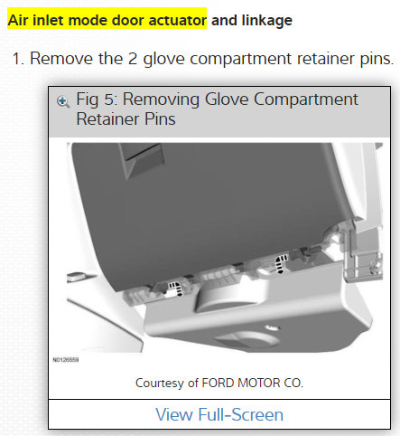

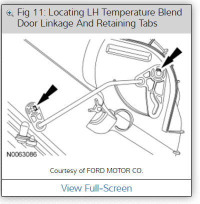

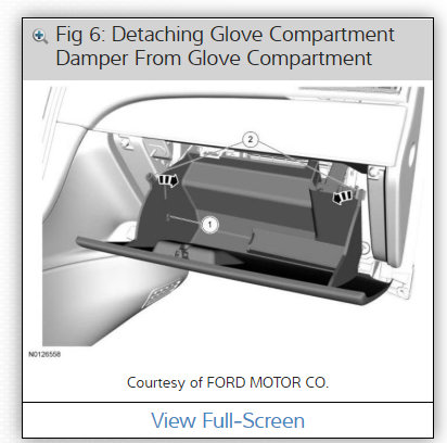

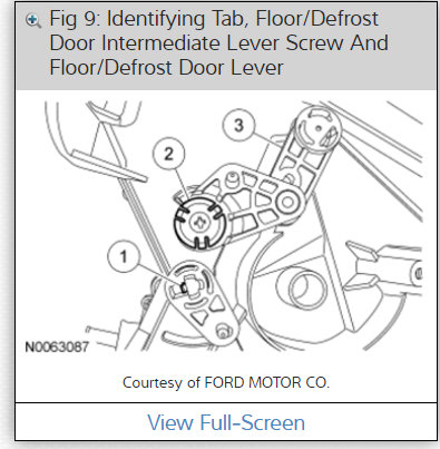

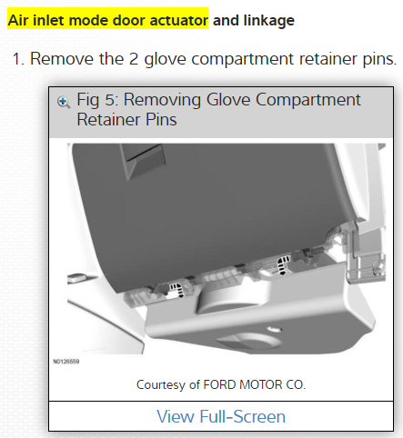

This sounds like you have a blend door actuator that needs to be replaced. here is the fuse panel identifications and locations with the blend door location as well. This guide will walk you through the repair with diagrams below to show you how on your car.
