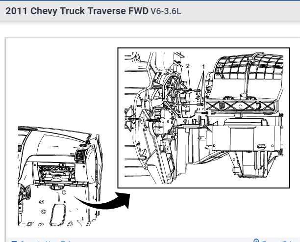

I can turn on the heat and air but it only comes out of the floor vent. Would this be a bad actuator and is there more then one?

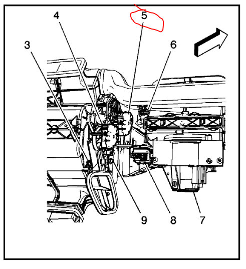

You have the manual system. It sounds like you're having a problem with the blend door actuator.It's a small electric motor that is mounted to your HVAC unit and opens/closes a door to route air through the different air ducts. Here is a tutorial showing what is involved for it's replacement:
I've attached pictures below showing its location. It is number 5 in the first picture. Second picture shows the screws to be removed.Hope this helps and thanks again for using 2CarPros.
