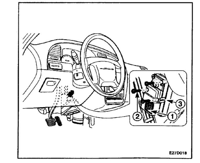

where is blend door located?
Feb 15, 2021 at 11:53 AM
Good afternoon,
I attached the procedure and a picture for you. It is under the left side of the dash on the heater case.
1. Disconnect the negative battery cable.
2. Disconnect the electrical connector.
3. Remove the motor retaining bolts.
4. Slide the Air Mix Door (AMD) motor off the door shaft and remove the AMD motor.
Installation
1. Position the AMD motor onto the door shaft.
2. Install the AMD motor retaining bolts and tighten.
3. Connect the electrical connector.
4. Connect the negative battery cable.
