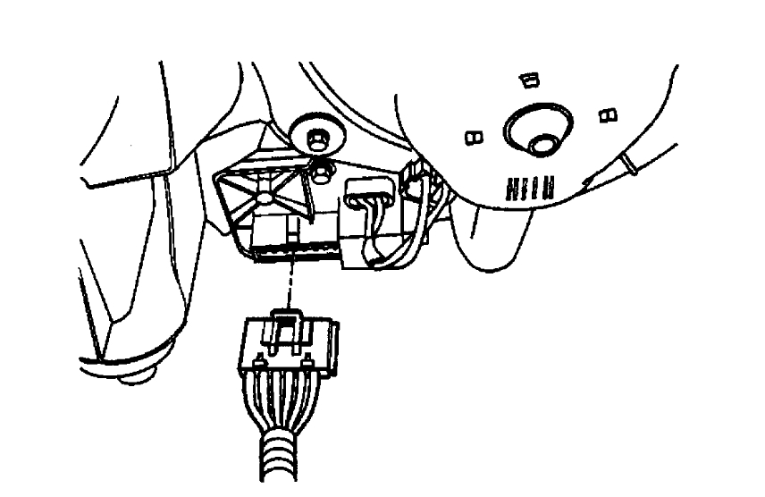

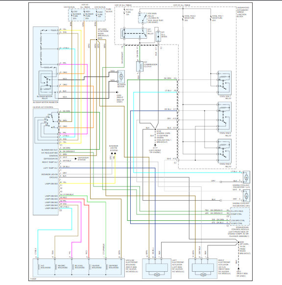

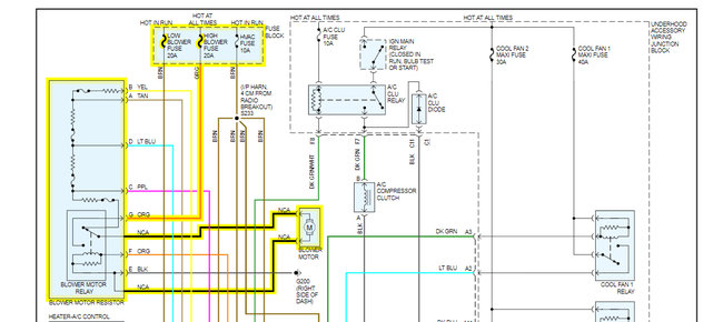

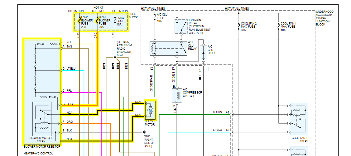

The fan only works on high.
Friday, October 25th, 2019 AT 3:53 PM
  • 52,797 POSTS
Good afternoon,
This sounds like the blower motor resistor. I attached a diagram of the unit for you. Check the 2 fuses listed for power on both sides. Check out the diagrams (Below). Let us know what happens and please upload pictures or videos of the problem.
