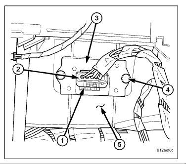

Cannot shut my heat and air conditioning off while car is running.

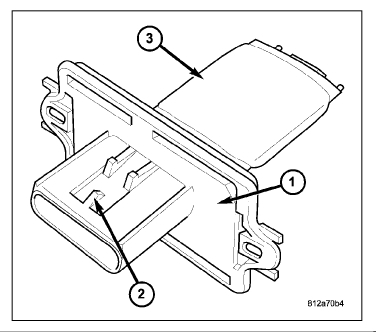

Hi and thanks for using two 2CarPros. Com. Based on your description, there is a good chance the blower motor resister is bad. On these vehicles, power is directed to the blower motor and then using different ground paths, the power goes through the resister at different points causing the fan to speed up or slow down. I have had situations very similar to yours where the resister melted down internally creating a constant path to ground. Therefore, the fan would not turn off.
Here are the directions for removal and replacement specific to your vehicle. There are two pictures attached which correlate to these directions.

Disconnect and isolate the negative battery cable.
Remove the glove box from the instrument panel.
Disengage the wire harness connector locking tab (1) and disconnect the wire harness connector (2) from the blower motor resistor (3).
Remove the two screws (4) that secure the blower motor resistor to the HVAC housing (5).
Remove the blower motor resistor from the HVAC housing.

Position the blower motor resistor (3) into the HVAC housing (5).
Install the two screws (4) that secure the blower motor resistor to the HVAC housing. Tighten the screws to 2 N.M (17 in. Lbs.).
Connect the wire harness connector (2) to the blower motor resistor and engage the wire harness connector locking tab (1).
