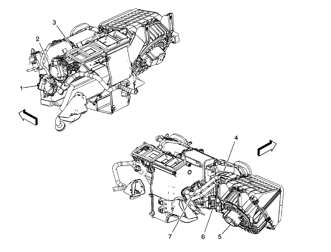

My name is Michael and I have the car listed above. when I turn on my A/C the passenger is cold and the driver blows hot. any ideas? thank you

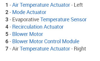

Yes, you have a blend door actuator on the drivers side that needs to be replaced. here is a guide to help walk you through the repair with diagrams below to show you how on your car:
