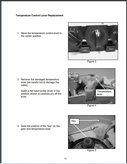

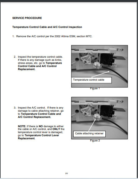

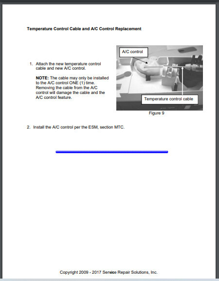

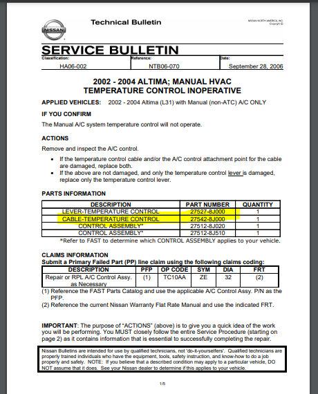

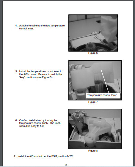

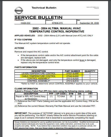

They are correct. I did find one with the controller on eBay and several new ones. I would order it yourself and I can help you install it. See below.
If the price is good and you confirm it fits, you may want to consider going this route. (OEM Part Number 27542-8J000)
https://www.ebay.com/itm/125249564929
https://www.nissanpartsdeal.com/parts/nissan-cable-temperatu~27542-8j000.html
https://www.walmart.com/ip/Genuine-OE-Nissan-Cable-Temperature-Control-27542-8J000/858284495?wmlspartner=wlpa&selectedSellerId=101082610
You can get the cable yourself. Let me know your thoughts. Also, take a look at the technical service bulletin I found. I attached it below.
Let me know if this helps or if I can help in any way.
