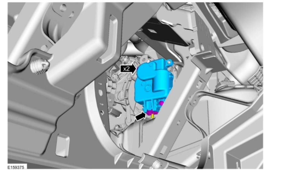

Air will only blow on my feet and out of my defrost vents. The indicator lights still work when I try to blow it on my face but it will only blow from the other two vents. What should I look into to fix this issue? Thanks!

Good morning,
The mode door for this is under the dash on the side of the heater box.
https://www.2carpros.com/articles/air-vents-stay-in-the-defrost-position
I attached the procedure and a picture for you below.
Air Distribution Door Actuator
Base Part Number: 19E616
Removal
NOTE: Removal steps in this procedure may contain installation details.
image WARNING: Before beginning any service procedure in this section, refer to Safety Warnings in section 100-00 General Information. Failure to follow this instruction may result in serious personal injury.
Refer to: Climate Control System Health and Safety Precautions (100-00 General Information, Description and Operation) .
Remove the steering column.
Refer to: Steering Column (211-04 Steering Column, Removal and Installation) .
If equipped, remove the HSWM .
Refer to: Heated Steering Wheel Module (HSWM) (211-05 Steering Wheel and Column Electrical Components, Removal and Installation) .
Disconnect the electrical connector, remove the retainers and the air distribution door actuator.
Installation
To install, reverse the removal procedure.
