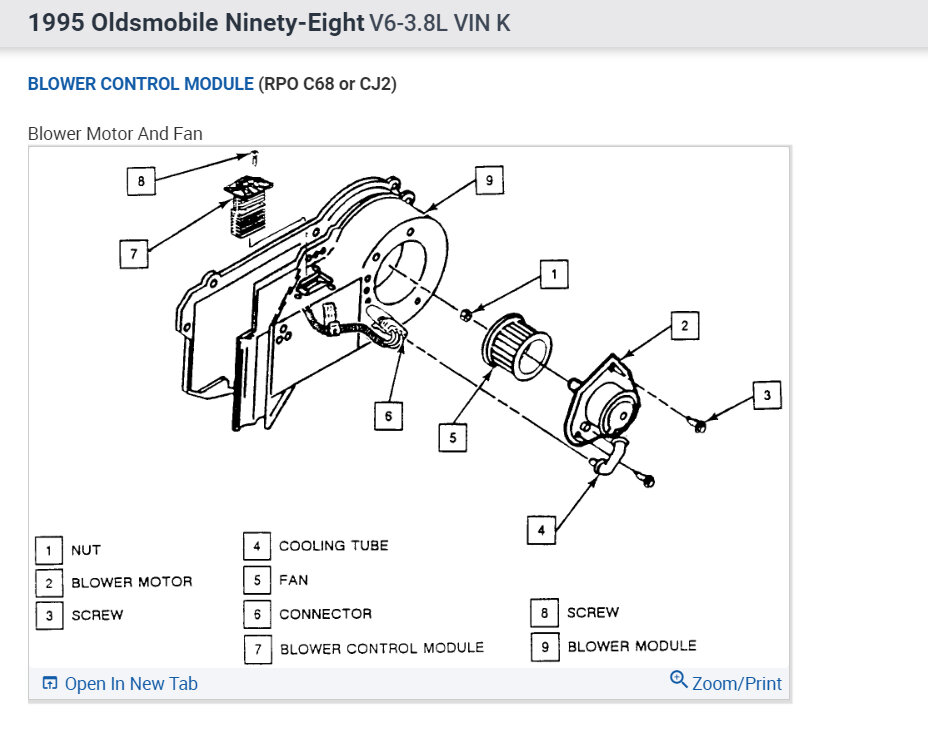

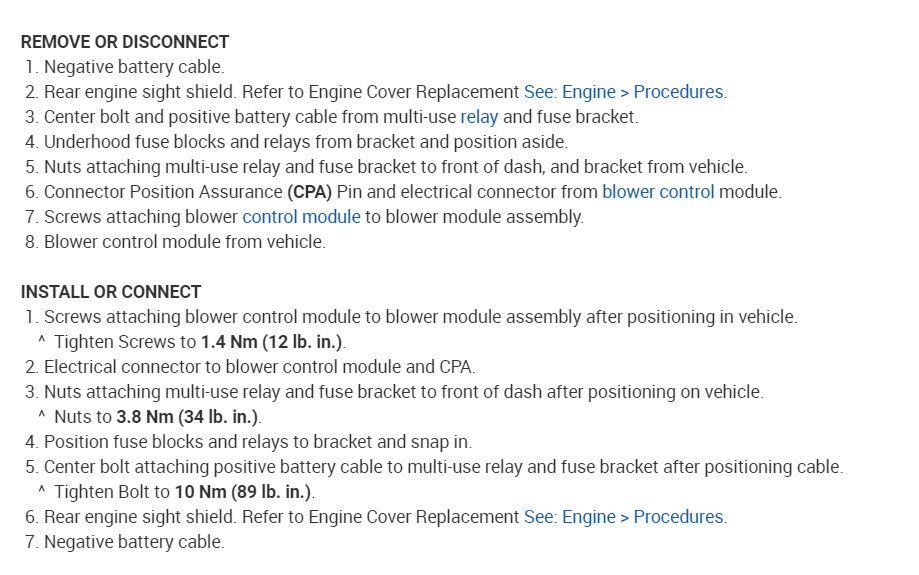

This happens when the blower motor control module goes out here is the location so you can change it out. Check out the images (below). Please let us know what happens.

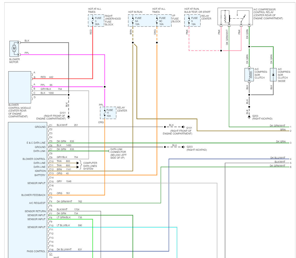

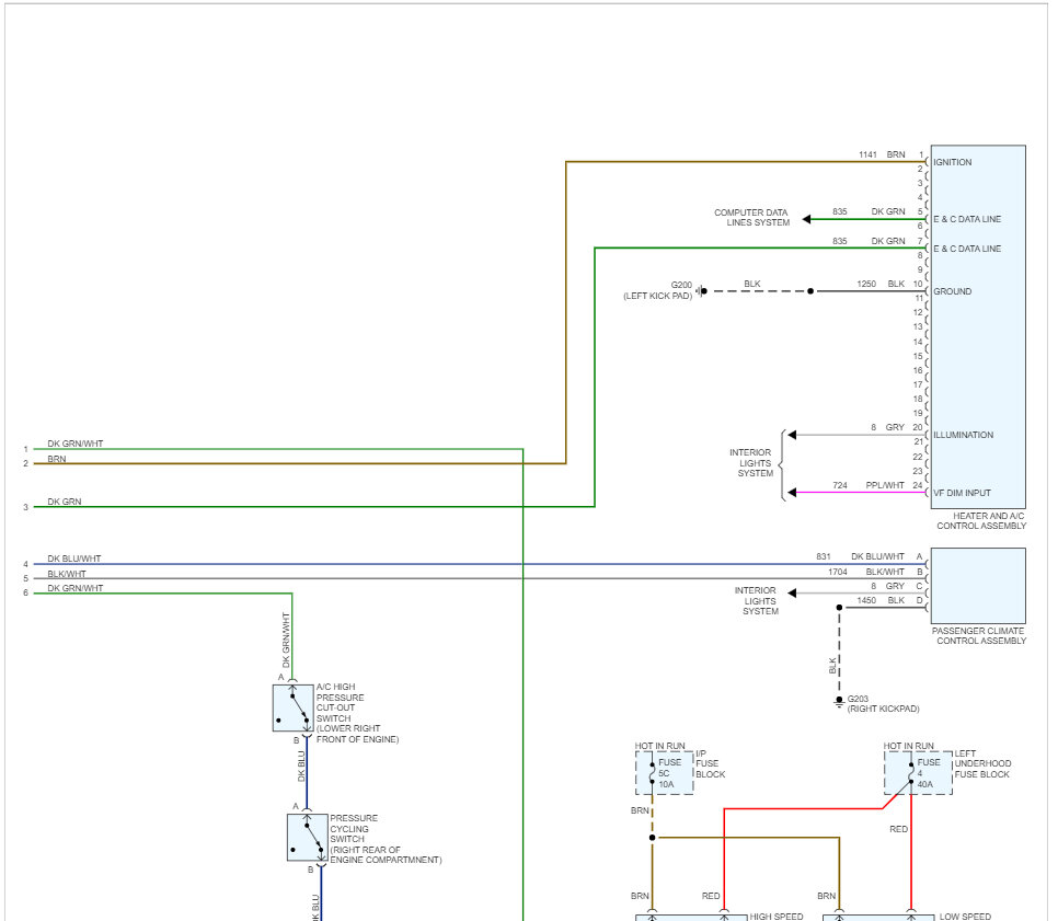

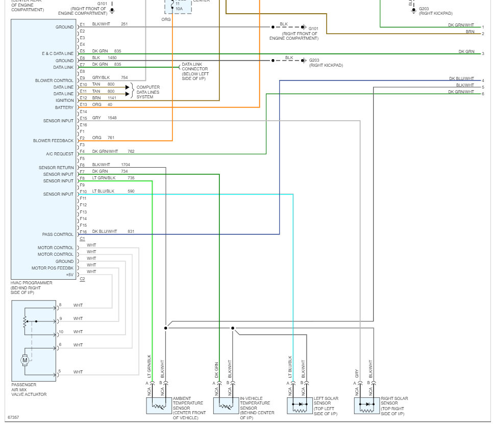

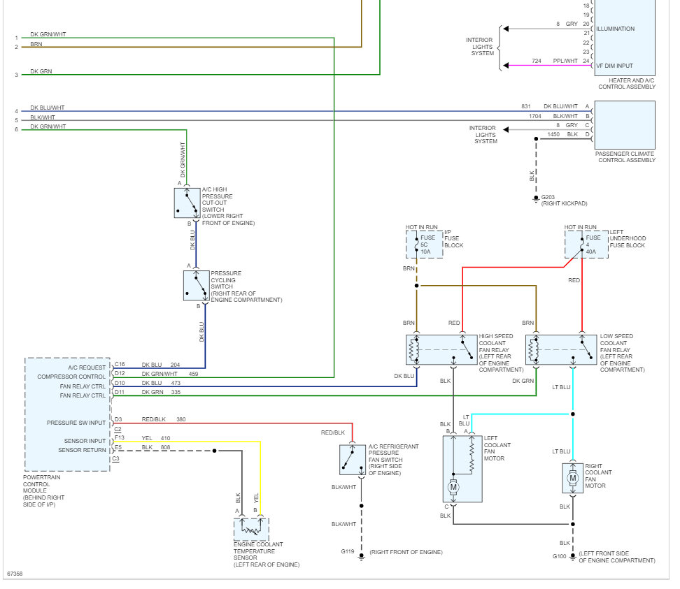

Just to be clear to replaced # 7 in the images above, correct? If so, let's check the system power inputs and grounds, I have included the wiring diagrams so you can see how the system works and a guide to help you with the test. If everything checks out the HVAC control head must be no good. Also check the system fuses #11 in the relay center.
