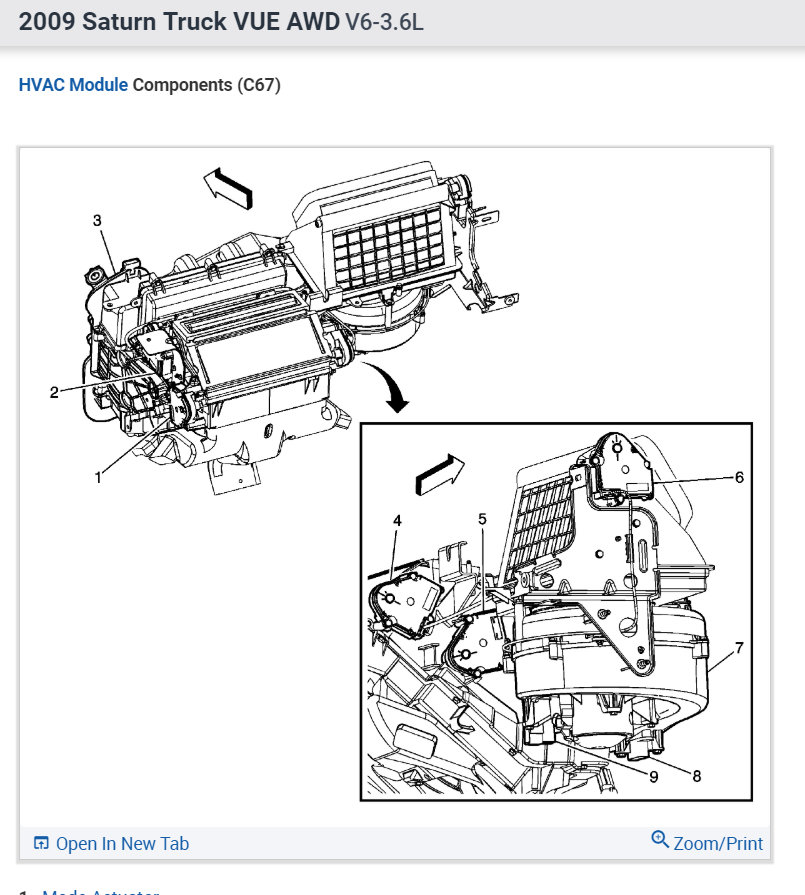

Why does my car blow heat while in drive when the air or heat is not on?
Jun 1, 2019 at 11:23 PM
  • 55,224 POSTS
Hello

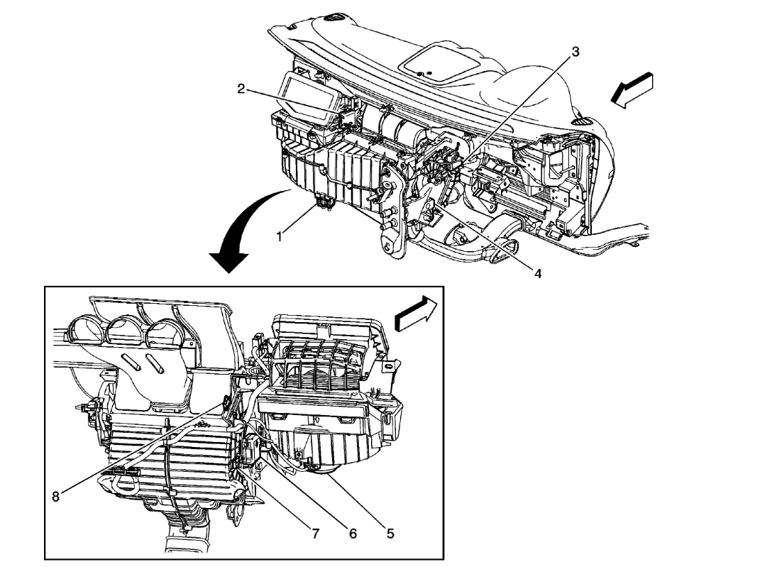

It sounds like you have a re-circulation air blend door actuator that is not working. To confirm lets remove the unit to check the operation. here is a guide that will help walk you through the steps and diagrams below to how you how on your car:
1 - Mode Actuator
2 - Air Plenum
3 - Evaporator Temperature Sensor
4 - Mode Actuator (Side View)
5 - Air Temperature Actuator
6 - Recirculation Actuator
7 - Blower Motor
8 - Blower Module
9 - X202
