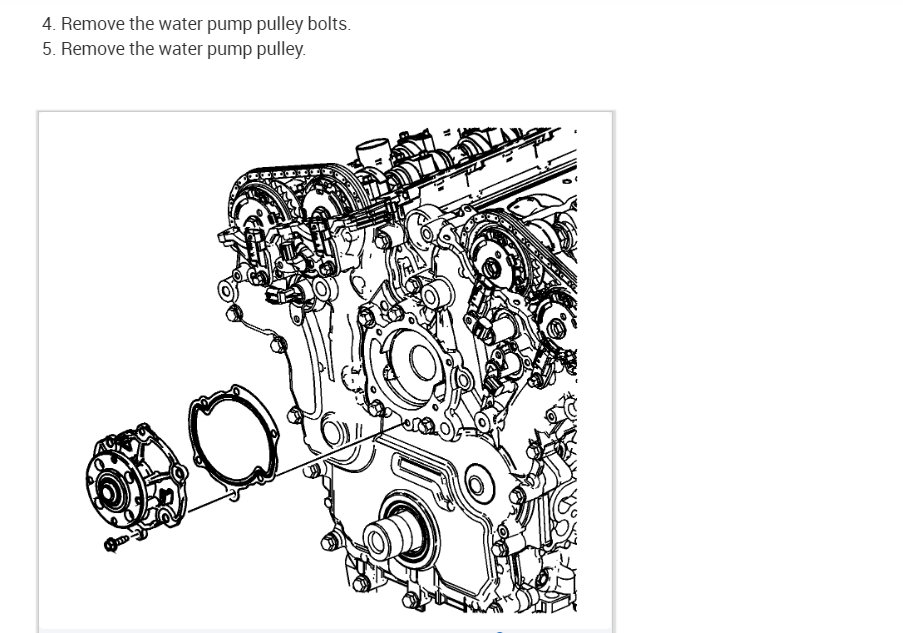

Went out to start it the other day let it warm up turn the knobs to heat came out after 15 minutes and it was freezing cold air. popped the hood checked the fluid level it appeared to be fine. So i drove to work and immediately realized heat worked at acceleration but it would stop at idle.

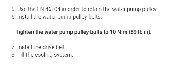

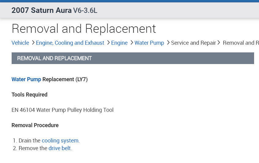

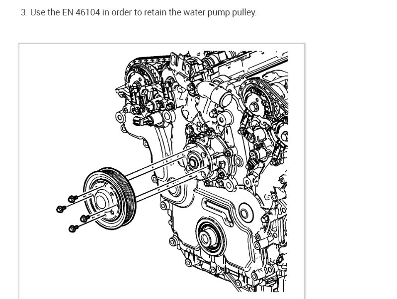

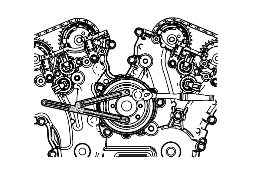

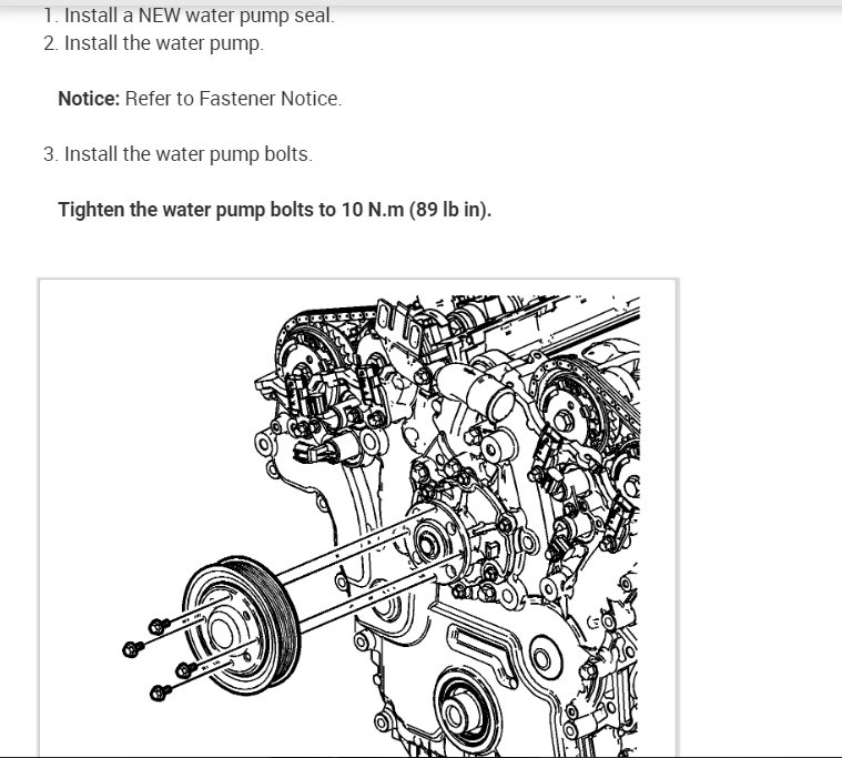

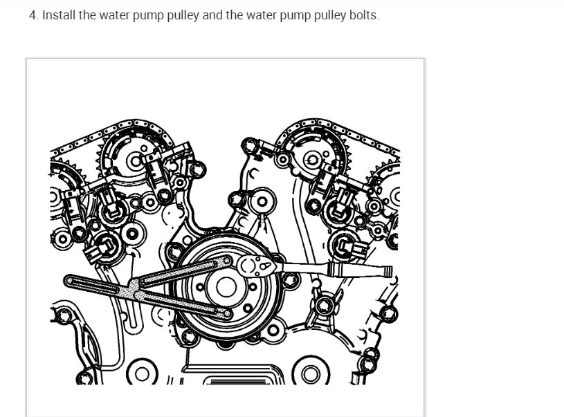

ELI ZUKOKAS
But it does it at idle even after the car has heated up. It will blow heat while driving but soon as i let off the gas it cools down.
Oct 31, 2019 at 6:31 AM
SCGRANTURISMO
  • 4,897 POSTS
Hello again,

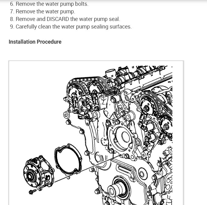

Okay, this sounds like your vehicle's water pump could be going out. In the diagrams down below I have included the instructions for the removal and installation of your vehicle's water pump from the vehicle manufacturer. Please go through these guide and get back to us with how everything turns out.
Thanks,
Alex
2CarPros
