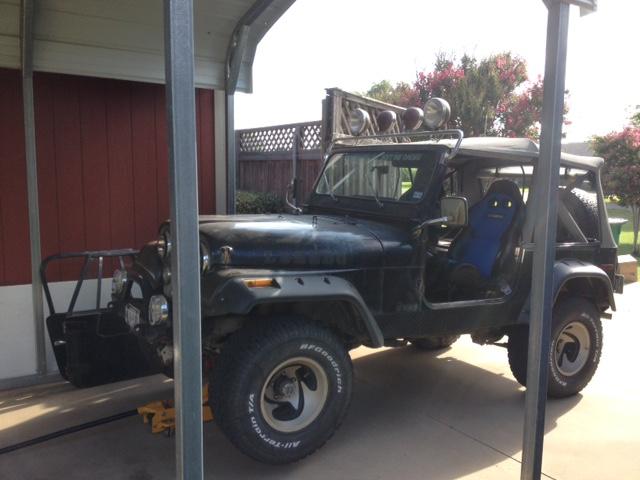

MY PAL HAS A SECURITY SYSTEM THAT WORKS WELL SEE PIC (THIS GUYS SHOULDER'S COME UP TO MY HIPS!) SEE 1st PIC

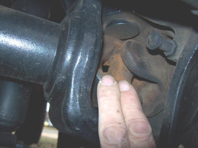

GO TO EACH SIDE AND SEE IF THE U-JOINTS WILL TURN WITH YOUR FINGERS
SEE MY AWESOME PIC 1! YES, THOSE ARE MY REAL STUD-LIKE, BEAT UP FINGERS!
WHILE YOU ARE DOING THAT, MIGHT AS WELL MOVE 'EM BACK AND FORTH JUST A LITTLE SO YOU CAN MAYBE IDENTIFY ANY SLOP IN THE YOKES OF THOSE U-JOINTS.

I WAS SPEAKING OF THE U-JOINTS IN THE MIDDLE OF THE STEERING KNUCKLE
(CHECKING THE FRONT DRIVE SHAFT DIDN'T HURT EITHER)
WHAT ABOUT HUBS UNLOCKED, TURNING THE LEFT AND RIGHT AXLES (AT THE U-JOINTS IN THE KNUCKLES) WITH YOUR FANGERS, WILL THEY TURN, OR IS ONE (OR BOTH) STILL LOCKED TO THE WHEEL?
(TURNING THE FRONT DRIVE SHAFT AIN'T GONNA TELL YOU)

Jeep is up on the jack stands, hubs unlocked. Drivers side steering U-joint doesn't turn with the wheel, conversely wheel doesn't turn when manually turning the steering U-joint. Oddly enough the passenger side steering U-joint turns with the wheel in either direction as well as the wheel turns with the U-joint.

THIS MEANS THAT "MOST" OF YOUR FRONT END STUFF HAS BEEN TURNING (INCLUDING THE DIFF). DEFEATING THE REASON FOR LOCKING THEN IN THE "OFF POSITION" (FRONT END AXLE PARTS WEAR AND FUEL MILEAGE)
GONNA HAVE TO TAKE THE HUB APART, CLEAN IT WITH BRAKE CLEANER/ OTHER
PAY SPECIAL ATTENTION FOR DAMAGES. SPRINGS/ CRACKS OR BREAKAGES/ EVEN A "SMEAR" OR BURR IN A MATTING SURFACE

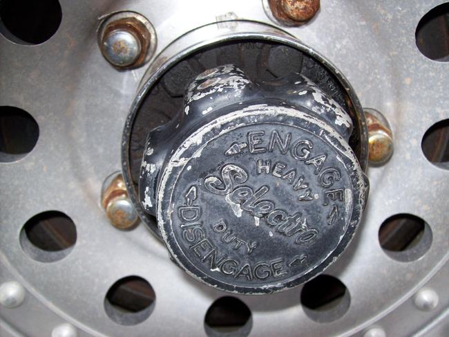

I HAVE INSTALLED SELECTRO HUBS ON MY '77 AND '46 (AND A FEW PREVIOUS OTHER CJ-5s).
MAINLY BECAUSE (WHEN I USED TO SUBJECT MY JEEPS TO HELL DAMAGE) THAT GOOD OLE RED CAROLINA MUD/ CLAY WOULD CAKE UP IN THE FINGER HOLES AND ALSO WOULD SORTA BIND THE PLASTIC WITH THE METAL. WITH THE SELECTRO HUBS, YOU GRAB THE WHOLE BODY AND TURN IT. IF IT MATTERS, THEY STICK OUT A LITTLE MORE THAN THE OTHERS.
