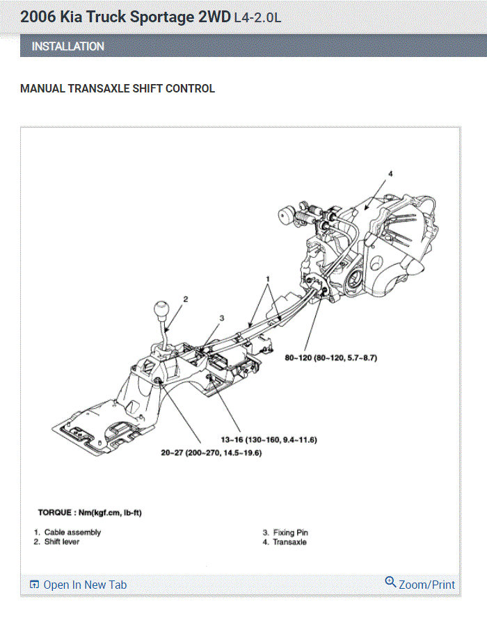

I was driving yesterday when I tried to shift to third and realized the shifter wouldn't go any more to the right than the first and second gear I pulled over, and when I tried to start again, from where first gear usually is I found I was still in 2nd. limped it home took apart the console and found the cable that responds to moving the shifter from left and right wouldn't give anymore cable. that's where I left it. any advice would be helpful.
Jul 14, 2021 at 9:01 AM
  • 110,248 POSTS

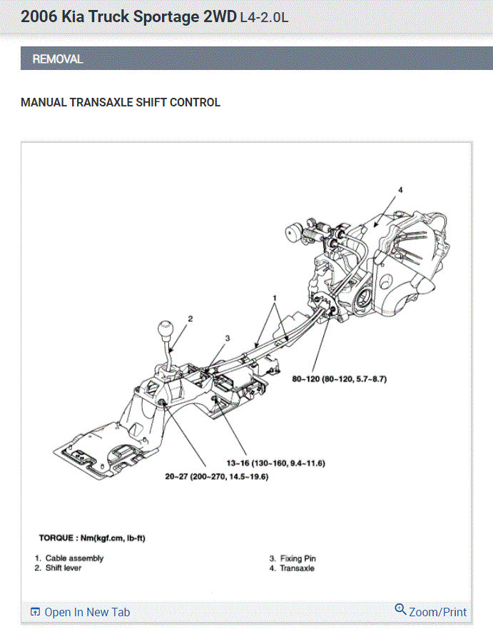

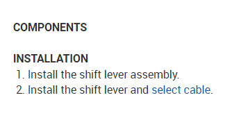

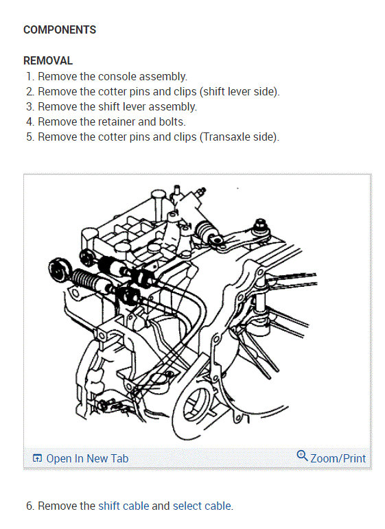

Either we have a problem with a bushing or a broken cable. Inspect where the cables attach with bushings and make sure none are damaged.
If you find it is one of the cables, I attached the directions below showing how to remove and replace them.
