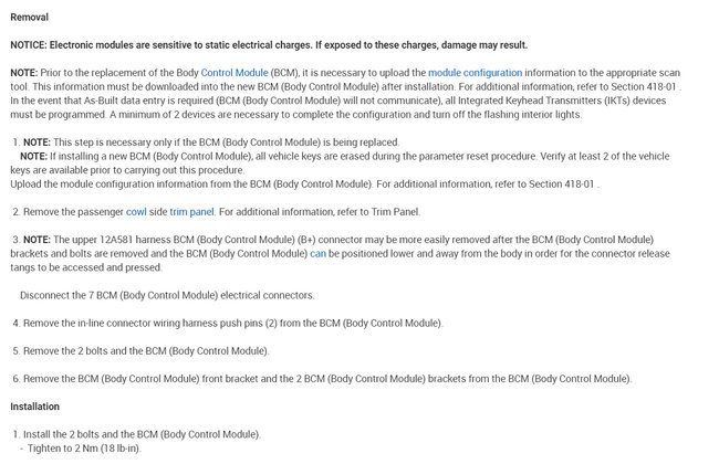

Horn quit working, the camera had become sporadic. today I noticed it wouldn't stay on the selected "back up assistant" or camera, whichever it says. One headlight went out by en the other, though bright lights work. Now the airbag light is on and also "Service advance trac" light. Question is, what electronics is the issue?

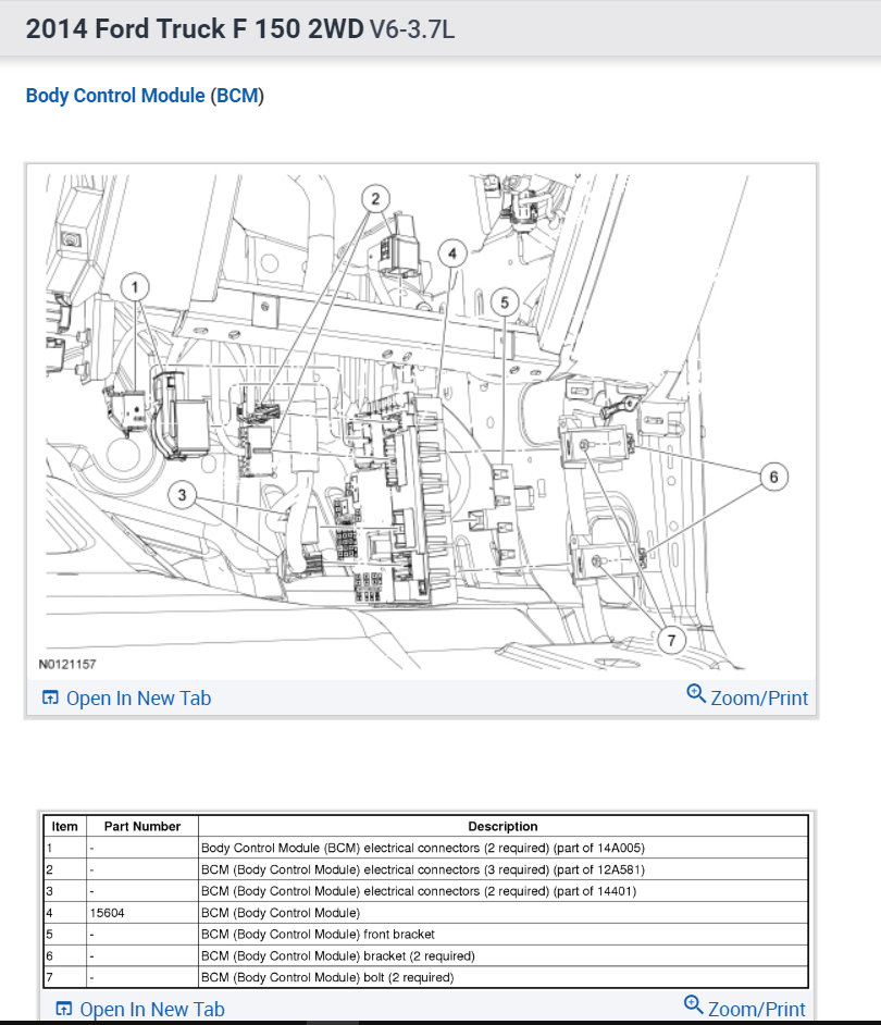

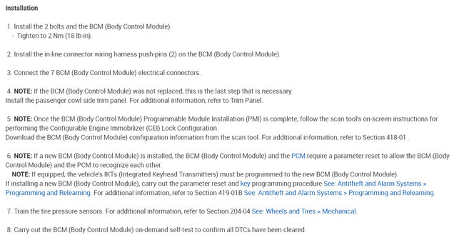

This is common when the BCM is going out. To confirm lets run a CAN scan by watching this video, Also I have included the BCM replacement instruction in the diagrams below.
https://youtu.be/InIlnsjOVFA
Here is a guide to help you step by step with instructions in the diagrams below to show you how on your car:
https://www.2carpros.com/articles/how-to-replace-a-bcm-body-control-module
