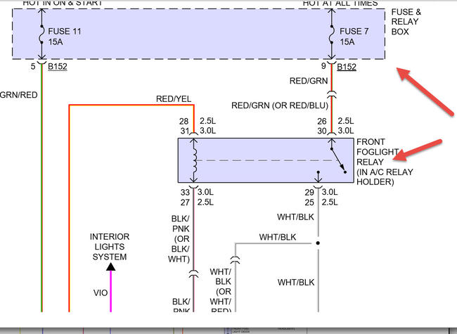

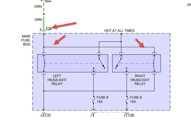

HMAC300
  • 48,601 POSTS
check items in pic for power if no power coming from greenwire then it may be a bad ignition switch or a problem in fuse box if nothing by relays. you may have corrosion in fuse box under hood so you would need dielectric compound on prongs of relay and may move them a tad for better contact.

I don't have fog lights or a drl on my car, so I don't have a fog light or drl relay. I checked the voltage across the female terminals in the fuse box and there was no voltage for them.
I checked the voltage across the right headlight relay and there was 12 to 14 volts in both pairs of terminals, and in the corresponding fuse. The left relay had only 12 volts in one pair of terminals, and no voltage across its corresponding fuse.

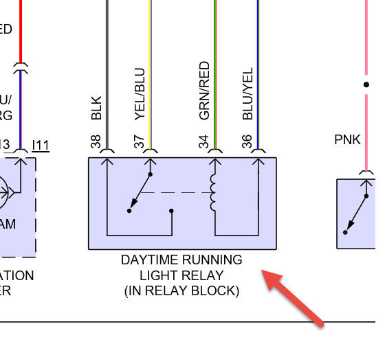

  • 48,601 POSTS
when you turn headlights on does power go to the fuse? or fuse box? if not then it may be a multi function switch or the wires may be broken or chafed and shorting out. is power going to the relays? It cold possibly be the headlight switch as well. are you sure you don't have a drl module on this car our schematics show everyone of the legacys do. it's at center of dash. have this scanned for codes.
