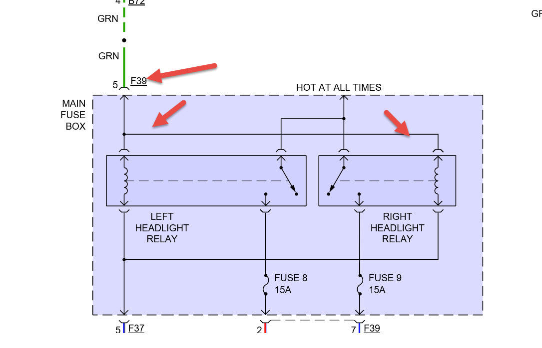

So the headlights on my car have been constantly running for the past month. They would be on as long as the car was on. I would be able to switch between high and low beams, but never could actually turn them off. Last night, they would not turn on. The yellow part of the headlights works, but I cannot turn anything else on. When I switch to high beams, it shows up on the dashboard, but the lights don't actually turn on. I tried to check fuses, but it was dark so I couldn't really see. What would cause the headlights to be stuck in either the on or off position?

Try moving your combination switch to put high beams on if they come on it may be the switch. You can also get it scanned for codes as it may be your drl module bad which the headlights run through. Also see if fuse 8 &9 have power running through them with headlights on that will tell you that the relays are good.

So I checked all the fuses, and all of them look good. While the car was running, I checked the voltage at both of the fuses for the headlights. The left measured 0.2V and the right one was much lower, below 0.1V. I switched the A/C relay with the right headlight relay, but the voltage was the same, and I know the A/C works. My car does not have a drl module. I performed the high beam test you suggested and nothing happened.

Check items in pic for power if no power coming from greenwire then it may be a bad ignition switch or a problem in fuse box if nothing by relays. You may have corrosion in fuse box under hood so you would need dielectric compound on prongs of relay and may move them a tad for better contact.

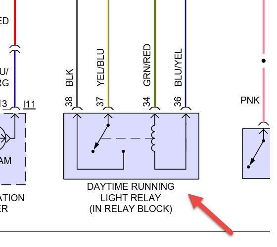

By the way the drl module is daytime light module and that still can be the cause.

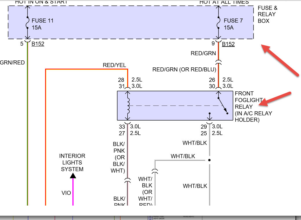

I don't have fog lights or a drl on my car, so I don't have a fog light or drl relay. I checked the voltage across the female terminals in the fuse box and there was no voltage for them.
I checked the voltage across the right headlight relay and there was 12 to 14 volts in both pairs of terminals, and in the corresponding fuse. The left relay had only 12 volts in one pair of terminals, and no voltage across its corresponding fuse.

If no voltage across the fuse then it may be bad or fuse box is bad which in your case I think is the latter that the fuse box isn't transferring power to the fuses so headlights will work. This will need to be physically checked by a pro.

When you turn headlights on does power go to the fuse? Or fuse box? If not then it may be a multi function switch or the wires may be broken or chafed and shorting out. Is power going to the relays? It cold possibly be the headlight switch as well. Are you sure you don't have a drl module on this car our schematics show everyone of the legacys do. It's at center of dash. Have this scanned for codes.
