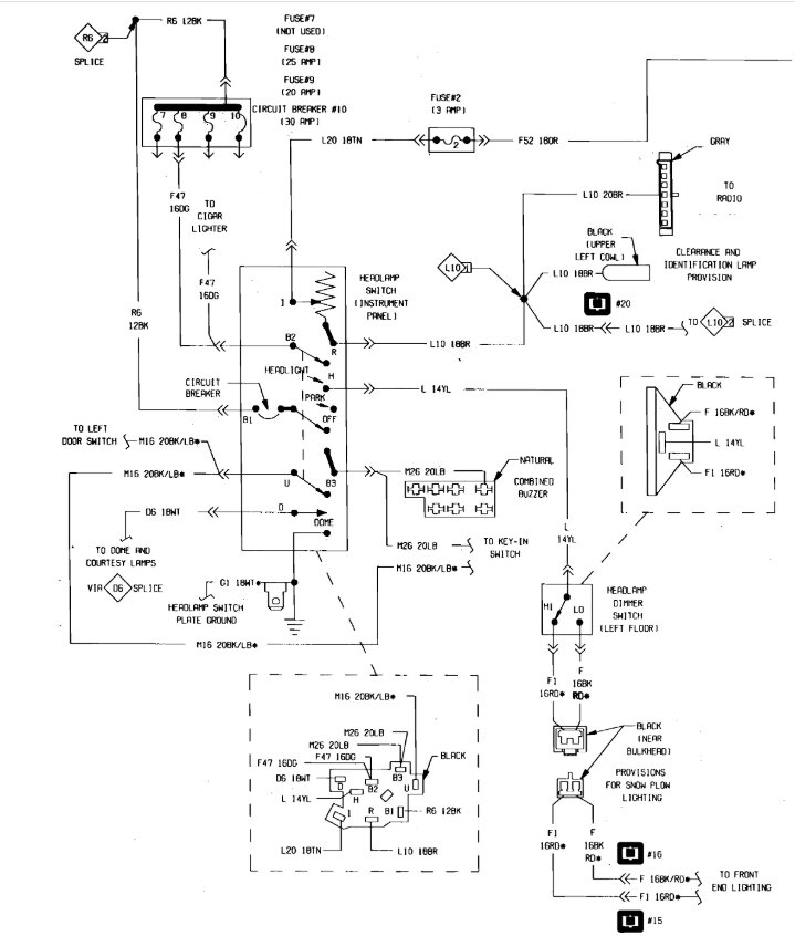

I believe I have done something wrong during the rewiring and possibly didn't get something connected back up properly. I have a 40 Way Bulkhead Disconnect diagram and a chassis electrical system diagram.
In the Bulkhead diagram it says that terminal numbers 16 and 17 go to the headlights and numbers 30 - 34 is for the windshield wipers. However, I have a feeling that the issue is not at the bulkhead terminals. I feel it is a power issue (red wire), simply because the rewiring I did was for the power, or either that it's a grounding issue. Also, the headlights and dimmer switches are brand new.
In the chassis diagram for the left headlight, it shows a G11-10WH wire that goes to ground on the chassis, and a G11A-14WH wire splices to the left headlight connector. Then from there a G11C-18WH wire, which appears to go into the windshield washer motor? And then continues with a V7-18TN wire, but my diagram doesn't go past that tan wire. Where does it go? Does it go into the bulkhead disconnect? Am I even looking at this correctly?

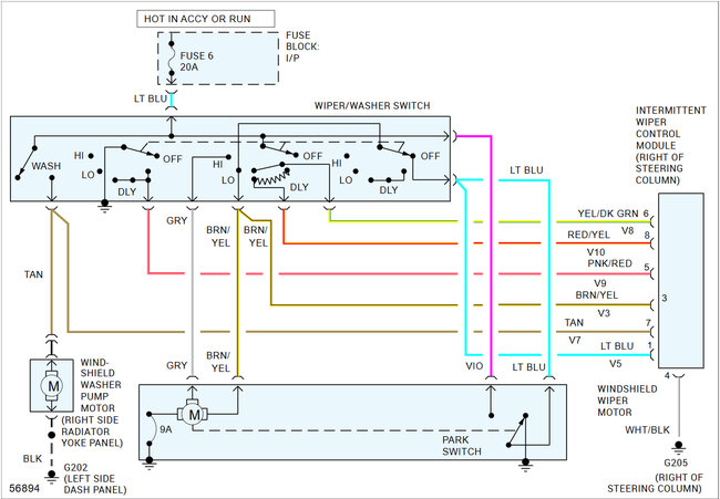

As for the wiper motor, I see that it grounds directly to the body by mounting. It has a V3-BN/YE, V4-18GR, V5-18BL, V6-18PU wire. Do they go directly into the bulkhead disconnect?

Here are the wiring diagrams and a guide to help you with the testing.

Hi guys. I wanted to make a couple of comments once this post got going. The first thing on my mind had to do with the wiper motor. There was a pretty common problem with it being dead due to a bad ground. The big clue was they would start to work intermittently if you tugged up on one of the wiper arms.
The motor is bolted to a steel plate, then that plate is bolted to the cowl, but it sits on three rubber isolators to isolate the vibrations it makes. There's a brass-colored strap riveted to that plate, then the other end goes under the head of one of the mounting bolts to make the ground. Arcing takes place under the bolt head, then the ground connection is lost. That usually starts out with the wipers stopping intermittently in mid-swipe, or they don't turn on at all one time, but do work the next time.
The common fix for that was to just add a new ground wire from the plate to the truck body. The motor's mounting bolts are on the backside of the plate so they're hard to get to, but if you have the assembly out already, it's quick and easy to add the wire under one of them. If the assembly is not removed, I drilled a small hole in the plate, then ran a sheet metal screw in it to attach the wire. On the other end, there's usually some other mounting bolt you can attach the wire to.

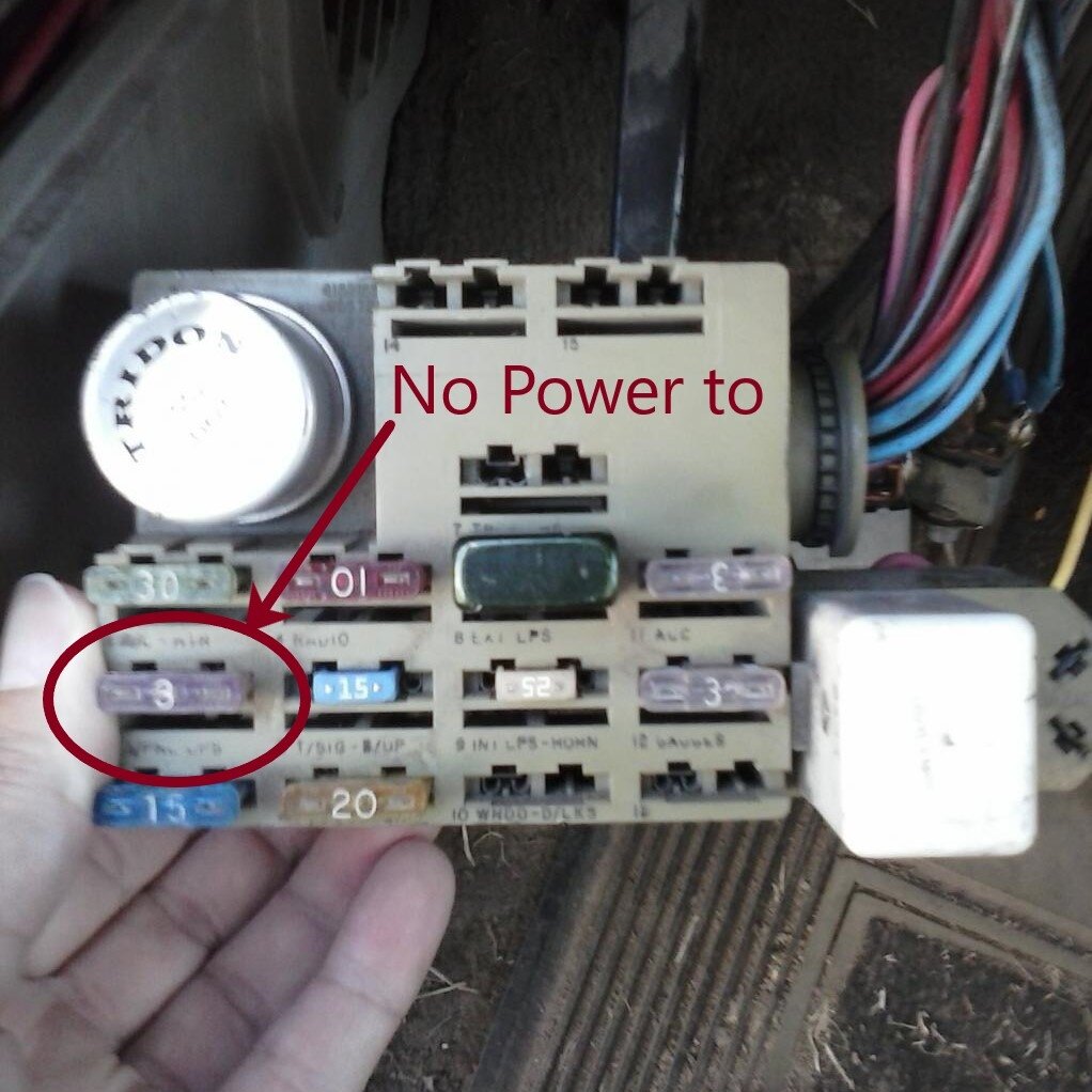

Did power light test on the fuse box. All fuses lit up except one. I'm guessing it's the one that goes to the headlights, but the words are partially worn off under the fuse. A pic is included for reference. Can you confirm if this fuse is to the headlights? I also discovered that the passenger side taillight is out.

Um, I feel kind of silly. I been tracing my headlight issue to my fuse box, but that was a dead end because the fuse box doesn't have a fuse for the headlights. The headlights have a fusible link. I still need to know what that circled fuse goes to though. However, I traced the power wire from the driver side headlight to the bulkhead, and the whole wire is hard, and the insulation is cracked. So, I guess I'll be replacing that. Also, I get continuity through the wire, but no voltage at the headlight connector.
