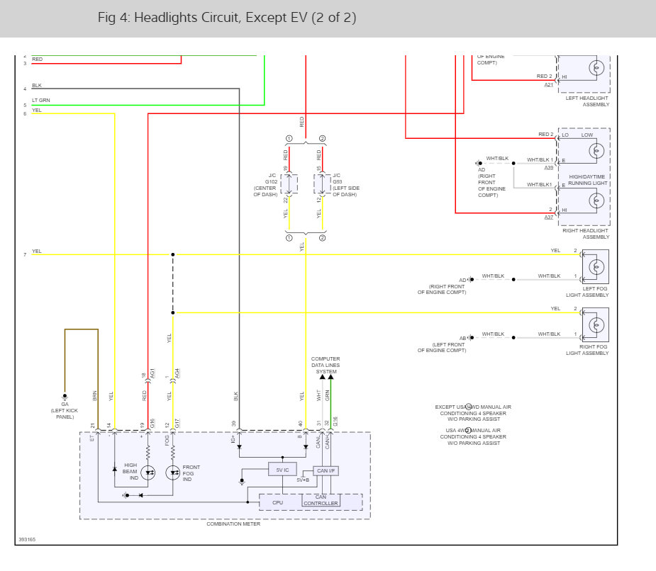

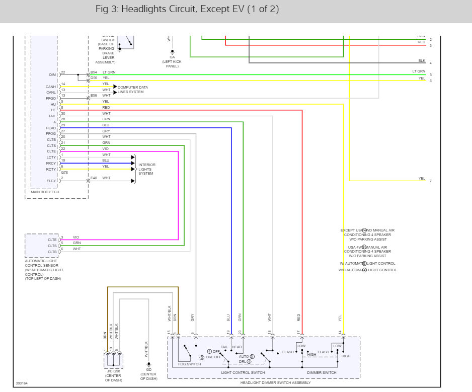

My headlights have stopped working. My high beams work. My left headlight will pop back on temporarily when I let the hood slam shut, but will stop working again after a few minutes.
Any ideas?

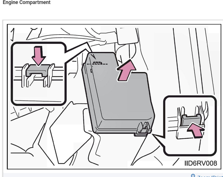

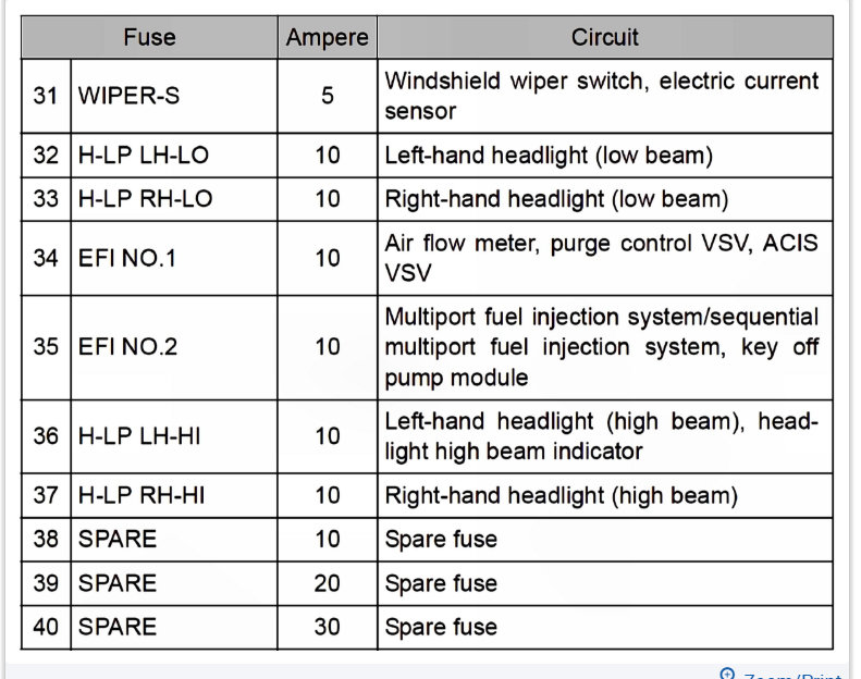

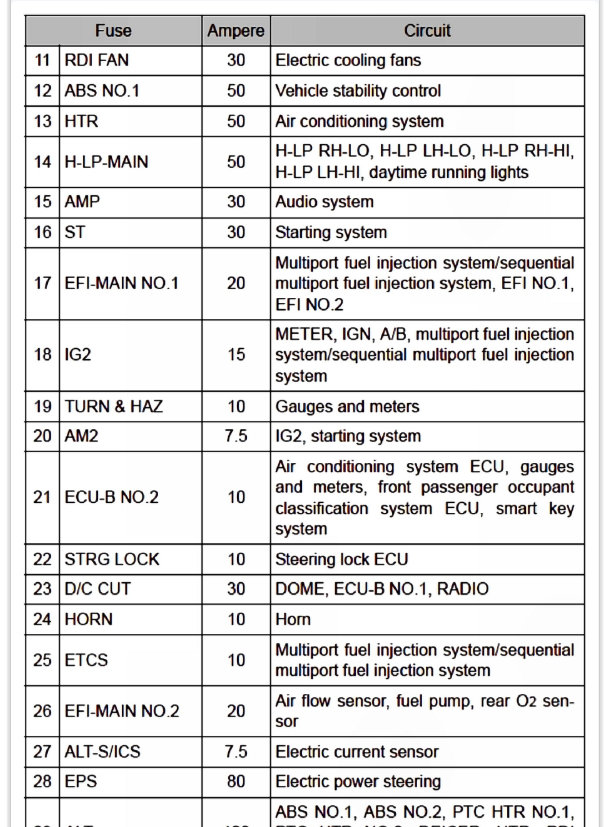

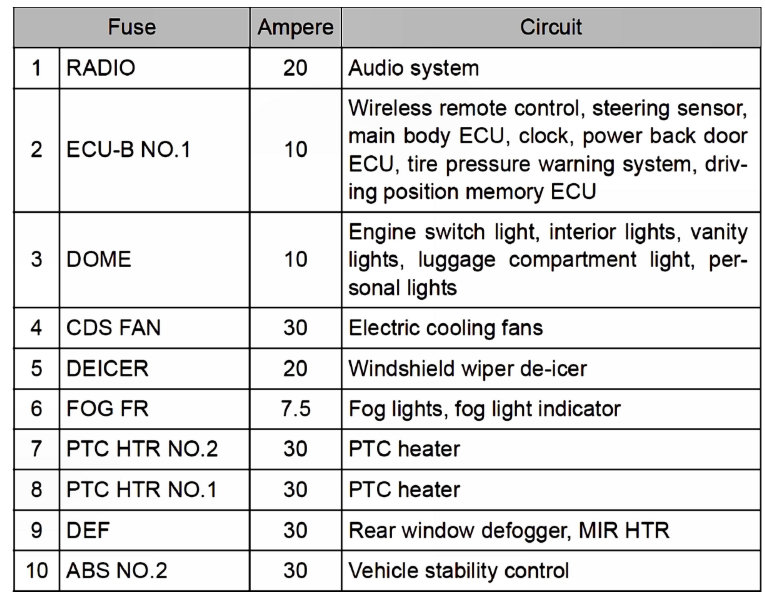

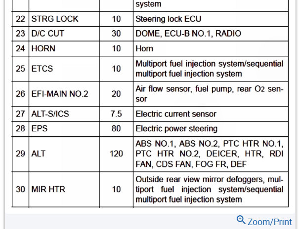

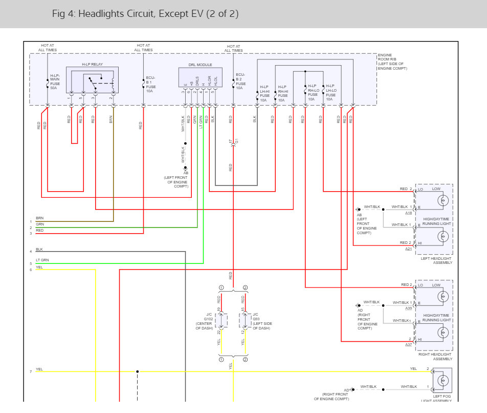

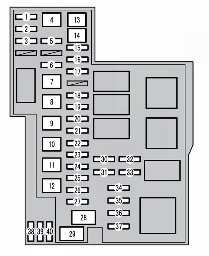

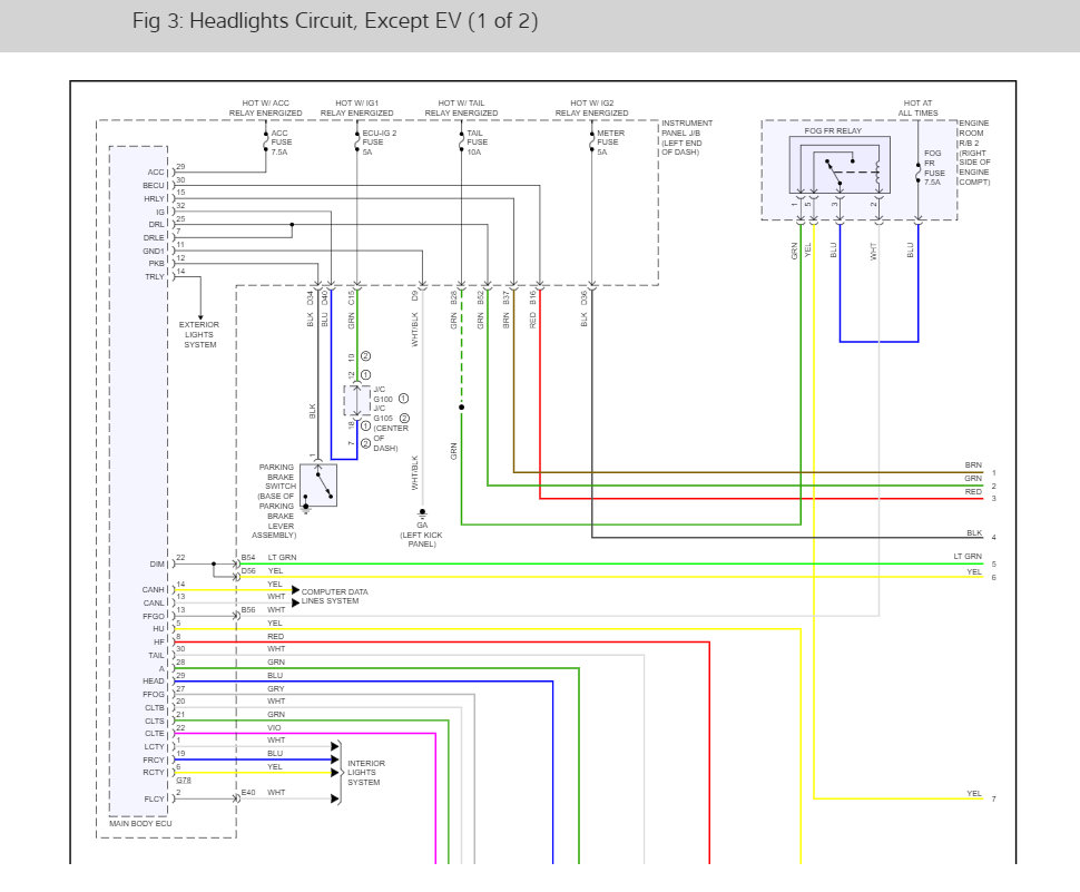

It sounds like the headlight relay is no good. To be sure lets check the relay using this guide and I have the highlighted relay location and wiring diagrams below so you can see how the system works.

It sounds like you may faulty headlamp bulbs, This is were I would start, Access the headlamp bulbs I sent you a link below on how to replace headlamp bulbs. Check for 12 volts at the bulb connectors for both low beams and high beams, If you have 12 volts across the circuit replace the bulbs. Ken sent you wiring diagrams for you to find the right wires to check. Please let us know what you found.
