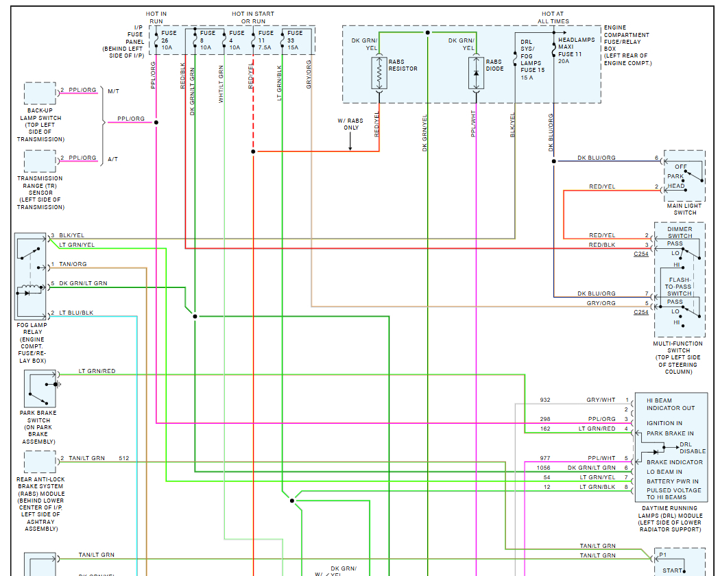

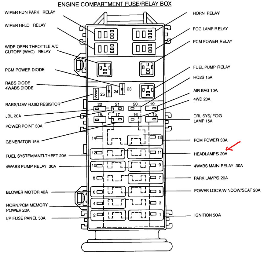

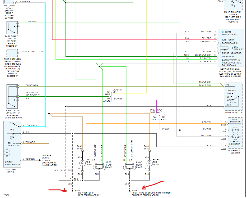

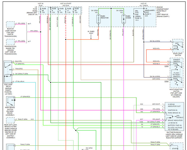

Changed a temperature sensor didn't touch anything else pulled it out of the garage headlights didn't come on. All the other lights work but no high or low beams, but the high beam indicator stays on.
Jan 17, 2025 at 10:03 AM
  • 55,423 POSTS
It sounds like a system ground is off or bad. Also, there are a hand full of fuses that run the system which I have included in the headlight wiring diagrams below. Here is a guide to help you check the fuses and I marked the headlight system grounds in the wiring diagrams as well.
Check out the images (below). Please upload pictures or videos in your response of any problems so we can see what to help you with.
